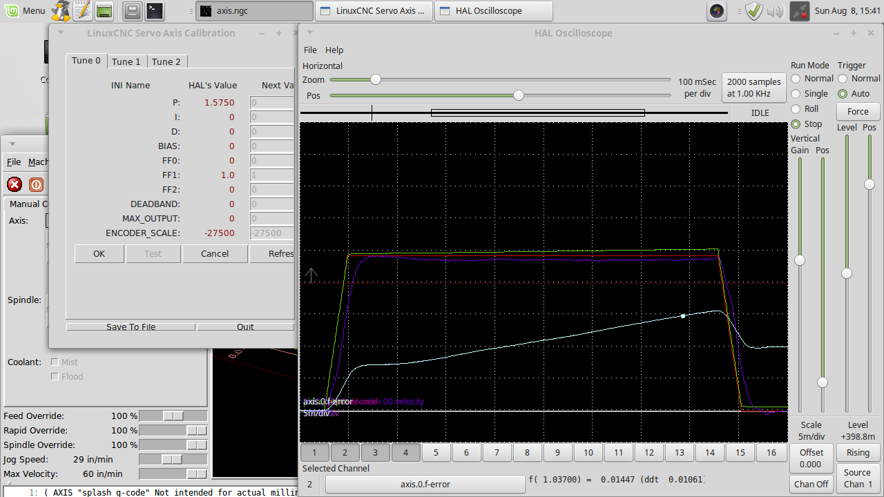

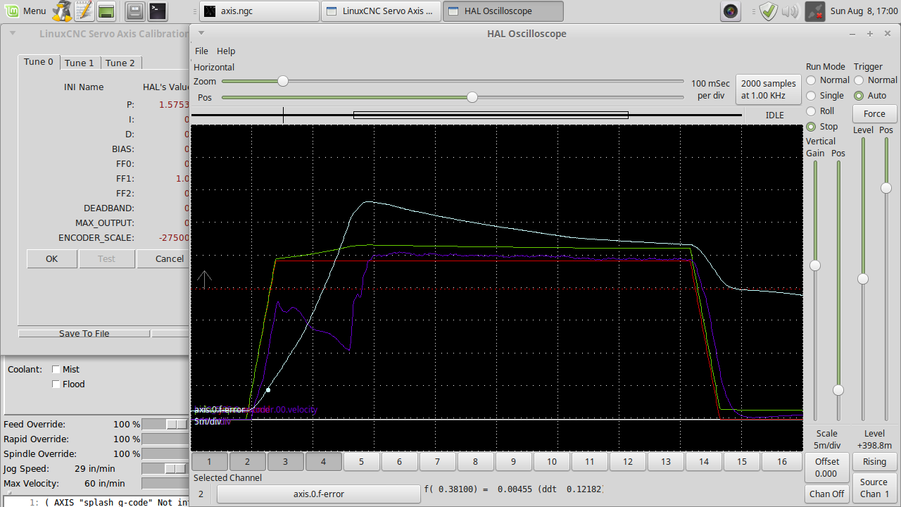

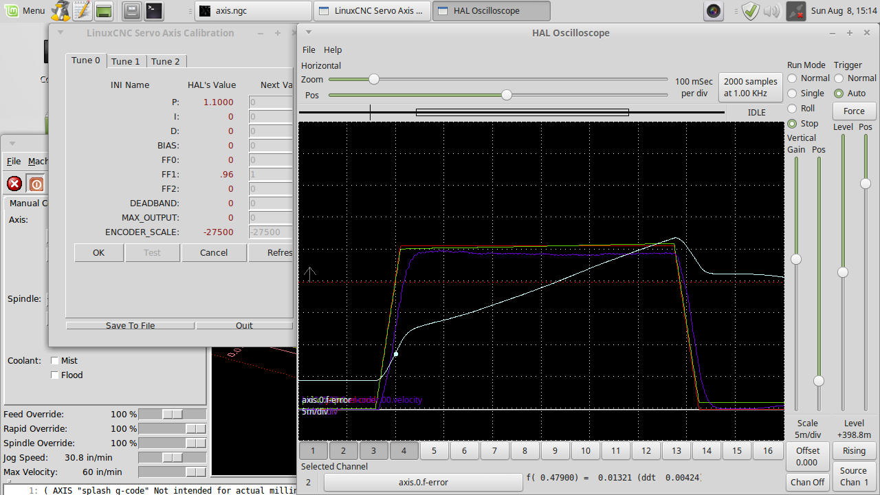

Todd, thank you! Attached are just 2 pic of the trace, notice the f-error units (in white) are different 5m/div than others at 100/div. I am going to need to study all the pic I have to understand how I am doing with tuning. Does the traces attached appear moving in the correct direction to you? Notice 1 of pics I adjusted FF1 from 1.0 to .96. How much can FF1 tolerate from 1.0? Feed rate is tweaked also. Read the file name closely, pot2 is back to 11.5 in some, because the motor had some vibrations that would not go away.
Many thanks!

Because F-error is not in units of velocity (it is units of position) and the fact that you're not really comparing it to the other traces, it's gain scale in Halscope is mostly irrelevant, other than knowing it to calculate what the actual following error is. In your first image the peak f-error is about 0.027" in the 2nd its a bit more than 0.015". So getting better. Keep adding P until you start to see instability, then back off a bit.

What the PID in Linuxcnc does is look at the feedback from the encoder and adjusts the velocity command to the servo drive to try to minimize the following error. The P term adds a value to the velocity command proportional to the size of the following error. So as the error grows the amount added increases. Increasing P should decrease the following error at all speeds, until it becomes large enough to cause instability. But the amount of the effect may be different at different speeds or unstable at one speed and not another.
The FF1 term adds a value to the command proportional to the commanded velocity, so if set to =1 it will add the amount of the velocity command. (This is why when FF1=1 and all other PID terms are zero, it simply passes the velocity command through open loop.)

PS: The problem is because of your drives jerk problem at higher commanded speeds, If P sees too large of an error it could cause a velocity command to the drive large enough to trigger the jerk problem. Then every thing may fall apart.

Todd, this pic is on the verge of the motor starting to jerk. How much should I be thinking about backing off of "P"? P is not so large of a number.
