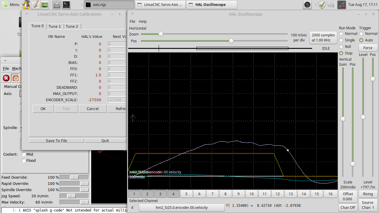

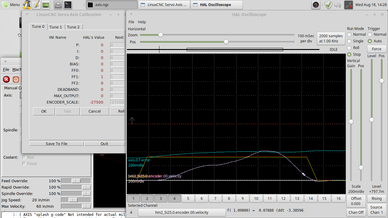

Todd, thanks for all your help, especially the SW2 vs SW3 clarification. I have many pics of the ways I have tuned Pot1 & Pot3 to each SW2 setting, but only attached 1. The file name is the settings, example: s.047in7p1 10.0p2 3.0p3 9.0 fd20.png is sw2=.047,ini(file) set to 7, pot1=10.0, pot2=3.0, pot3= 9.0, feed 20"/min. Be careful of units, units in each pic, uses same units unless 1 trace needed different scale, then it's white, so you can read scale from pic. The motor has not jerked. I am not seeing the pattern.
Many thanks!
Many thanks!
Last edit: 10 Jul 2022 19:02 by new2linux.

Those are pretty much universally awful. Did you switch the drive from velocity command to current?

Todd, Good morning, thank you for all the help. I have ponder what I may have set up or wired improper. The A-M-C power supply was a flying lead style, so the capacitor has 2 screws (marked +-) with short length of wire that I think would go to a buss bar type connector, so you can supply power to many drives. I have crimped & soldered 2 (1 for x & 1 for y axes) sold copper 14 wire using a crimp on style of terminal and screwed under each screw in the capacitor. Does this sound ok?
When I started tiring to tune, I had a ground wire off the drives & if seemed that if you hold one motor shaft (each motor spins at varying slow speed) the other motor would spin faster if applied friction to first motor.
This morning, I have rechecked all wires going in the back of plugs to be shore all is secure.
I am planning to start at the beginning, all factory settings. It seemed Pot1 wanted to be around 10 to 10.5 turn, no matter what SW2 setting. I would of thought that a better rated power supply would bring this down to 7 or lower, because of the better match. Pot3 seemed to like 7 to 10 turns, this pot3 CCW brings the purple trace down.
Today I will try with FF1 =1.0, and work back through the settings again.
Many thanks
Edit: No I have not switched to current command, all SW1=off (1 to6).
Many thanks
Last edit: 11 Jul 2022 13:15 by new2linux.

Todd, thanks! I have the proper settings for velocity mode, SW1- 1 & 3=off. This morning starting with sw2 & sw3 all factory setting, Pot 1 going CW until motor makes faint noise, then CCW 3 = 9turns. Pot3 started low, went CW until purple trace was close to the red trace, this is 6.25 turns. In the pic, 6.5 turns has the purple trace higher in relation to to red trace. This is what is required to set pot3, correct? Get purple trace to track red trace as close as possible, while FF1 is 1.0?
When I go higher on pot3 the Y axes motor (is off the machine) wants to turn faster, I use pot4 (y axes) to slow it, but you always over shoot & motor goes opposite direction, so I just shoot for slow. It seems if you change pot3 very much, you need to re-visit pot4 to slow y axes motor each time.
Many thanks
Many thanks

Replied by Todd Zuercher on topic Set up using AMC AB15A100 drives, brushed DC motor Prototrak Plus with Encoders
Current loop is tuned with the motor off of the machine. Since we aren't trying to tune the current loop (Because you don't have an o-scope.) We're hoping the default current loop settings are sufficient.
Pretty sure to get any meaningful tuning of the velocity loop done the motor needs to be installed on the machine.

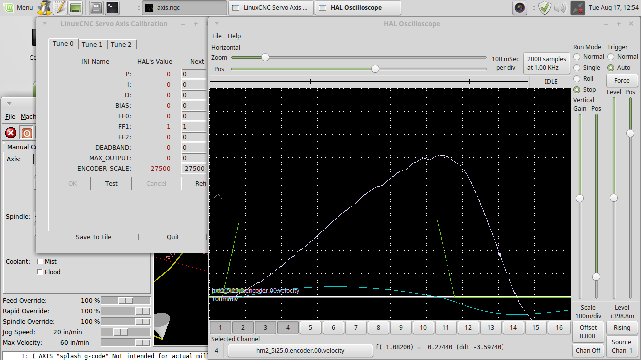

At this point the velocity rise of the motor in the traces you've shown since changing the power supply is much much too slow to be remotely close to useful. But it is possible that if you have the motor off the machine you have to have pot 1 set so low to keep it quiet that the response becomes that slow.

Todd, thanks! If I raise pot1 (the pic is 10.5) any more, when I push arrow key to start x axes moving, the Y axes (motor on the machine now) will start to oscillate (like .5 turn of machine handle) until F2 (joint error out) is up.
If Y axes oscillates very much (I will use pot4 on Y axes) to slow or stop motion, it usually will just get slow oscillations. To get best trace y axes, needs to be stopped when I push the arrow key to trigger trace.
thanks
thanks
