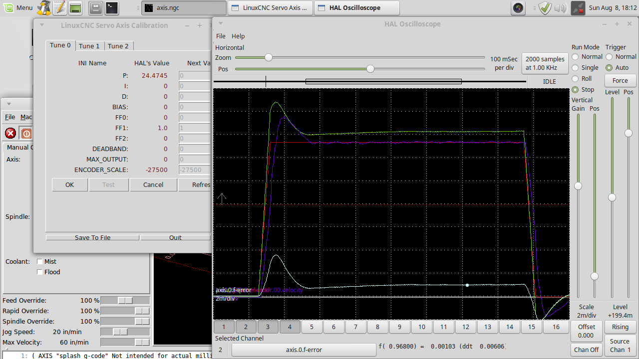

01 Jul 2022 17:54 - 01 Jul 2022 17:56 #246387
by new2linux
Replied by new2linux on topic Set up using AMC AB15A100 drives, brushed DC motor Prototrak Plus with Encoders
Todd, thank you for all your guidance!! The attached trace is with P=24.4745, this is as high as it will go with feed set to 20 ipm. I tried to set feed to next increment 22 ipm, but only motor jerk resulted. File name seta=pot1 11.562; pot2 11.5; pot3 3.312; uf 1.517 Units: all50M/div except f error as shown in trace = 5m/div.
Many thanks!!
Many thanks!!

01 Jul 2022 19:05 #246391
Replied by Todd Zuercher on topic Set up using AMC AB15A100 drives, brushed DC motor Prototrak Plus with Encoders
Try changing the max acceleration setting in your ini file from10 to 7 and see what happens. You will have to shut down and restart Linuxcnc after making such a change to your ini file for the change to take effect.

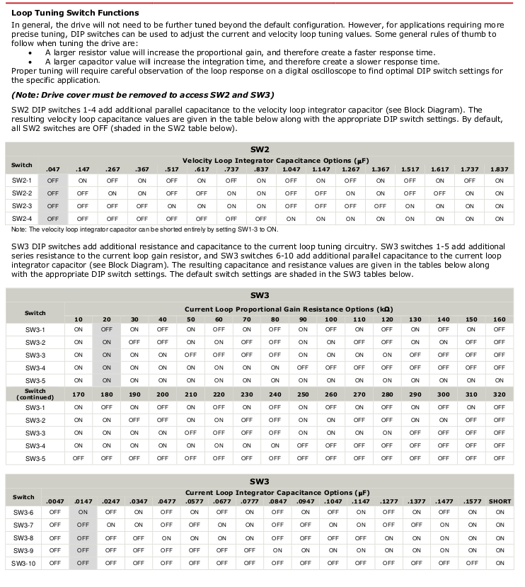

08 Jul 2022 16:45 - 08 Jul 2022 18:38 #246882
by new2linux
Todd, thanks you! When I talk about motor comes around, if low Pot3 setting, motor does not seem to want to run at all when arrow key is used & too much & motor drifts quickly, Pot 4 will change direction of motor but usually over shoot adjustment & motor wants to run other direction.
many thanks
Edit: Please review my prior post about oscillation, upon push F2 down.
For example SW3-1=ON;2=OFF;3=ON;4=OFF;5=ON; is not available. See attached pic of table.
Edit: I have re-edit the .ini file back to 10.0 from 7.0.
Edit: I have swap the drives, I plan to re-tune to motor to this drive. This is from my earlier post:
"After checking & re-check, it appears something is going on with "X" axes, at the drive, I have swapped motors, same thing happens, the motor will oscillate just as soon as F2 is released, I have feed rate at lowest and still motor turns quickly about 5 turns (hard to tell) & reverses direction does the same, the joint error will appear or use F2 to stop. I measured voltage at the power supply 74.9 VDC, checked the small transformers, reads 5 & 24 VDC. I am so disappointed with myself, the tuning was going ok & then could not figure out what has occurred. Only thing I can come up with is as you study SW3-1 TO 5 options (every option is used) you see 2x as many as the SW3-6 to 10 (some options are not used), and maybe I used settings that were not available. This is only thing I can come up with as why & what was I doing.
I believe Pot3 by going from 5or6 to 4.0ccw has reduced the oscillation some. I pray this is just a tuning issue.
Many, many thanks
many thanks
Many, many thanks
Last edit: 08 Jul 2022 18:38 by new2linux.
- Todd Zuercher
- Posts: 4785
- Thank you received: 1476
08 Jul 2022 18:35 #246892
You may have to put all of the switches back to their factory defaults, then do the base tuning for pot1 and pot3, and start over from the beginning tuning the velocity loop in the drive (Linuxcnc open loop with FF1=1 and all other PID settings =0.) The settings you found that worked before may need to be very different since the voltage and currents the drive sends the motor will be different than before.
I don't understand what do you mean by "For example SW3-1=ON;2=OFF;3=ON;4=OFF;5=ON; is not available."? Why wouldn't it be available? It's the 11th column 110kOhms.
At this point I think I'd leave the SW3 switches in their factory default positions 1=off, 2-5 on and 7=on, 8-10 off.
Then after tuning the SW2 switches and the pots, if you still can't get good results, we could try some things with SW3-7-10 (leave 1-6 in their default setting). I would not recommend blindly trying things with SW3 switches 1-6 without looking at the motor current feedback with an o-scope.
