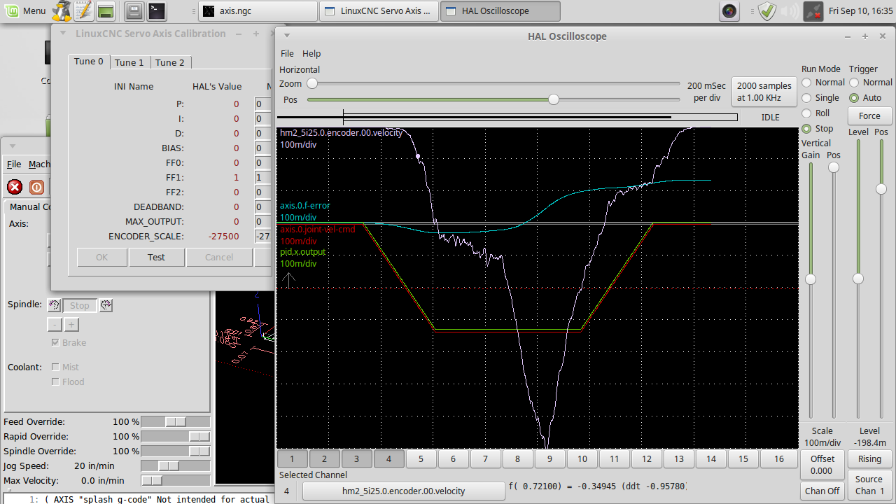

Looking much better, even the 60ipm jog doesn't look too bad.
Once you are satisfied that it is as good as you can get it. I think you should be able to proceed with trying to tune the the PID loop in Linuxcnc.
You might also be able to experiment with increasing the acceleration, to see if the acceleration limit has improved with better tuning. But stick with making one change at a time. So you can see what effect your change has made. For example if you try increasing the acceleration before tuning the PID in Linuxcnc, you will need to watch for the acceleration limit causing the slope of the encoder velocity trace not match the open loop commanded velocity's slope. If you test this after tuning the PID in Linuxcnc, you will need to watch out for a spike in following error combined with saturation of the PID output (commanding a full 10v to the drive's analog input.) Any time the drive's analog input gets sent the full 10v, it means you are exceeding the systems capabilities for the current settings in some way, and you will need to make some adjustment to stop it from doing that, either better tuning to increase the performance capability or limiting output to stay within those capabilities.

03 Aug 2022 16:51 - 03 Aug 2022 16:57 #248950
by new2linux
Replied by new2linux on topic Set up using AMC AB15A100 drives, brushed DC motor Prototrak Plus with Encoders

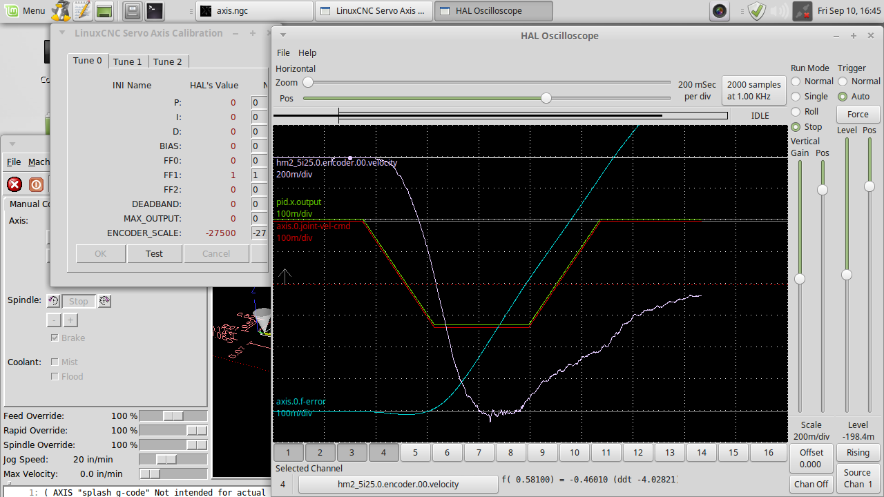

Todd, this is a pic of the trace, as shows moving ok (what I expected, looked 20"/min) then the motor speeds up quickly. The other pic starting out this goes past 20"/min; notice the units for the white trace are different from others (are at 200/) units and have offset (the baseline) to show complete trace, (notice max velocity is set to 0.0 on the slider). The file names are the settings: PS=new power supply s1-1.617; s3=110; p1=Pot1=10.0; Pot3=8.0; Pot2=11.0 (-.375)=10.625CW(as per equation, set to 11.0 CW).
I was thinking the new power supply would not change tuning at all, or very small amount.
The traces are attached.
Many thanks

03 Aug 2022 17:20 #248954
Replied by Todd Zuercher on topic Set up using AMC AB15A100 drives, brushed DC motor Prototrak Plus with Encoders
That would be the field power connector for the 7i77. Yes, that should have no effect on drive tuning. Is that the only thing it is connected to?
How is it connected? Positive leads go where, negative leads go where? Are chassis grounds involved?

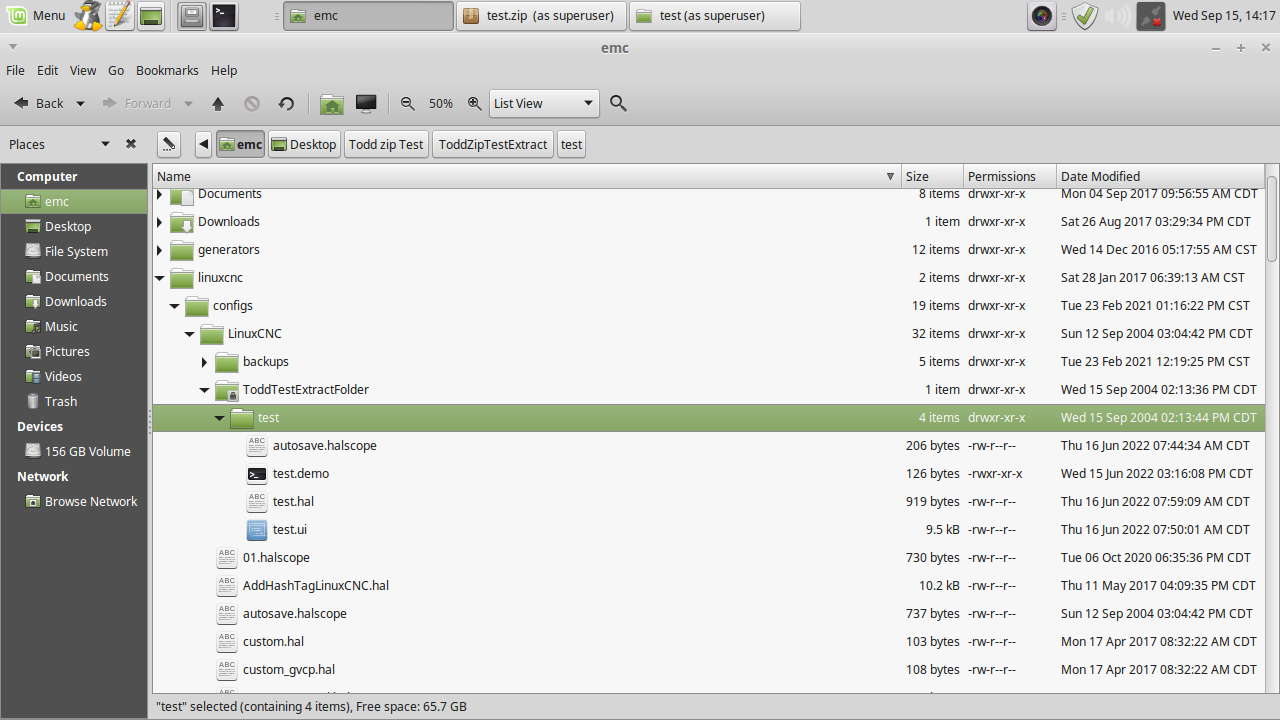

08 Aug 2022 14:13 #249340
by new2linux
Todd, thanks. Attached is a pic of the .zip file extracted in the Linuxcnc configs dir. Does this appear correct, or what am I looking for, a screen like the one in the post at (page 13) #245270? Will there be an icon to pick from the desktop to start the signal? I have not seen an icon for this.
Many thanks!
Many thanks!
