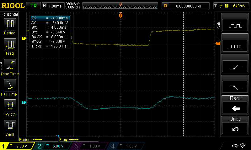

Todd, you are the man!! Yes, the "Auto" provides the attached pic. It is important to leave the USB & the "siggen" signal "on" until the message on o-scope says it's ok, otherwise the trace will not copy. This trace is closer?

Yes, better. But I'm not happy with the wave form on channel 1. It "should" be a simple square wave of +/-1v. But what is coming through is mostly 0v with +/-1v peaks. Not at all what it should be. (I wonder if I've done something stupid in Hal to cause this)
Help Peter! (or someone else with better Mesa knowlege.)

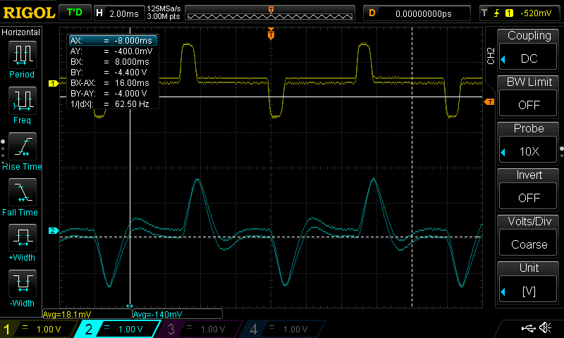

With the drive disabled, in Halscope, change the source for channel 2 to be "hm2_5i25.0.7i77.0.1.analogout0". Then force or trigger Halscope to see the new trace (Sometimes you have to do this a couple of times for it to take.) What does that trace look like? Is it a "normal" square wave, or something else resembling the yellow trace you're seeing on the real scope?

Todd, Many, many thanks!! I think it looks better. Please see attached pic. The yellow trace is the 1 to watch?

Ah, now we're getting somewhere. What did you change to get the proper square wave?
Increase the vertical gain on both traces so it is easier to see what is going on, and If possible overlay them so they are right on top of each other.
You are now ready to start following the current loop tuning instructions (from the looks of it you will need significantly more proportional gain in the current loop SW3-1-5)

I didn't really answer your question, The yellow trace is the command to the drive, the blue is the drives responce. Your goal is to try to make the drive's response look as much like the yellow command as you can.

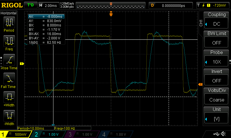

Todd, thanks! After review of how-to set both channel traces, to lay on top of each other and set the height of the trace as shown in pic, the settings don't stay set for next time. I have read how to set on "rising edge" (I am not shore I am there, but know the "symbol" to look for. I don't recall in all the read & you-tube that a save was needed to keep o-scope values even after power down.
Many thanks!
Edit: I found the auto settings "save button" to show all (the option is overlay yes or no) and the "save" at the bottom of that screen. It did not save the height of trace. This "overlay" is 2nd (of 3) screen after using "utilities button". I will look for similar way to set & save height.

That looks very usable (the traces not the drive tuning.)
Try reduce the overshoot, and if possible faster rise.
I am not sure you can directly compare the heights of the plateaus, because they are different scales and voltages. Mostly you're comparing the shapes.
