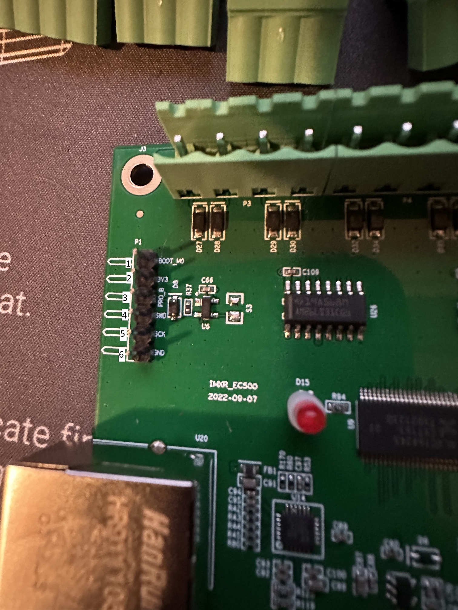

Hi, i have some issues with the EC500 rt1052. Please note, i'm a complete beginner when it comes to this.
I tested the board with Mach3 and it was running without any problems.
I connected the ST-Link to the board pins as follows:
SWCLK -> SCK(number 5 in the picture)
SWDIO -> SWD(number 4 in the picture)
GND ->GND(number 6 in the picture)
Added a jumper between BOOT and 3v3(number 1 and 2 in the picture)
I powered the board using 24v PSU.
Using "pyocd list" it shows the STLink but no target.
I tried the flash: "pyocd flash .\remora-rt1052-EC500-beta.bin --target mimxrt1050_quadspi"
Got the following:
0016578 I Erased 131072 bytes (2 sectors), programmed 117760 bytes (460 pages), skipped 0 bytes (0 pages) at 7.38 kB/s [loader]
I ejected the stlink from the system, disconnected the board from power, removed all the wires and reconnected power and ethernet cable.
Configured the PC's IPv4 address to 10.10.10.100/24 and tried to ping 10.10.10.10 but got no reply. I tried this on my windows pc and my debian laptop. Didn't work.
I then tried to flash the original firmware from here: github.com/scottalford75/Remora-RT1052/t.../original%20firmware and got the following:
pyocd flash .\ec500.bin --target mimxrt1050_quadspi
0114903 I Erased 196608 bytes (3 sectors), programmed 196608 bytes (768 pages), skipped 3997696 bytes (15616 pages) at 35.99 kB/s [loader]
It looks like(to me) it wasn't able to fully upload the firmware.
After that i changed my ip address to 192.168.4.100 and tried to ping 192.168.4.1 but it didn't work. Tried to connect it to Mach3 but it didn't work.
I tried to reflash the remora firmware but again, no ping responses.
Can someone please help? I'm not even sure i connected the STLink correctly or if i skipped any steps...
Thank you

There is no need to add the jumper, only the ground, SWDIO and SWSCK.

19 Aug 2023 10:49 #278454 by MotoMishka
Replied by MotoMishka on topic Remora - ethernet NVEM / EC300 / EC500 cnc board
Hi Scott,
Thank you for your reply. Do you think i fried the board with that jumper? I ordered a pico probe, will try with that once it gets here.
