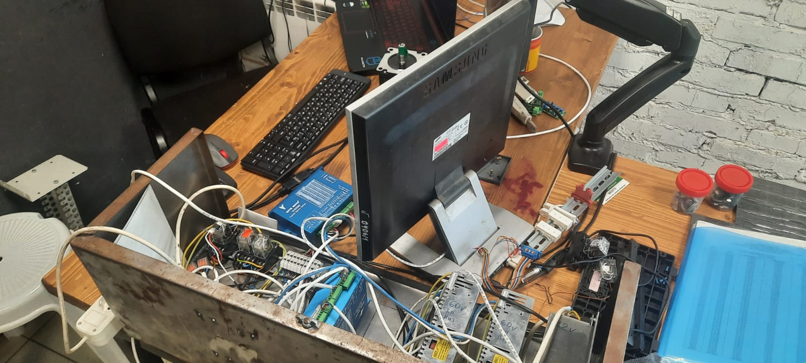

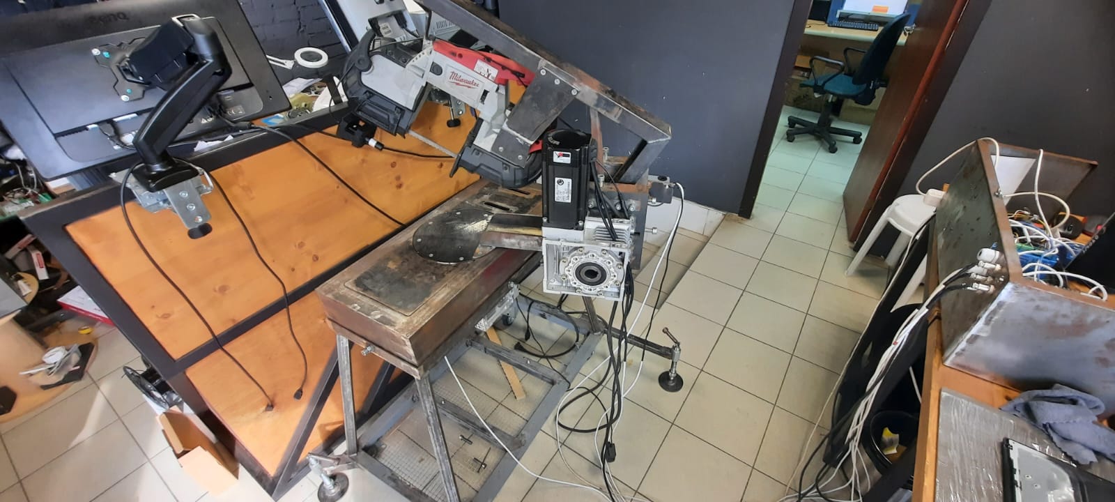

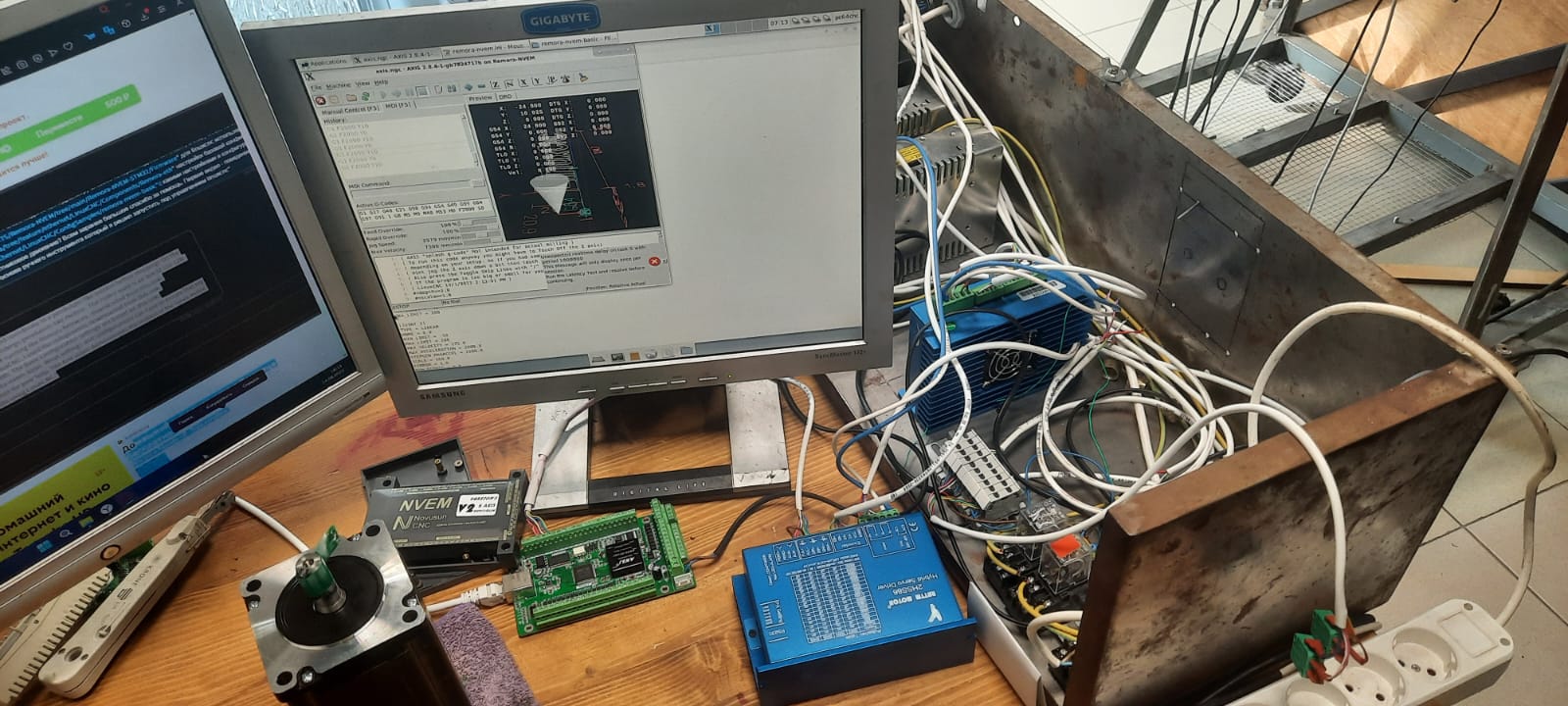

- Eugene64
- Posts: 10
07 Aug 2023 16:56 - 08 Aug 2023 07:01 #277254
by Eugene64
Replied by Eugene64 on topic Remora - ethernet NVEM / EC300 / EC500 cnc board
Hello, please help me configure hal and ini for the 2hss86 engine drivers using the standard remora settings does not work. Please, if there is, publish such a hal file.

Possible to have some further details of the issue(s)?Hello, please help me configure hal and ini for the 2hss86 engine drivers using the standard remora settings does not work. Please, if there is, publish such a hal file.

09 Aug 2023 10:55 #277421
by Eugene64
When sending a command, the motor moves more than the set value, then returns to this value what settings are needed to turn the motor to the values I need, here are my ini settings -

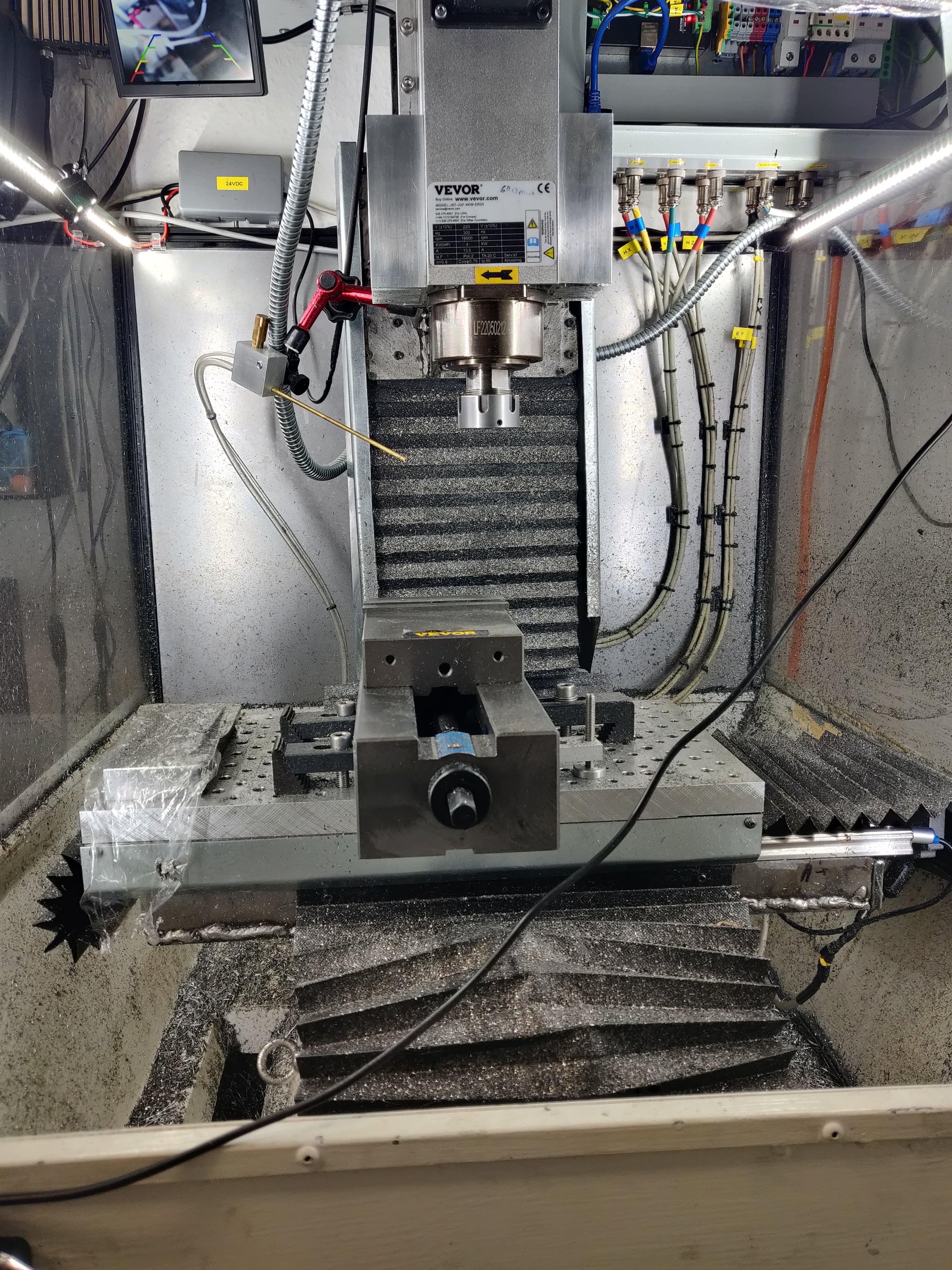

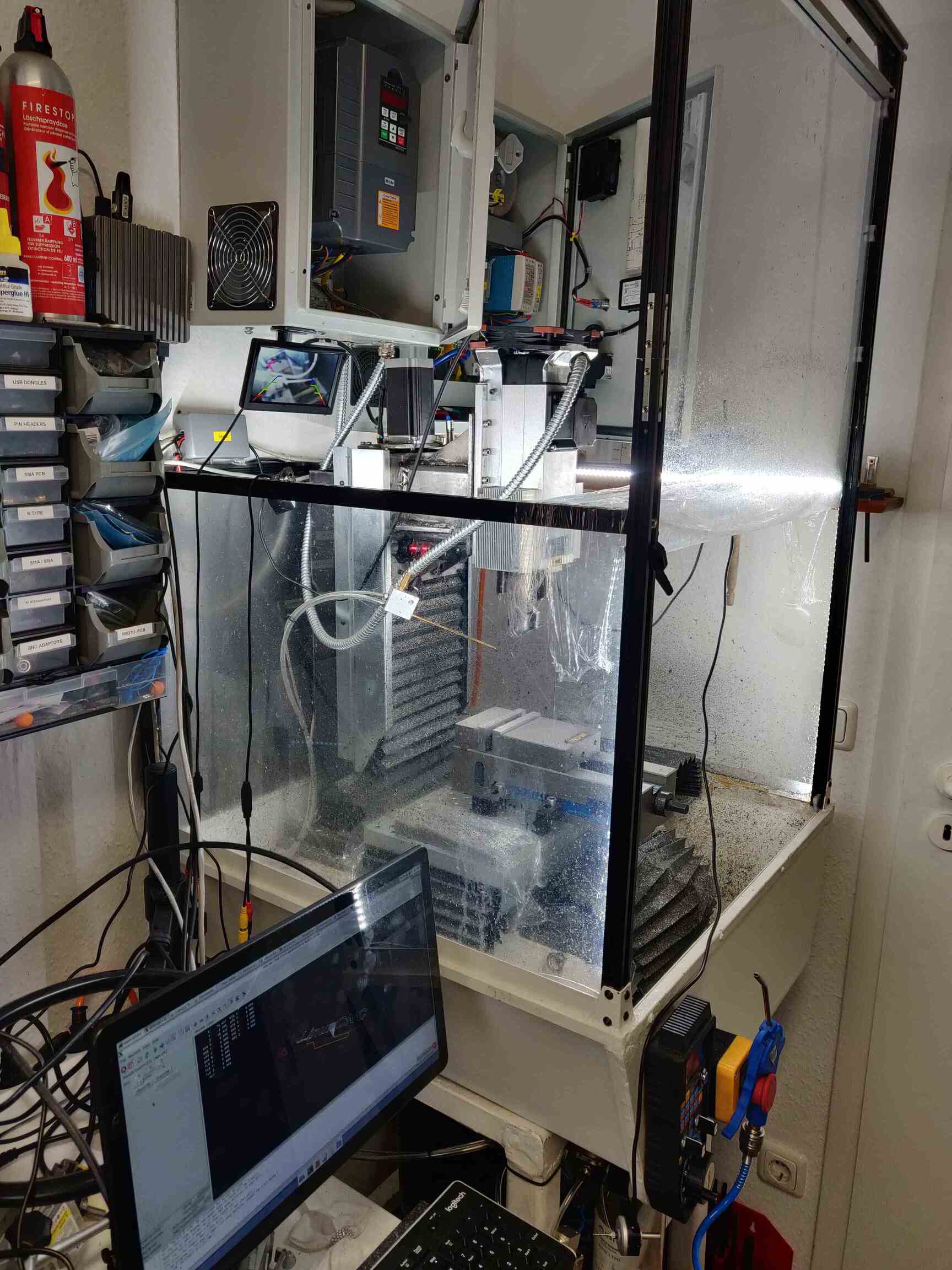

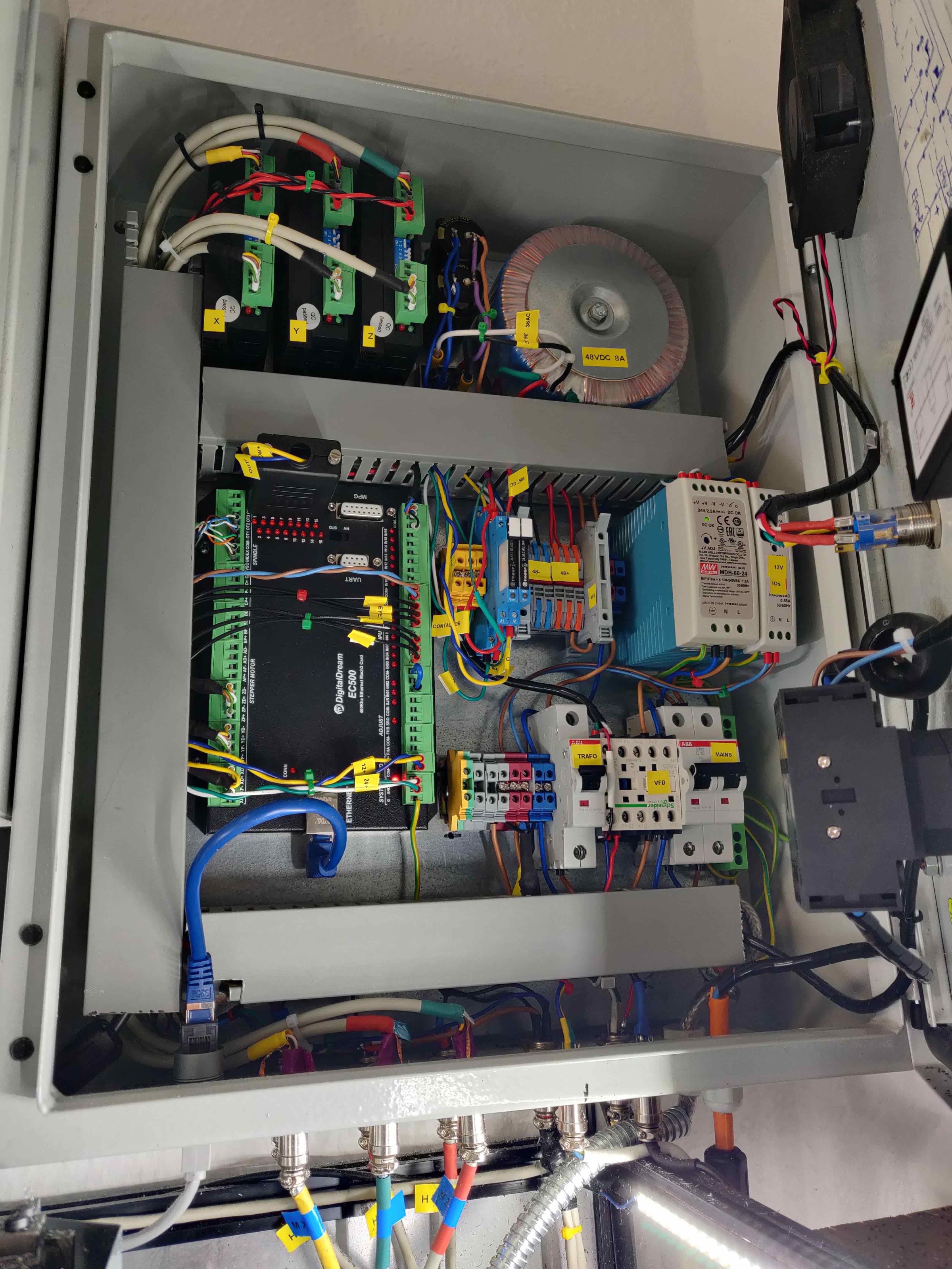

Next steps will be to try it on the EC500 and set everything for my machine. Some pictures here below. I've designed this vertical mill from scratch, with zero knowledge of machining or machine design (I have an Electronics background not mechanics), but so far it's working great and I've been struggling with Mach3 for a few months (a piece of buggy old shht) so I've finally decided to get into LinuxCNC.
By the way, if anyone is interesting on building something similar, I could share the design files and some experience, just let me know.
Cheers!
