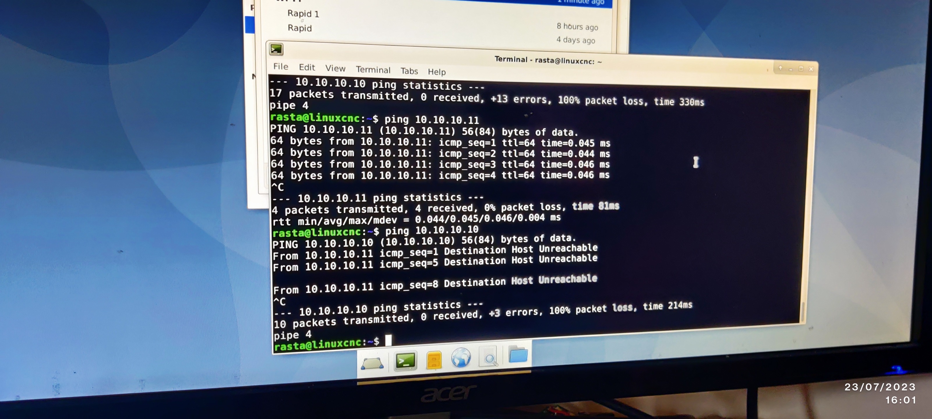

23 Jul 2023 14:15 - 23 Jul 2023 14:17 #276072
by raf1110
Replied by raf1110 on topic Remora - ethernet NVEM / EC300 / EC500 cnc board
Last edit: 23 Jul 2023 14:17 by raf1110.

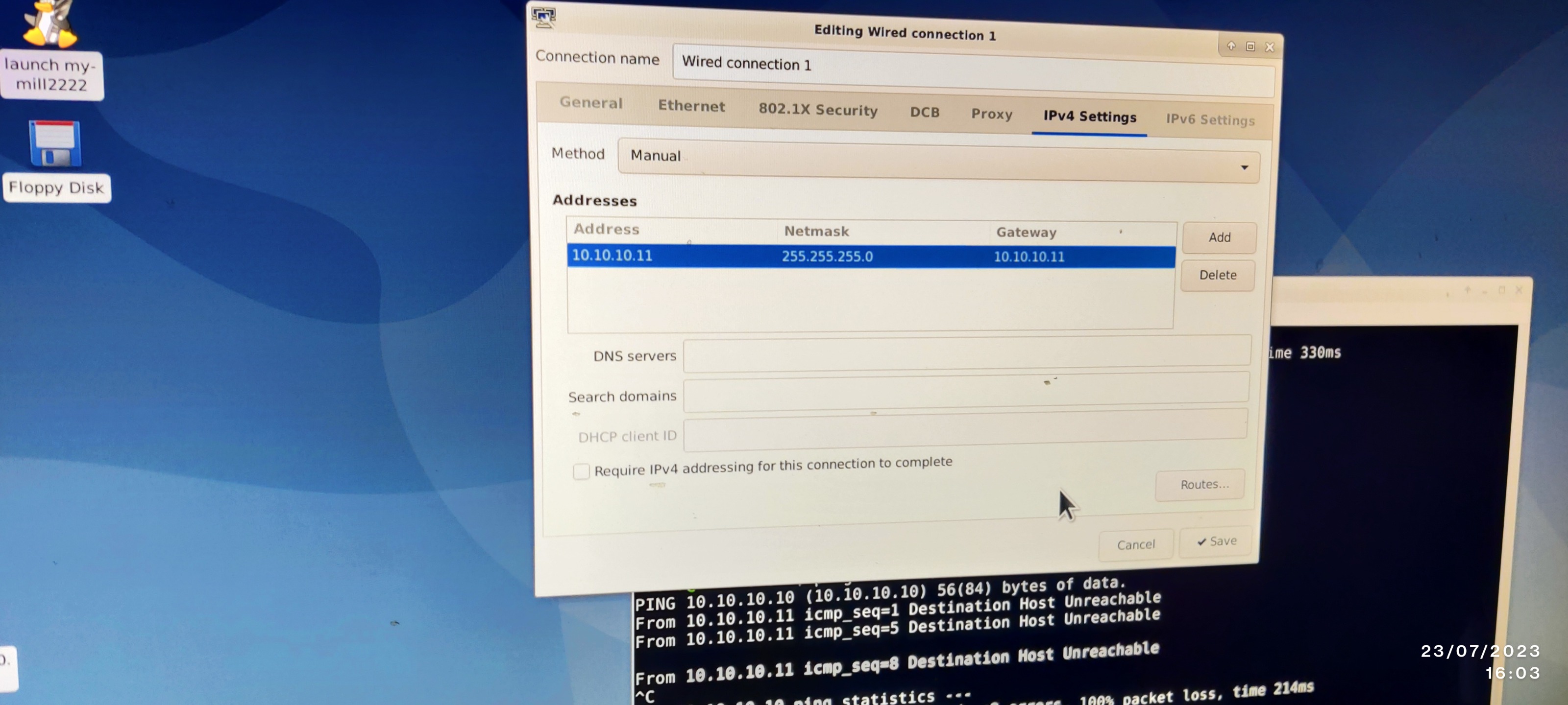

23 Jul 2023 14:22 #276073
Replied by tommylight on topic Remora - ethernet NVEM / EC300 / EC500 cnc board
Nope, that is the reply from the PC, not from the board connected to it, reply time to short at ~0.05
Set the PC address to 10.10.10.11 or whatever number at the end, just not 10.

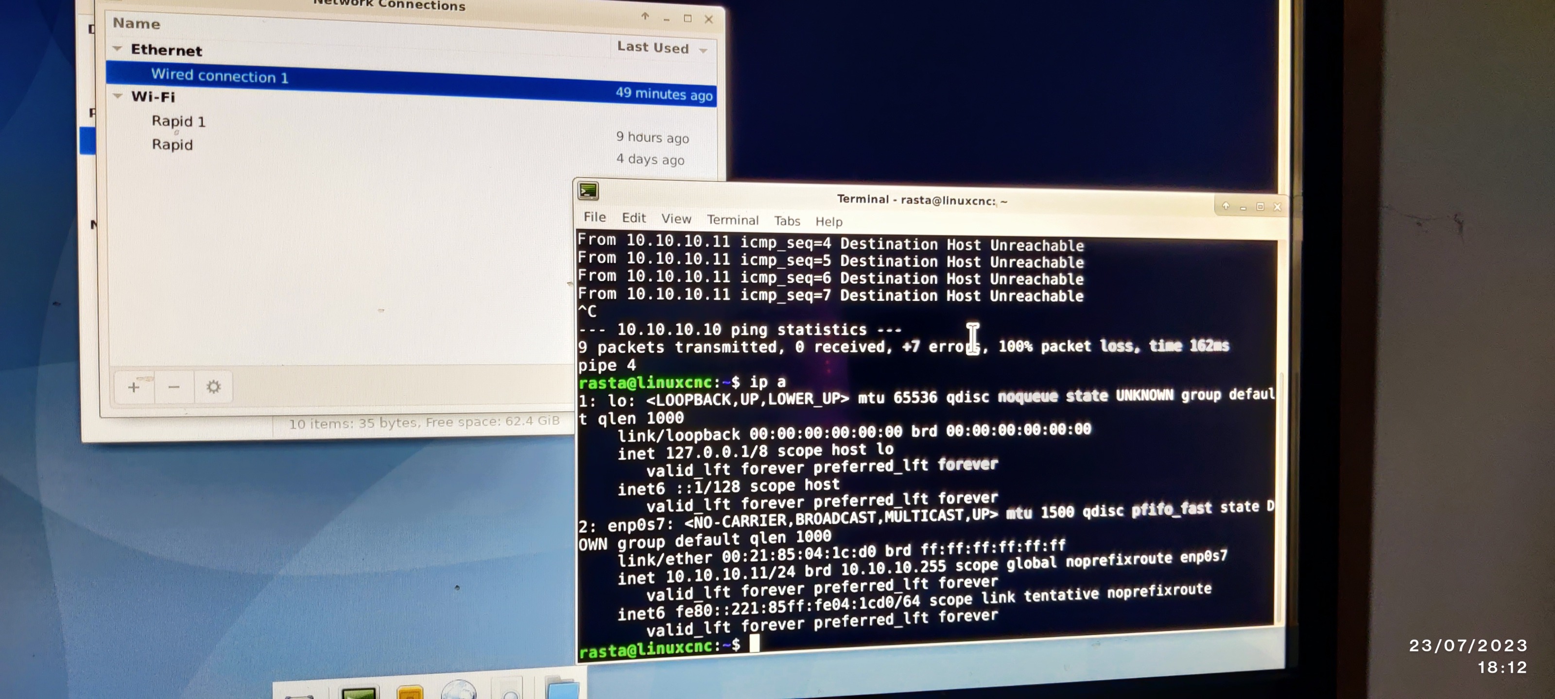

23 Jul 2023 15:06 - 23 Jul 2023 15:06 #276078
by raf1110
Last edit: 23 Jul 2023 15:06 by raf1110.

23 Jul 2023 15:50 #276083
IP is OK, netmask does not matter but for 10.n.n.n is usually 255.0.0.0 or /8, gateway can be empty or 10.10.10.1 not 11.
Still should work, but seems there is nothing connected to it, so what does
ip a
in a terminal return?
ip a

23 Jul 2023 17:03 #276088
by tuxcnc
The second problem may be your cable. Do you use network switch or router? If not, you should use crossed cable.
But this is common Linux problem, described in many places in the Internet, not the Linuxcnc or Remora specific.
Replied by tuxcnc on topic Remora - ethernet NVEM / EC300 / EC500 cnc board
Some networks cards do not work correctly if the appropriate firmware is not installed in Linux.Got that with this setup

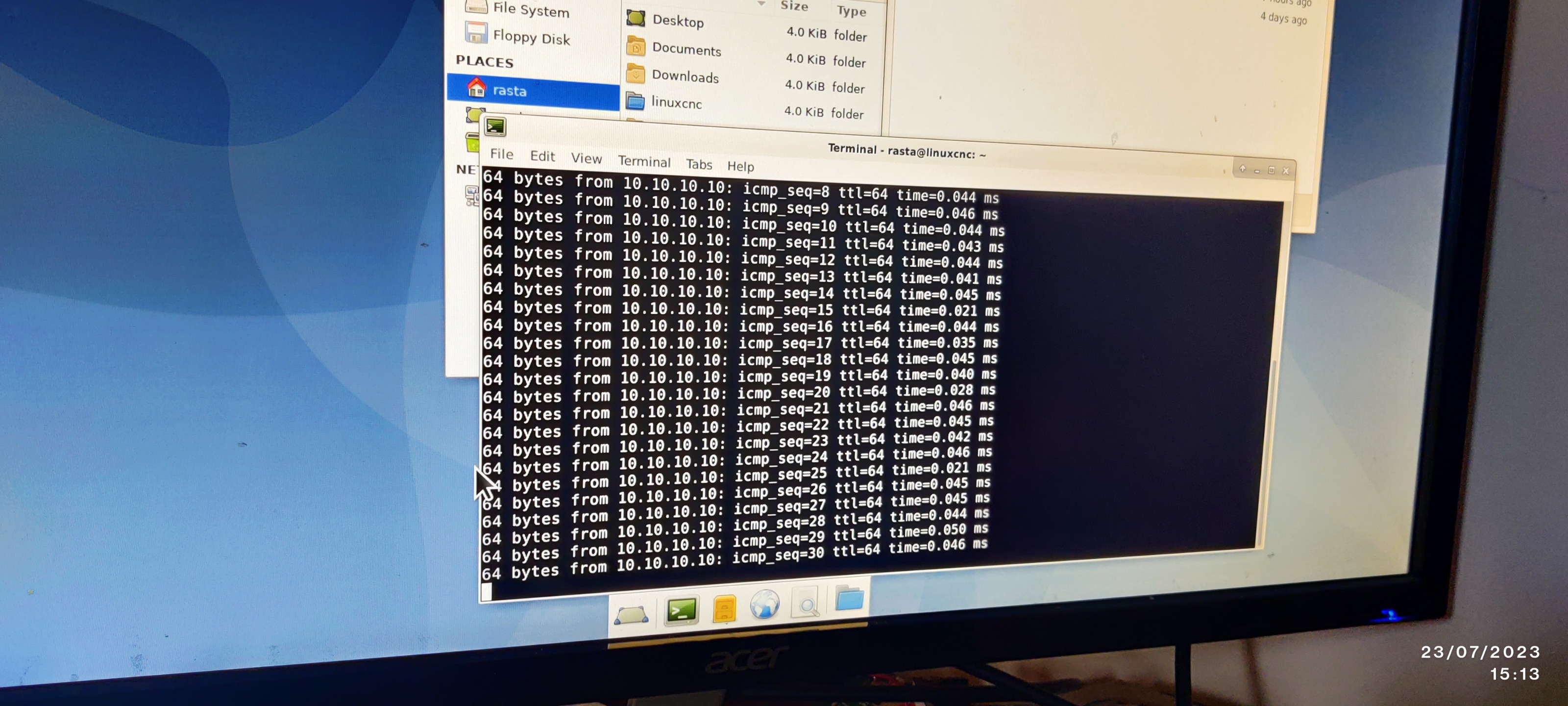

23 Jul 2023 17:14 #276089
by raf1110

23 Jul 2023 17:28 #276092
Not connected to anything, try another cable, directly from PC to the board.
Most new stuff works with any kind of cable, but this might need a "cross" cable, not sure as i never used Remora boards.
