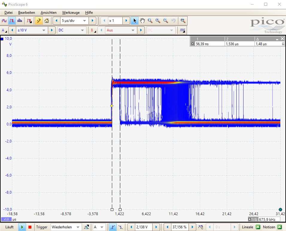

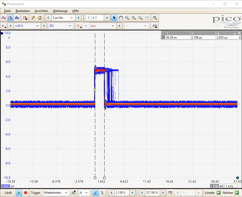

17 Aug 2023 09:53 #278244
by 4170-thomasnobi
Replied by 4170-thomasnobi on topic Remora - ethernet NVEM / EC300 / EC500 cnc board
Hi Scott,
I also have problem with the motors or the NVEM RT1052 controller.
I have made some measurements with the oscilloscope. With the FW "remora-rt1052-NVEM-0.2.1" the pulse length from 1.5 to 30us are very variable and with the "remora-rt1052-1.1.0.bin" these are not so bad but very many pulses at 2us. see images
What could be the problem here?
With best regards
Thomas

17 Aug 2023 10:17 #278248
by meister
Replied by meister on topic Remora - ethernet NVEM / EC300 / EC500 cnc board
thats competing interrupts in the software step generation, or in short : jitter
but longer pulses are no problem

17 Aug 2023 10:47 - 17 Aug 2023 10:49 #278252
by 4170-thomasnobi
thanks for the quick reply. Scott says on page 81 of the thread the pulse length was 25us. If you measure the pulses can be up to 1.5us short. I need min 2,5us for my motors. I have a NVEM V2 with RT1052 and many problems with step losses. A help or a tip what solves the problem?

17 Aug 2023 11:06 #278254
by meister
Sorry, I can't quite see through the versions any more.
Of course, pulses that are too short are a problem,
apparently the length depends on the BaseThread interval.
the code here: github.com/scottalford75/Remora-RT1052/b...urce/configuration.h says:
#define PRU_BASEFREQ 40000
thats : 1000000us / 40000.0Hz = 25.0us
i don't know why its only 1.25us on your system
void updateBaseThread()
// ISR runns at double PRU_BASEFREQ, make steps in one cycle and reset in the next
if (!step)
makeSteps();
step = true;
else
resetSteps();
step = false;
}the code here: github.com/scottalford75/Remora-RT1052/b...urce/configuration.h says:
