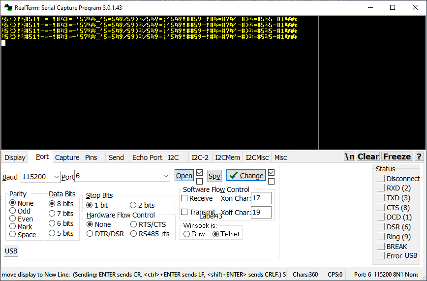

- liampc
- Posts: 2
13 Jan 2024 17:10 #290570
by liampc
Replied by liampc on topic Remora - ethernet NVEM / EC300 / EC500 cnc board
Hello, could anyone shed light on the serial communication coming from the EC300? I'm using a Picoprobe as a UART bridge but I receive garble uploading the config via ethernet. I know the baud is 115200 but are there any other changes from the default settings in RealTerm?

- liampc
- Posts: 2
14 Jan 2024 09:12 #290624
by liampc
Well unfortunately that leaves me scratching my head. I've put a cheap logic analyzer in parallel and so it doesn't seem like the picoprobe's doing something funky.
This is a screenshot of RealTerm whilst the EC300 is not connected via ethernet. I've manually added in the line breaks between each message to show its just the same message repeating. I'm guessing this is some message indicating it's waiting for a connection or to initialise.
I'm not super fussed as currently LinuxCNC is connecting and coming out of e-stop, so everything else seems to be working. I'm just covering myselfwhen if anything breaks.
- raf1110
- Posts: 47
- Thank you received: 5
14 Jan 2024 13:56 #290640
by raf1110
Replied by raf1110 on topic Remora - ethernet NVEM / EC300 / EC500 cnc board
try
in display tab-all char+new line mode
make sure you trying correct port close change reopen-status closed only shows.
If this wont give you correct output probably you flashed incorrect .bin firmware (made same mistake as browser is not downloading correctly .bin files you need to pick from downloaded .zip after unpacking.
