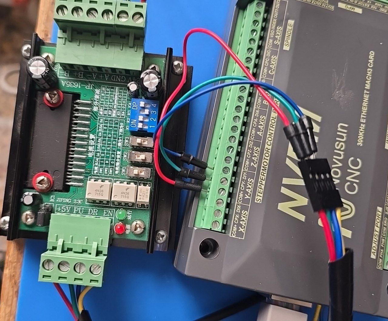

I would like, while waiting for the final hardware, to try nvem v5 and remora with this TB6560 JP-1635A driver installed on Y.
This driver has an EN input that I leave disconnected, as I was advised, I also tried to connect to COM + but without results.
I read these:
remora-docs.readthedocs.io/en/latest/har...thernet/rt1052.html#
remora-docs.readthedocs.io/en/latest/software/hal-examples.html
linuxcnc.org/docs/html/integrator/stepper-timing.html
the problem is this stepper movement is not smooth and the movements are too short:
youtube.com/shorts/Hnpl1kUg8-o
If someone is so kind to take a look at my configuration mess and help me solve it I would be grateful, even if I am thinking that the problem is the connections of this obsolete driver.

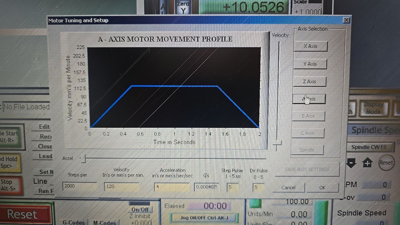

I also tried on mach 3 with its original controller and the stepper moves correctly(But have all 4 pin connected)
Last edit: 02 May 2025 16:16 by DarkPhoinix.
03 May 2025 02:53 #327578 by cakeslob
did you run that through an AI to generate stuff?

03 May 2025 18:03 #327617 by cakeslob
darkpheonix try with this and go from there. if you are trying to set up a rotational axis, that is different than a linear axis in setup
[AXIS_Y]
MAX_VELOCITY = 5
MAX_ACCELERATION = 20.0
MIN_LIMIT = -0.01
MAX_LIMIT = 300.0
[JOINT_1]
TYPE = LINEAR
HOME = 0.0
MIN_LIMIT = -5.0
MAX_LIMIT = 300.0
MAX_VELOCITY = 5
STEPGEN_MAXACCEL = 2200.0
SCALE = 1600
FERROR = 1.0
MIN_FERROR = 0.5
HOME_OFFSET = 0.0
HOME_SEARCH_VEL = 0
HOME_LATCH_VEL = 0
HOME_SEQUENCE = 0
P_GAIN = 300
FF1_GAIN = 0.1
DEADBAND = 0.001
these options are not real, and im unsure where you got them from.
STEPPER_TYPE = external
STEP_PIN = ystep
DIR_PIN = ydir
#ENABLE_PIN = yen
STEP_INVERT = no
DIR_INVERT = no
ENABLE_INVERT = no
[DRIVERS]
# Generali impostazioni dei driver passo-passo
STEP_SPACE = 100000
STEP_TIME = 100000
DIR_SETUP = 50000
DIR_HOLD = 50000
Time to create page: 0.427 seconds
