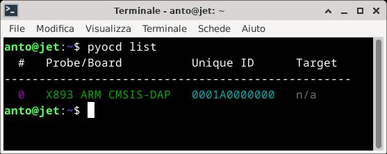

Good evening everyone, I'm having a problem, I don't know where I'm going wrong, I do the ST Linkv2 procedure and it does everything right, but it doesn't appear as a unit on the PC, when I go to connect it to the PC with pyocd it doesn't find the ST Link, I've already bought 3 different ST Links and all 3 do the same thing, I don't know if my pyocd installation is wrong or not, I've redone the installation several times, I don't know where the problem is.

by correct procedure you mean the one described by @Scotta to convert a STlink V2 into a CMSIS-DAP probe.
Pyocd will not see it as STlink, but as CMSIS-DAP
Replied by jjdege on topic Remora - ethernet NVEM / EC300 / EC500 cnc board
hiI do the ST Linkv2 procedure and it does everything right,
pyocd listAttachments:

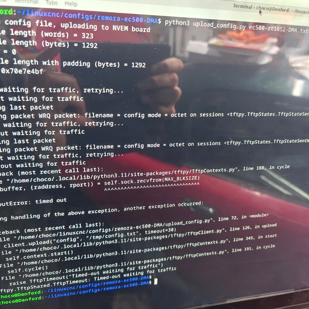

I'm trying to upload the config on another EC500 but I'm getting this error. It's bookworm installed from the linuxcnc iso on a PC.

murphy, is this a new linuxcnc and remora install?

Yes Cakeslob it's for my mill. Bought a cheap 24" touchscreen from Amazon and got carried away testing it lol Static IP address, is it 10.10.10.10 or 10.10.10.11 for the board ?

Looks like the board is at .10 and the PC should be .11
