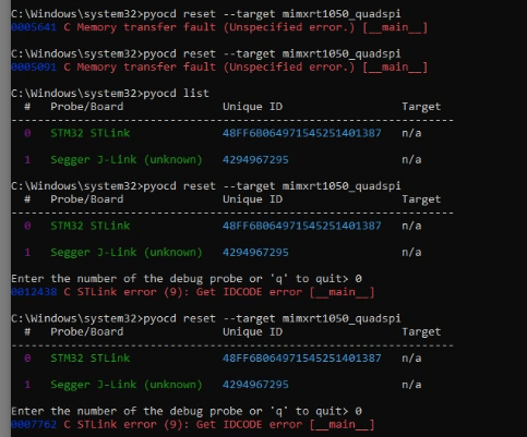

19 Apr 2025 09:58 - 19 Apr 2025 10:46 #326676 by DarkPhoinix
Replied by DarkPhoinix on topic Remora - ethernet NVEM / EC300 / EC500 cnc board
pyocd reset --target mimxrt1050_quadspi
pyocd erase --chip --target mimxrt1050_quadspi
pyocd flash remora-rt1052-3.1.3.bin --target mimxrt1050_quadspi
I tried with stlink and j-link with errors.I also tried reversing swdio and swclk, because I saw images of pins connected differently.

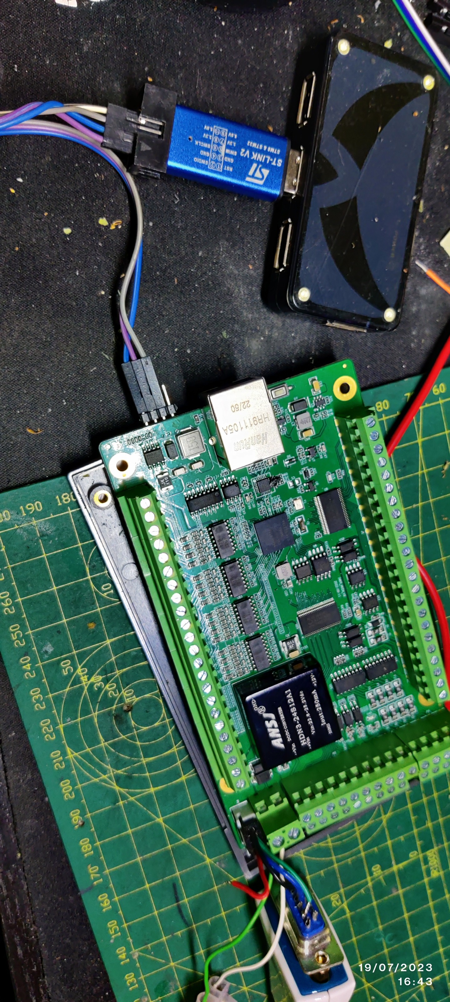

19 Apr 2025 10:27 #326678 by DarkPhoinix
These are photos showing different connection diagrams with swdio and swclk reversed
