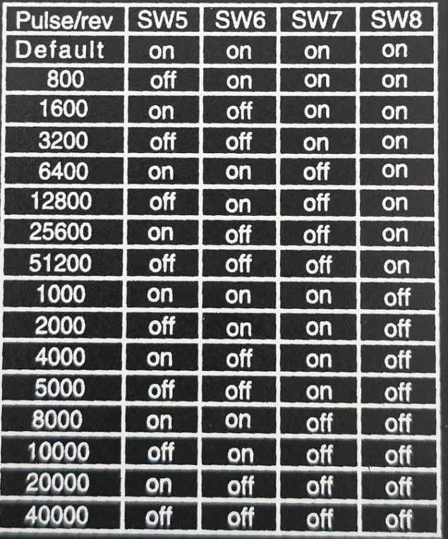

At the risk of the blind leading the blind, to me that is not quite the right question. That chart is for your micro-stepping. Like the 800 is 4 microsteps, if you're using a 1.8 deg. stepper. I have always looked at it this way - What are you doing with the motor? If your opening a door or driving a ram, picking 800 would be fine, but using that on a belt or lead screw may very well end up leaving artifacts in the work due to the rougher movement between points. The downside is the more micro-steps you have the more torque you lose. 3200 (16 micro-steps) seams to be a reasonable middle ground that most use as standard. The controller will put out as many steps as directed by LinuxCNC to make a revolution, just a matter of how fast it can do it.
Whatever you chose, that gets figured out when you tell LinuxCNC in your .ini file how many pulses it takes to move one unit. That is set with the SCALE on each axis. Like for me, I have 16 micro-steps (3200) and a 5mm pitch screw, which works out to SCALE = 640 or -640 depending which way you need the motor to move.

hey murph, i think scott said the outputs were just optocouplers or something like that, see if you can filter through his recent posts,
pheonix, like spyder said its based on application, but start with like 800-1600 and if you get following errors its too high

I have set 12800 and testing some gcode only with Y working.

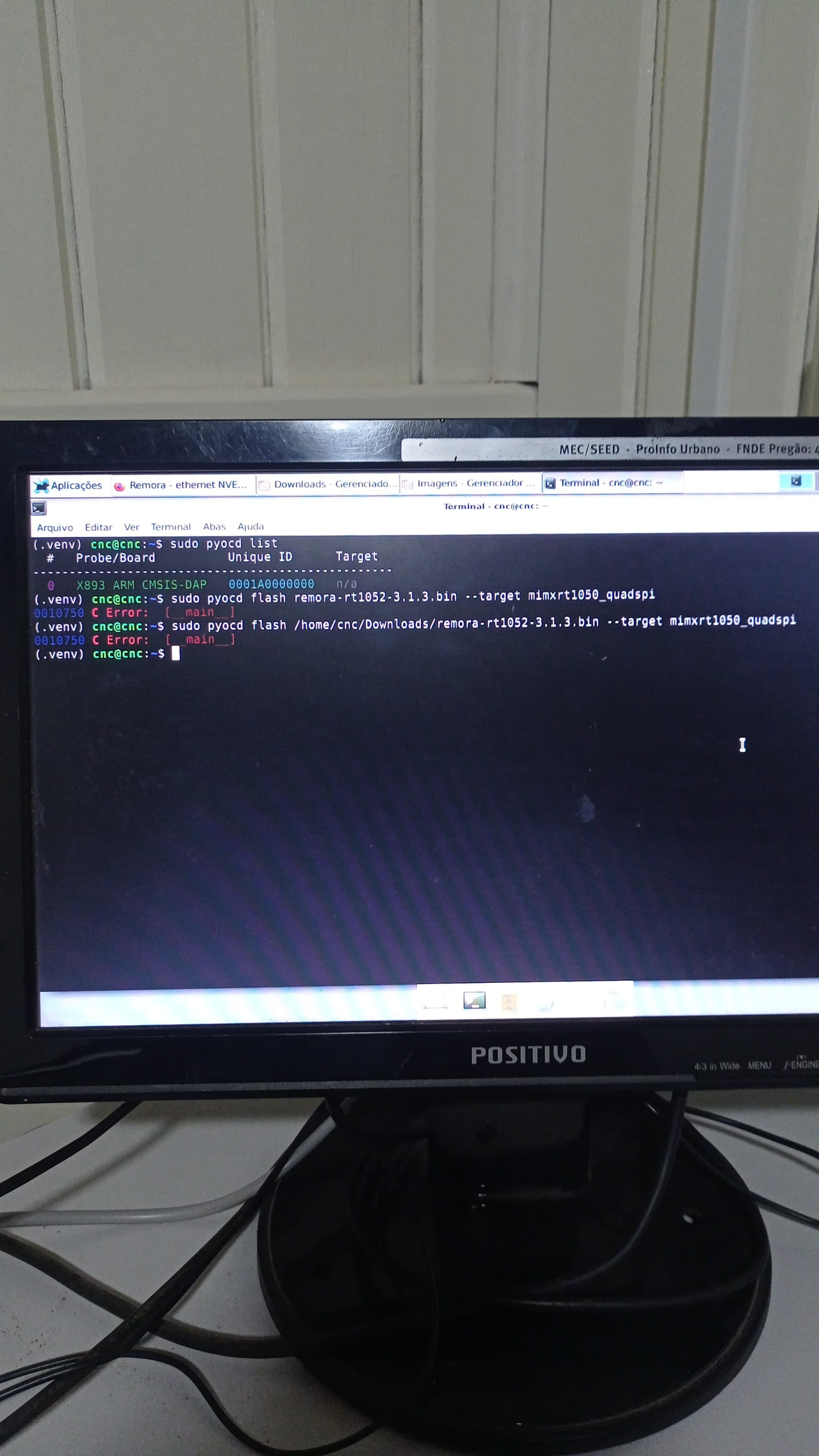

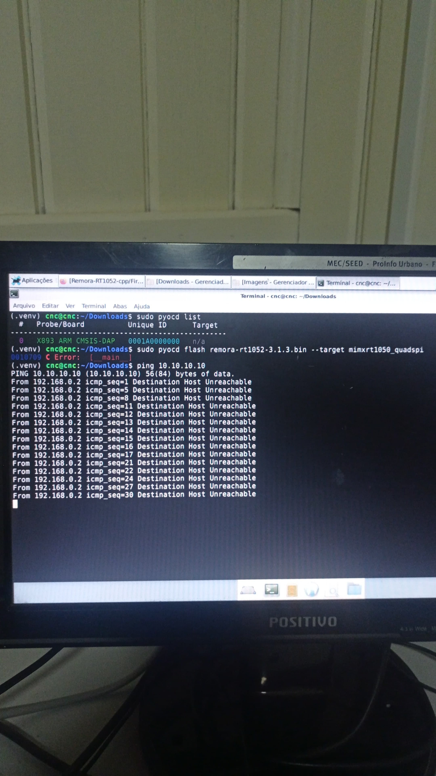

Please, I've been trying for months without success. Everything seems to be fine, but I can't compile it onto the board. I'm using v5 of the cloud. I have no idea what it could be. I see that everyone follows the steps and it works. However, I even had a lot of trouble installing pyocd, but with a lot of effort I finally managed to do it. Please, can someone tell me what I'm doing wrong?

Try been in the directory where the file is located. Before you run pyocd. Are you able to ping the board. 10.10.10.10 ??

Hello dear EC500 users,
same as Thayloreing , I had a quite frustrating time trying to flash my EC500 over the last months. And there still is no success. So I am considering quitting the whole thing but I want to give it a last try by registering to this forum.
The problem is to get the firmware into the flash... and I did not find any solution that is working for me. I even can not reproduce the video from scotta with the reprogrammed STLink/V2 stick.
I tried:
The DAP Link Probe is being detected under Linux and is attached to /dev/ttyACMx, but flashing with pyOCD leads only to the prompt: no ACK.
Using both probes under MCUExpressoIDE under Linux is useless, because they are not detected at all. JLink shows up, can be selected but stops programming by stating: can't stop CPU.
The EC500 seems to be a quite nice piece of hardware and I would like to use it in my projects.
Is there a working solution to flash this board available anywhere? I was not able to find any reliable solution what so ever.
Further on: Is the programming interface on the EC500 even usable? And what pins has to be used? There are:
I hope for any help on that topic. Programming a MCU should not be that complicated...

18 May 2025 20:45 #328715
by scotta
Hi Julius,
Very strange that one of those combinations don't work, especially MCUExpressoIDE.
For flashing
1. board is externally powered from 24v, so no VCC connection
2. GND, SCK and SWDIO is all the connections needed to the CMSIS-DAP probe
When I've experienced connection issues, powering on the board as the probe is trying to connect to the MCU has helped.
