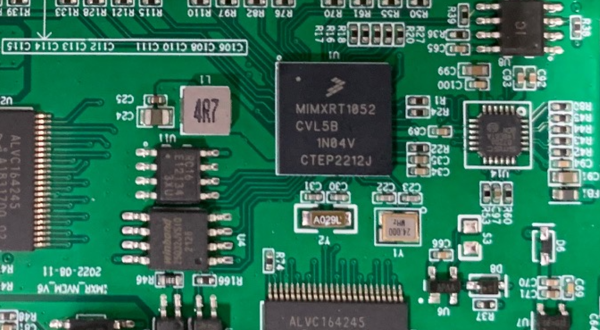

Possible to get a clear image of the PHY. It looks to be the same as the earlier NVEM's but it would be good to know.
Sorry Scott, on re-reading that I now interpret you are asking for a better image of the PHY? If so could you explain to this ancient layman what you mean please?

Fairly sure its the ethernet chip here he is looking for
09 Sep 2022 23:42 #251585 by Bari
Maybe a few extra close up pics of the chips that are a bit blurry if possible. Then we can post links to all their data sheets.

Yes, some good clear images of front and back of board for this part of the board. What I did for the EC500 was to overlay the back and front images in CAD, aligning the vias so that I could then trace the circuit. Some really clear closeup photos would help.

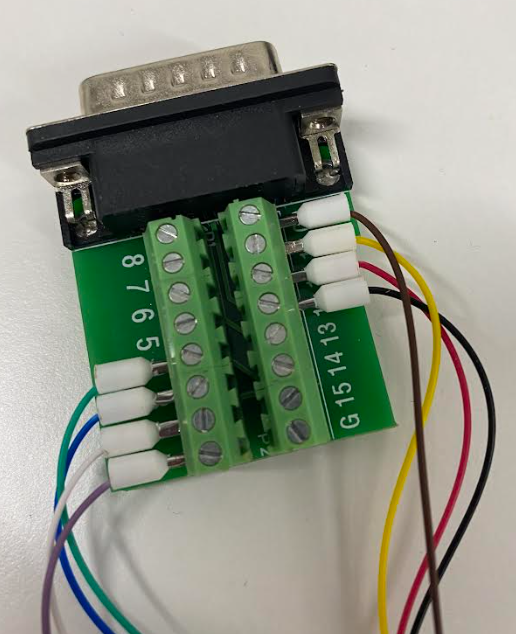

A few more things to check. Below is my wiring which is known to work. RX <--> TX.

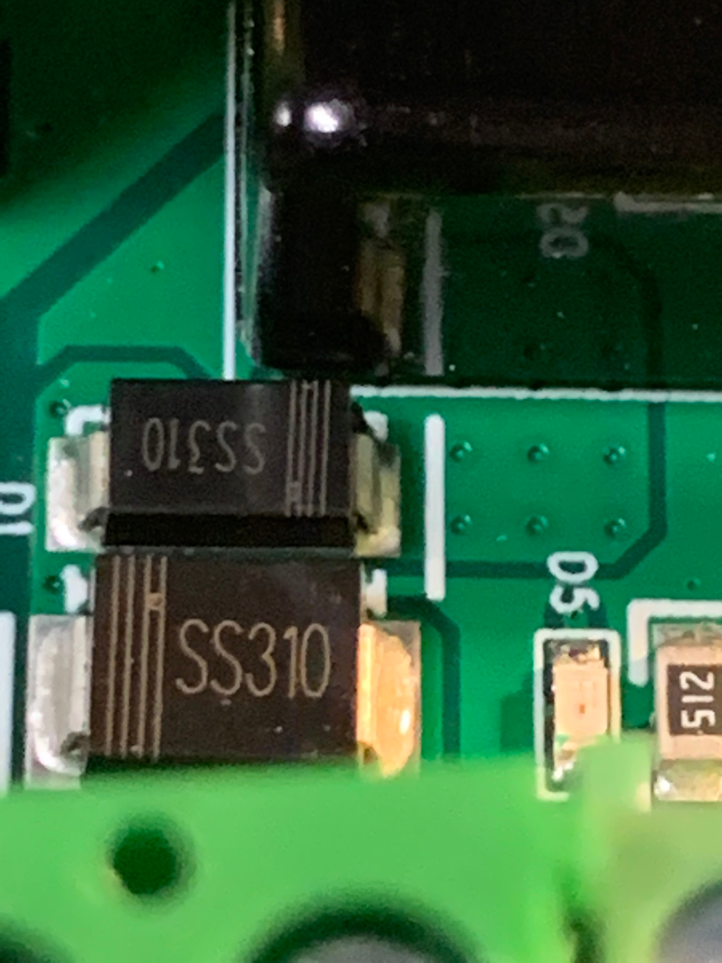

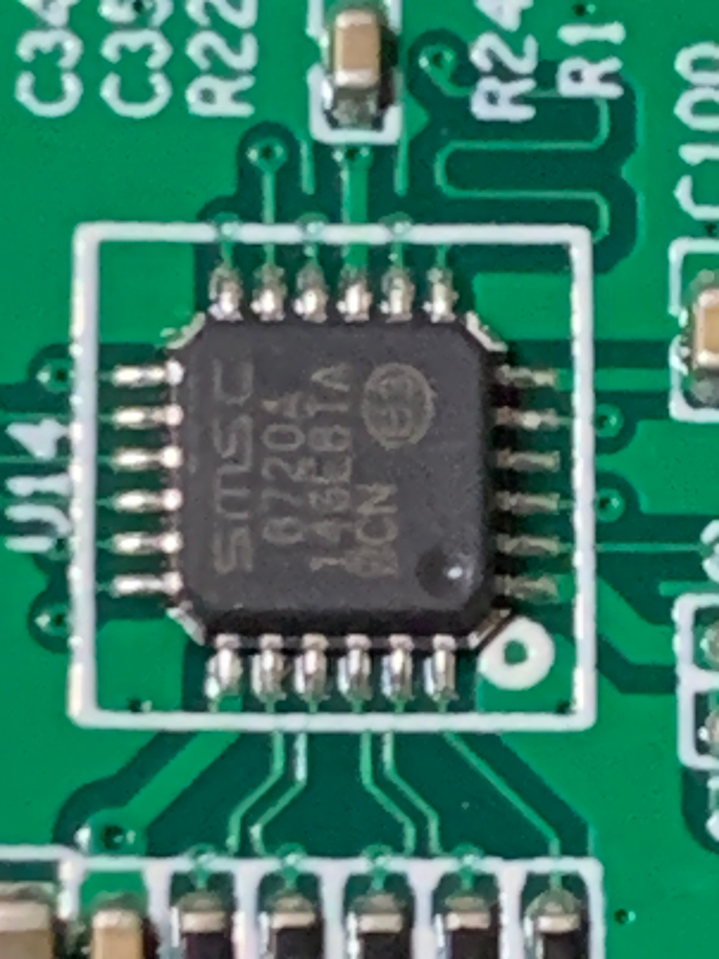

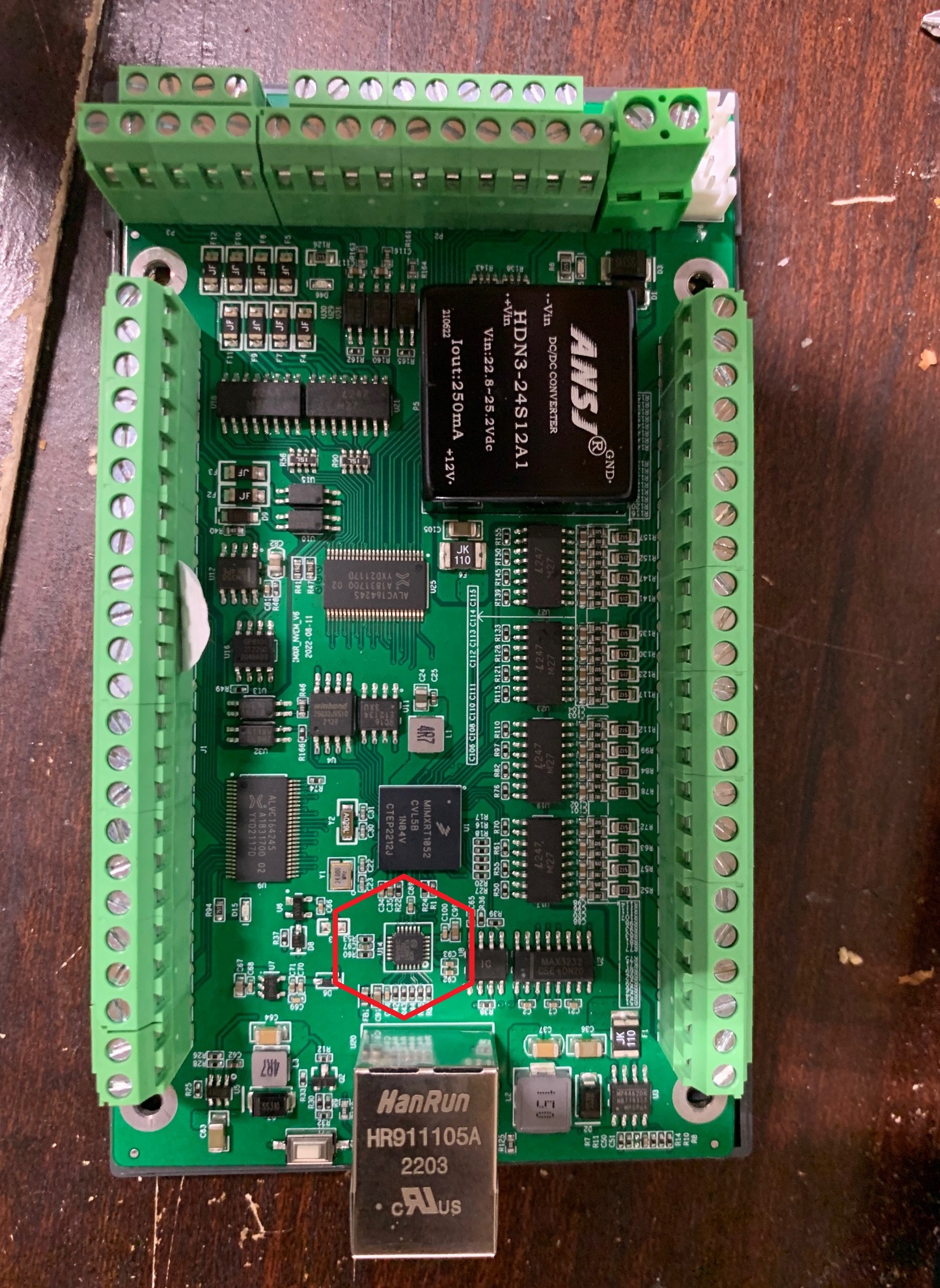

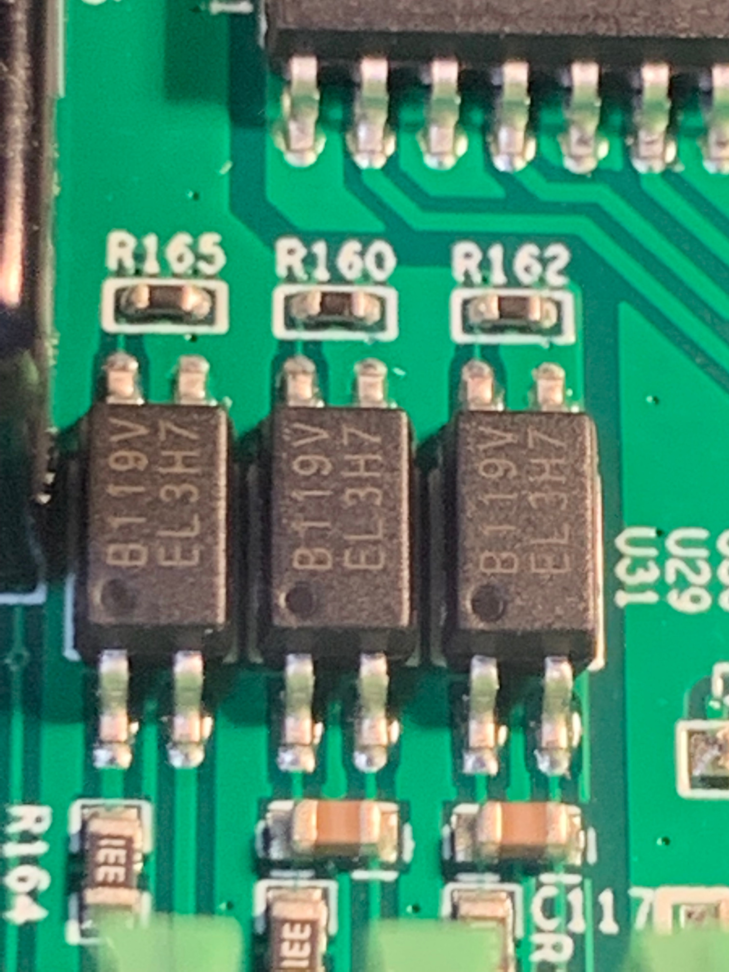

OK these are the three I see as blurred, first is the PHY one.
Second is the three chips to the left of the DC/DC in my original, third is the two chips to the top right of the DC/DC.
I'll borrow my wife's iPhone 13 pro tomorrow and set up lighting so that the text is is better contrasted, and I will do the reverse side of the board.
And I will share a high resolution version from my own forums where I allow 4K

Thanks Rog. The PHY is the same as the earlier NVEM's.
