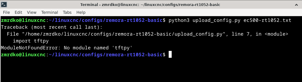

Hi,I'm back from mach4 after a while.
I have just flashed new firmware and inputs and outputs seems to stop working on my recent settings.
And also some outputs seems to be on: 5, 7, 12, 14, 16 on startup.
And changing output states in Halshow (Pins->remora->output) does not really change output state.
What did I miss?
I tried default config (github.com/scottalford75/Remora-RT1052-c.../remora-rt1052-basic) and it's the same.
With the new firmware you will also need to upload a configuration file. I've done one for each for the NVEM, EC300 and EC500. They are located in the LinuxCNC directory.
Copy one of these into your configuration directory and run the upload script. eg
$ python3 upload_config.py ec500-rt1052.txt

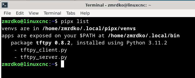

Thanks for reply.I was half successful. I installed tftpy using pipx, but it does not change anything for script upload_config.py and I am still gettingModuleNotFoundError: No module named 'tftpy'Meanwhile I am trying to google what's wrong.I guess it has something to do with venvs.
EDIT: I manually copied tftpy library to location where the rest of the python3 libraries were stored, so I successfully uploaded the configuration file. I looks like it works now.
