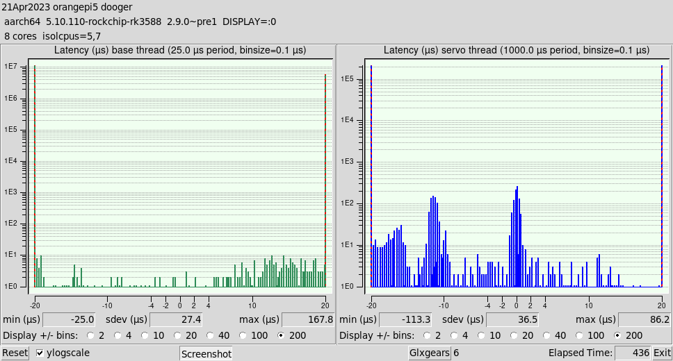

So I am not sure if the RT was a success or not after getting the Ubuntu Jammy image up and running.
I flashed the image with the flag enabled for the wireless driver, I was able to boot up though for some reason the initial user I had setup on startup did setup properly. None of the folders were generated for my home directory, and I had a myriad of permissions issues like not being able do download anything from a web browser. I was able to bypass all that by creating a new user and deleting the old one.
anyrate downloaded the wayland driver, installed the linuxcnc-uspace deb package
however I am not seeing the low latency numbers that were observed in royka's tests, least to my understanding I am not. I've attached a screen shot of the latency test while running youtube in the background. I ran cat /proc/version and didn't see anything that eluded to the fact it was a real time kernel. So I am starting to believe that the patch and config files didn't work.
Honestly I am starting to feel a little wary of Armbian. seems like a lot of hoops have to be jumped through to get it to work. The correct dtb file being absent on a fresh build, the user profile being bad on the first startup. I don't think I had this many issues when I did an raw Arch install on my laptop.
Anyrate downloading the Debian image royka provided. I'll give that a crack. But I am starting to not be as optimistic with this distro.

most probably you lose th RT patch, it happens also to me simply with APT UPGRADE.. but I patched again with deb files generated.
Now I have a image well done, latency OK, vnc working, all ok except wifi, this no way.. but for the rest it's ok.
I have a USB AC1200 and a Cisco USB and I tried to configure in menuconfig most of board present but some of them doesn't allow to build,
what I have enabled doesn't make the USB adapter working..
Now I have 2-3 days out, next week I will try again.
It's really enough to enable the driver in the menu config or there is a kind of service that should be enable as well?

@kanuboy13b Like Guglielmi said possibly you've upgraded the kernel. To prevent this from happening:
sudo apt-mark hold linux-image-legacy-rockchip-rk3588
The hoops with Armbian is because we're using an unsupported kernel, but you're free to build your rt arch system. I've tried arch a few times, it's not for me, too much hassle to make basic things work.

The build system has a lot of issues with their recent migration to their new build system, I went on holidays to Bali and we decided do give it a break for a while so he could get some of his work into mainline before resuming. I have some more pressing projects to complete right now.
The user build system is very powerful, and pretty well documented. If you are building a kernel now, you should be able to apply all your kernel config and patches in the userpatches folder for your architecture and kernel version. That is not created until you do an initial build. Use a custom config file to lock in your build parameters. I would try to use their EDGE branches and build Debian Bookworm because linuxcnc-uspace is in the Bookworm repos.
You don't need to build an image with a graphical environment as you can install that on the device from the repos. It adds a lot of time in the build system. Likewise once you can boot into Armbian (even non-rt will do), you can just build the kernel debs and copy them over and install with dpkg -i
You can check latency with cyclictest from the command line (sudo apt install rt-tests) and only install xfce and linuxcnc once you can see a reasonable result.
Hope that helps...
