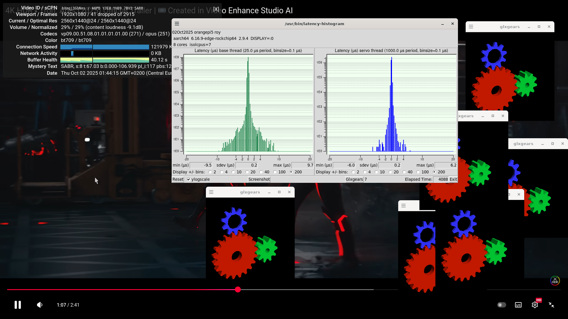

- royka
- Posts: 383
- Thank you received: 135
01 Oct 2025 15:56 #335668
by royka
Replied by royka on topic Can the OPI5 be Configured to Run LCNC?
Hi, Here you can find a few rt-kernels:
drive.google.com/drive/folders/1JglCIPKv...roZcjOvr?usp=sharing
With the 6.1.115 kernel I'm still experimenting a bit to get full gpu acceleration, I think the 6.1.75 is a more safe choice. Then find/create an image from Armbian for example, install the kernel and the dtb of the same kernel version. Check /boot if the symlinks are correct, sometimes when it creates a new initramfs creates a link to the older version, so better to delete or move the other kernel versions to a another place.
With Armbian: when you choose for an image with Debian it's more easy to install LinuxCNC but you probably won't have VPU acceleration (1080p/1440p still works fine though)
With Ubuntu it's more easy to have VPU acceleration, but you'll have to compile LinuxCNC yourself (there's a manual).
With the mainline kernel you should expect that not everything works yet.
So make your choice, find download an image that fits to the kernel you want (Vendor 5.x or 6.x) or mainline. Install the kernel and dtb if it's not exact the same version.
For better latency values isolate the last core (isolcpus=7). With Armbian edit the extraargs line to add the kernel parameter:
sudo nano /boot/armbianEnv.txt
extraargs=cma=256M isolcpus=7
ctrl+x and press y following an enter to save.
In Debian to install linuxcnc:
sudo apt update; sudo apt install linuxcnc-uspace

04 Oct 2025 02:12 #335806
by royka
For those who like it, I've got an Armbian image ready with Linux 6.17 Cinnamon which is ready to go.
drive.google.com/drive/folders/1_WMbZC0k...ceNNI?usp=drive_link
Last core already isolated
Included sata overlay (which had to be adjusted)
LinuxCNC installed
HDMI audio works
GPU acceleration works
VPU acceleration doesn't work in the web browsers, 1080p on YouTube works fine
IRQ of ethernet automatically pinned to core 5
LinuxCNC installed
HDMI audio works
