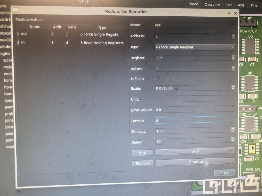

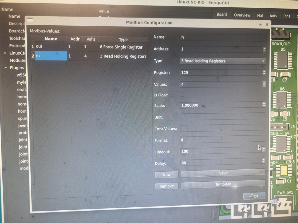

01 Feb 2025 12:14 #320320 by babinda01
Hi Guys,
I am hoping someone can point me in the right direction. I have a TangBOB board that I am trying to get a N4D3E16 MODBUS board (16 Digital In - 16 Digital Out) to work with.
This board will only allow Function codes 3 (Read Status) and 6 (Control Command).
I have all 16 inputs working well through to LinuxCNC, but I can't get the outputs to work. When I configure RIOCore to use function 6, it seems to assign it as a float, and so in the testgui it shows up as a slider.
Attached are a couple of pics of my configs and a page from the modbus boards manual.
I am hoping someone here might be able to point me in the right direction here.
Andrew
02 Feb 2025 11:45 #320404 by meister
i'll have a look at it and try to treat the values as single bits
unfortunately i don't have any test-hardware for it at the moment, but maybe i'll get something made.

04 Feb 2025 08:27 #320583 by meister
ok, until I have a better solution,
I have added a new 'type' (201 : Custom Boolean)
sample config (gui setup will not work / need to added by hand in the json config):
            "type": "modbus",
            "pins": {
                "tx": {
                    "pin": "MODBUS:TX"
                "rx": {
                    "pin": "MODBUS:RX"
                "tx_enable": {
                    "pin": "MODBUS:TX_ENABLE"
            "uid": "modbus0",
            "config": {
                "relais1": {
                    "type": 201,
                    "address": 11,
                    "on": [6 ,0, 1, 1, 0],
                    "off": [6 ,0, 1, 0, 0],
                    "timeout": 100,
                    "delay": 60,
                    "direction": "output"
"on": the bytes of the frame to switch the output on (without address and checksum)
"off": the bytes of the frame to switch the output off (without address and checksum)

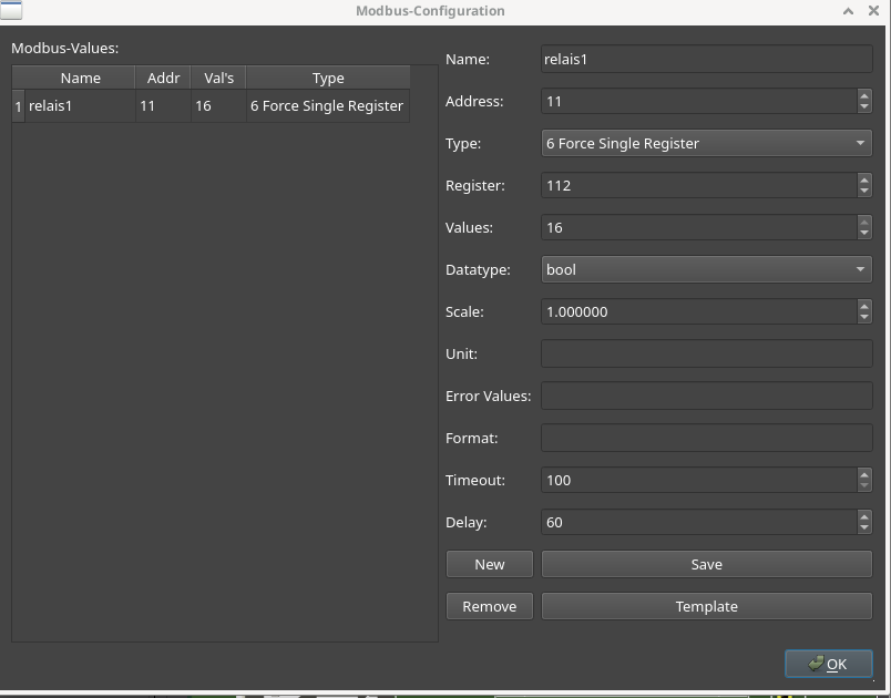

05 Feb 2025 15:53 #320759 by meister
i got my 32 relay card today and changed something in the setup, i will test everything again later.
you can now use func:6 and set the datatype (new option) to bool, as register the 112 (0x70) and Values = 16
            "config": {
                "relais": {
                    "address": 11,
                    "type": 6,
                    "register": 112,
                    "values": 16,
                    "datatype": "bool",
                    "scale": 1.0,
                    "unit": "",
                    "error_values": "",
                    "format": "",
                    "timeout": 100,
                    "delay": 60,
