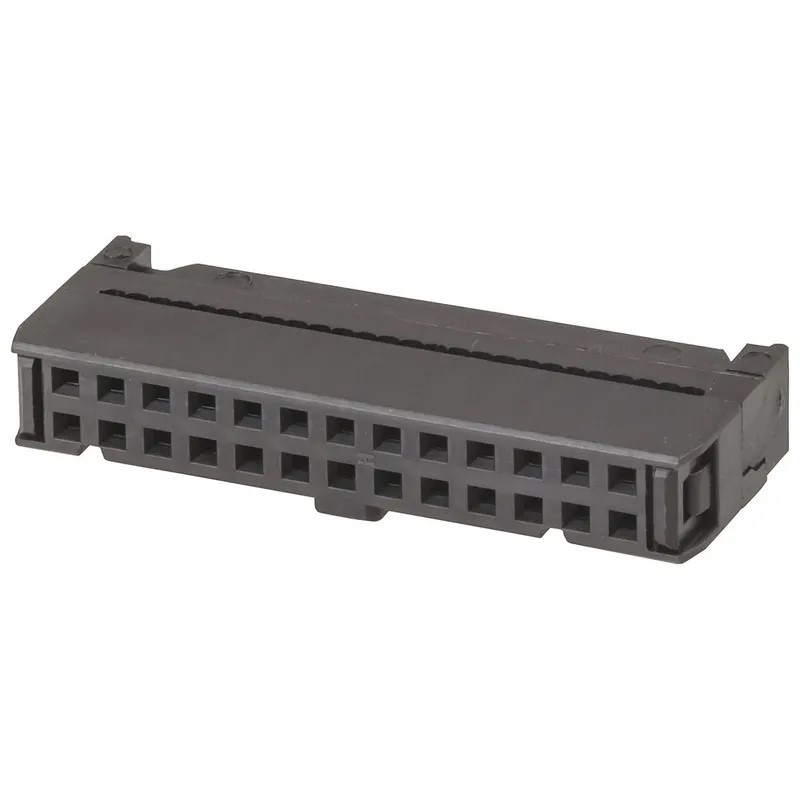

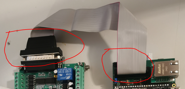

This maybe a silly question bit is there a wiring diagram for the ribbon connector of the DB25's

It's a one to one connection. Pin 1 to Pin 1 etc. The wire with the red tracer is pin 1.

I have a 26 Way IDC Line Socket from jaycar here in Sydney image is below but it has no pin numbers marked. Searched like mad but no luck. Your help will be much appreciated. The D25 IDC has numberings marked!It's a one to one connection. Pin 1 to Pin 1 etc. The wire with the red tracer is pin 1.
- Posts: 1200
- Thank you received: 426
24 Jan 2025 08:33 #319751
Replied by Cant do this anymore bye all on topic LinuxCNC-RIO - RealtimeIO for LinuxCNC based on FPGA (ICE40 / ECP5)
Plug it into the male header on the board.
Where it aligns with Pin 1 on the board, that will be Pin 1.

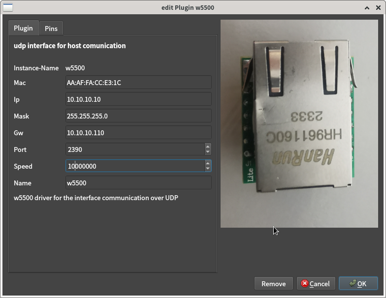

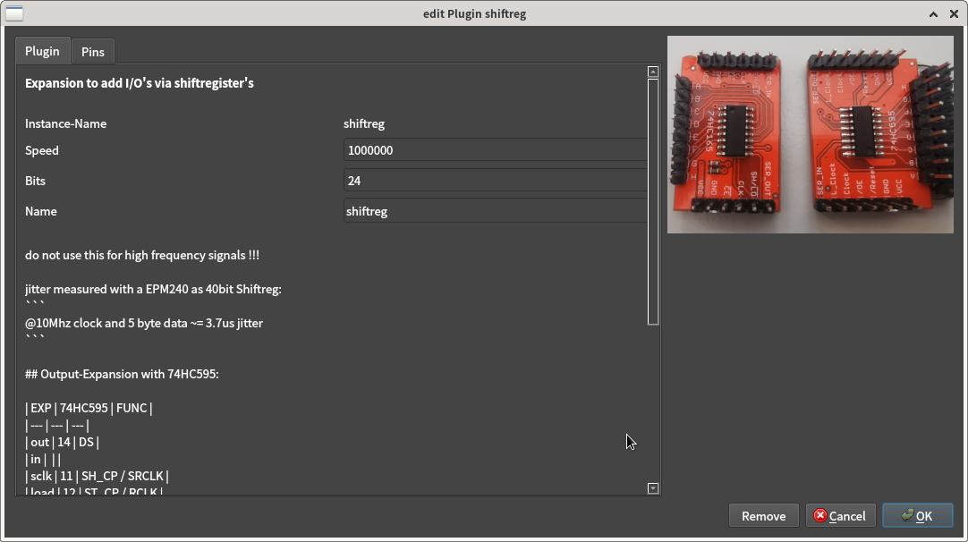

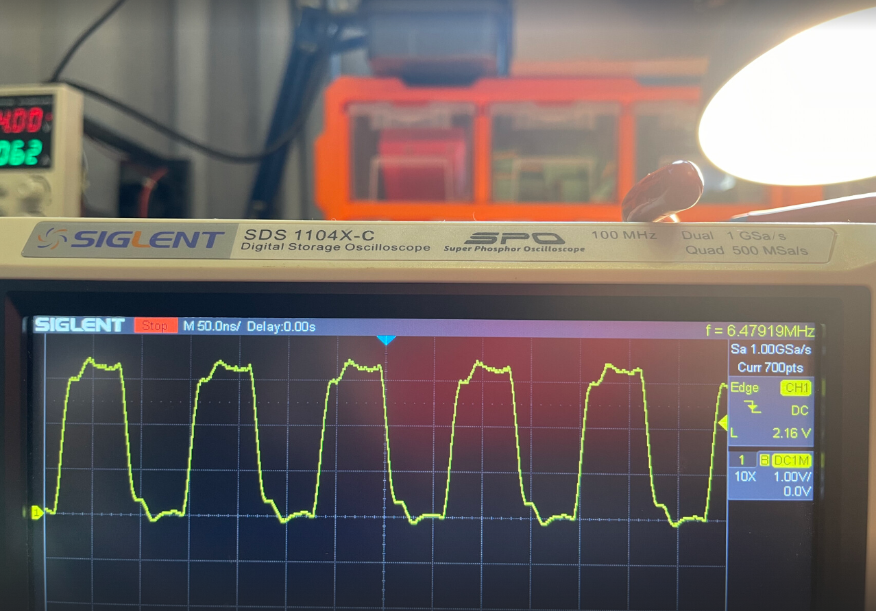

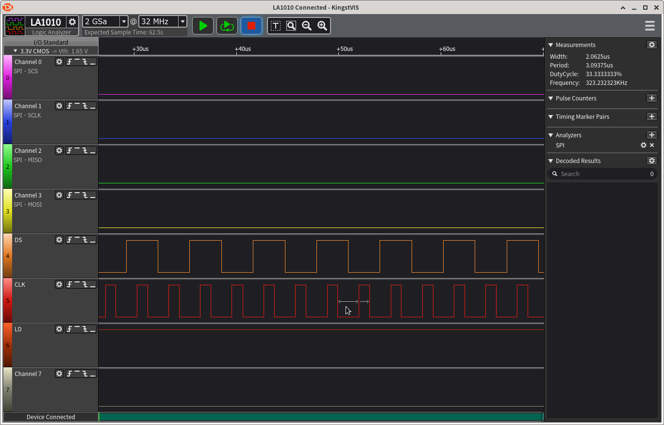

Hi Tim,
your measurements are correct,
the code is wrong
I have fixed the shiftreg plugin,
but the 6.4Mhz of the w5500 are correct,
more is not possible with the ice40up5k on 30Mhz clock.
Thanks !
the code is wrong
Thanks !

and I have a promblem about w5500 spi clk:
I tested the joint.n.f-error seem biger than mesa card,
my PID is: P=1000 I=0 D=0,when i jog x axis,the joint.0.f-error is about 0.05mm
if i set P=0,I=0,D=0,when i jog x axis Exceed about 800mm,the "joint 0 following error" pop up(I set FERROR=3)
The difference between the feedback value and the command value is getting bigger and bigger
I know when i used a low speed run the axis,the f-error is good for me, I'm just a little curious, it's related to the spi clock?
Tim
Thanks for your reply.
I will test that later.thank you very much
Tim
