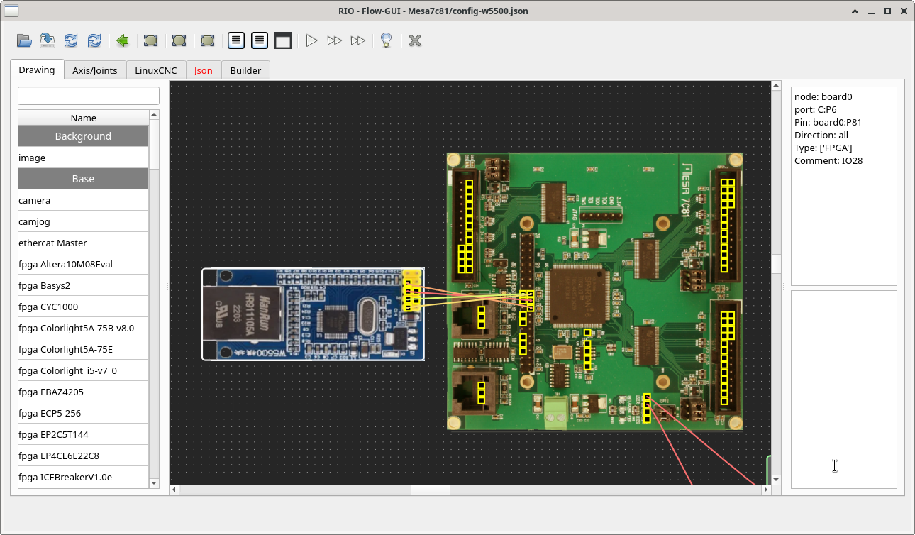

Could you please explain how you connect the 7c81 via ethernet?

23 Mar 2026 11:14 #344628
by meister
Replied by meister on topic LinuxCNC-RIO - RealtimeIO for LinuxCNC based on FPGA (ICE40 / ECP5)

23 Mar 2026 12:37 #344633
by hitchhiker
Replied by hitchhiker on topic LinuxCNC-RIO - RealtimeIO for LinuxCNC based on FPGA (ICE40 / ECP5)
Ahaaa i have laying a 7c81... i use on my rpi4 a 7i92.
