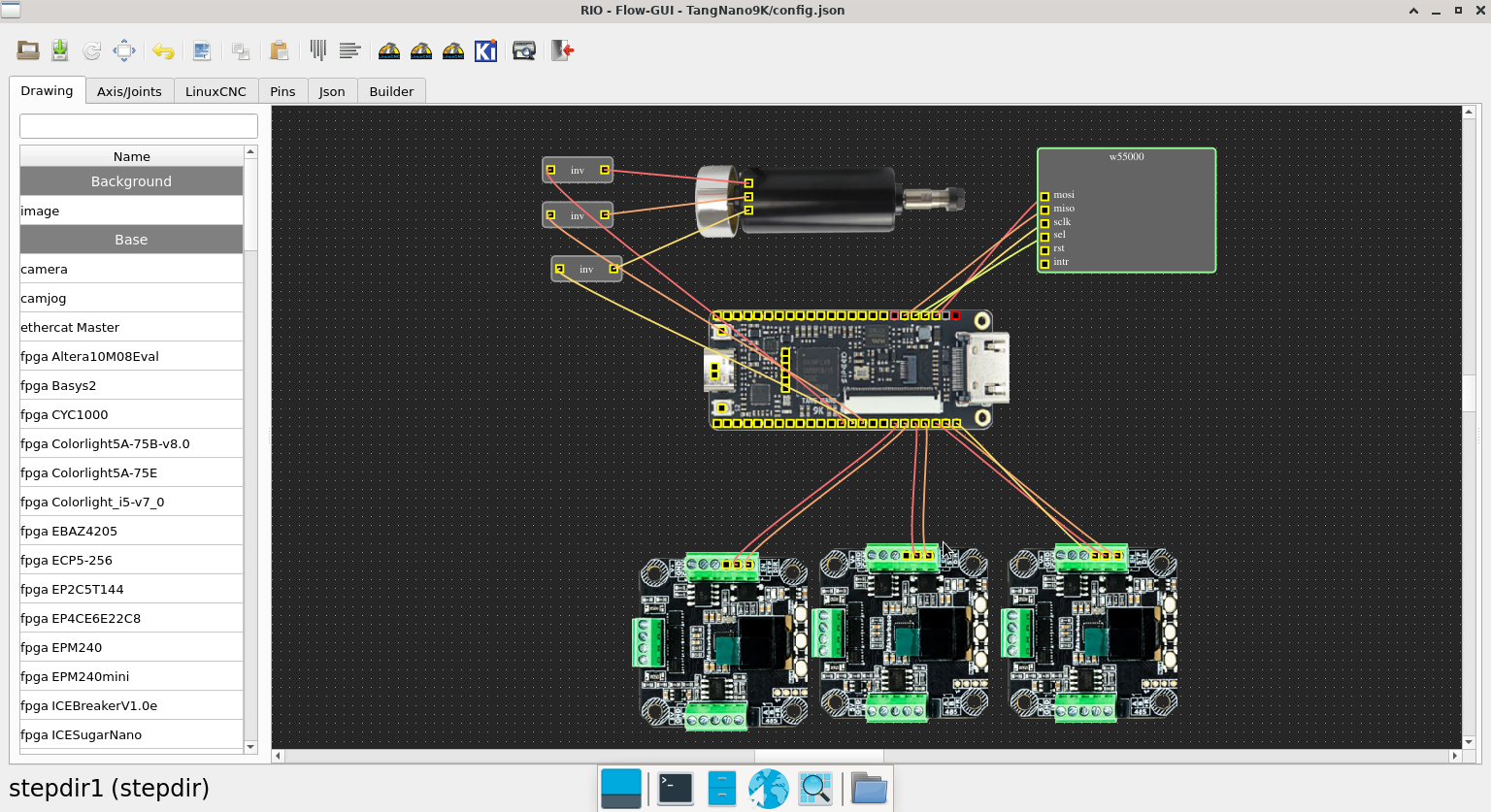

I use ./bin/rio-flow riocore/configs/TangNano9K/config.json
The automatically generated ini and HAL files cannot output a 1kHz PWM spindle signal. Do I need to edit the HAL and ini files myself to output the spindle PWM signal?

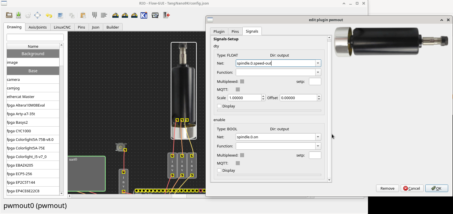

31 Jul 2026 04:49 #348262
by meister
Which interface are you using, and where do you want the PWM output to be?
To use the spindle in LinuxCNC, you still need to configure it in the “Signals” tab.
dty/net = spindle.0.speed-out
enable/net = spindle.0.on
@all WARNING: Serial/USB does work, but it's really just for testing;
I wouldn't use it in a production environment.
Replied by meister on topic LinuxCNC-RIO - RealtimeIO for LinuxCNC based on FPGA (ICE40 / ECP5)
What does your setup look like?I use ./bin/rio-flow riocore/configs/TangNano9K/config.json

31 Jul 2026 12:23 - 31 Jul 2026 16:00 #348282
by viewsat
Replied by viewsat on topic LinuxCNC-RIO - RealtimeIO for LinuxCNC based on FPGA (ICE40 / ECP5)
Last edit: 31 Jul 2026 16:00 by viewsat.

31 Jul 2026 12:24 #348283
by meister
i only see the screenshot
