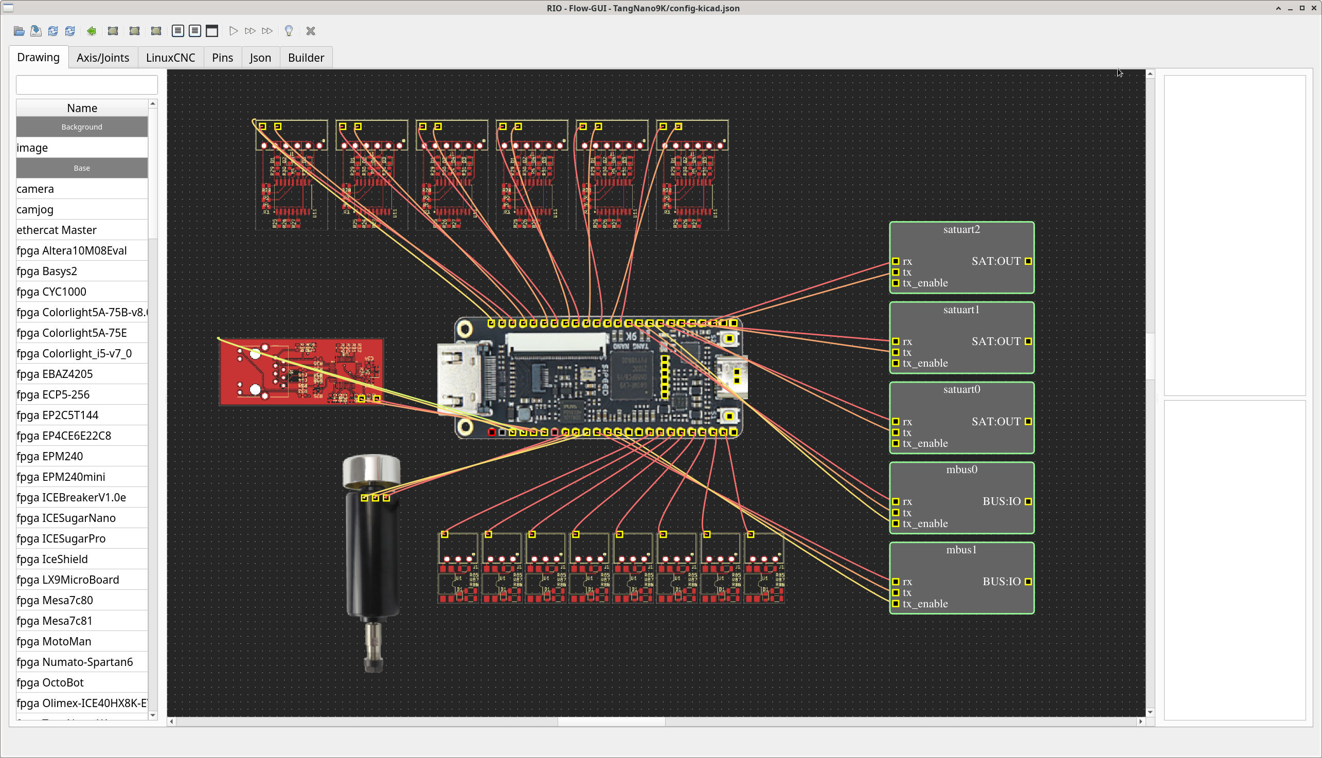

### Gui
* new graphical config-gui: rio-flow
* removing old rio-setup
### Genaral
* move all stuff into plugins (boards/modules/breakouts)
* replacing modbus -> mbus/mbus_device/mbus_hy
* replacing i2cbus -> i2c/i2c_device
* better simulation
* test-tool is now based on the hal-component c-code

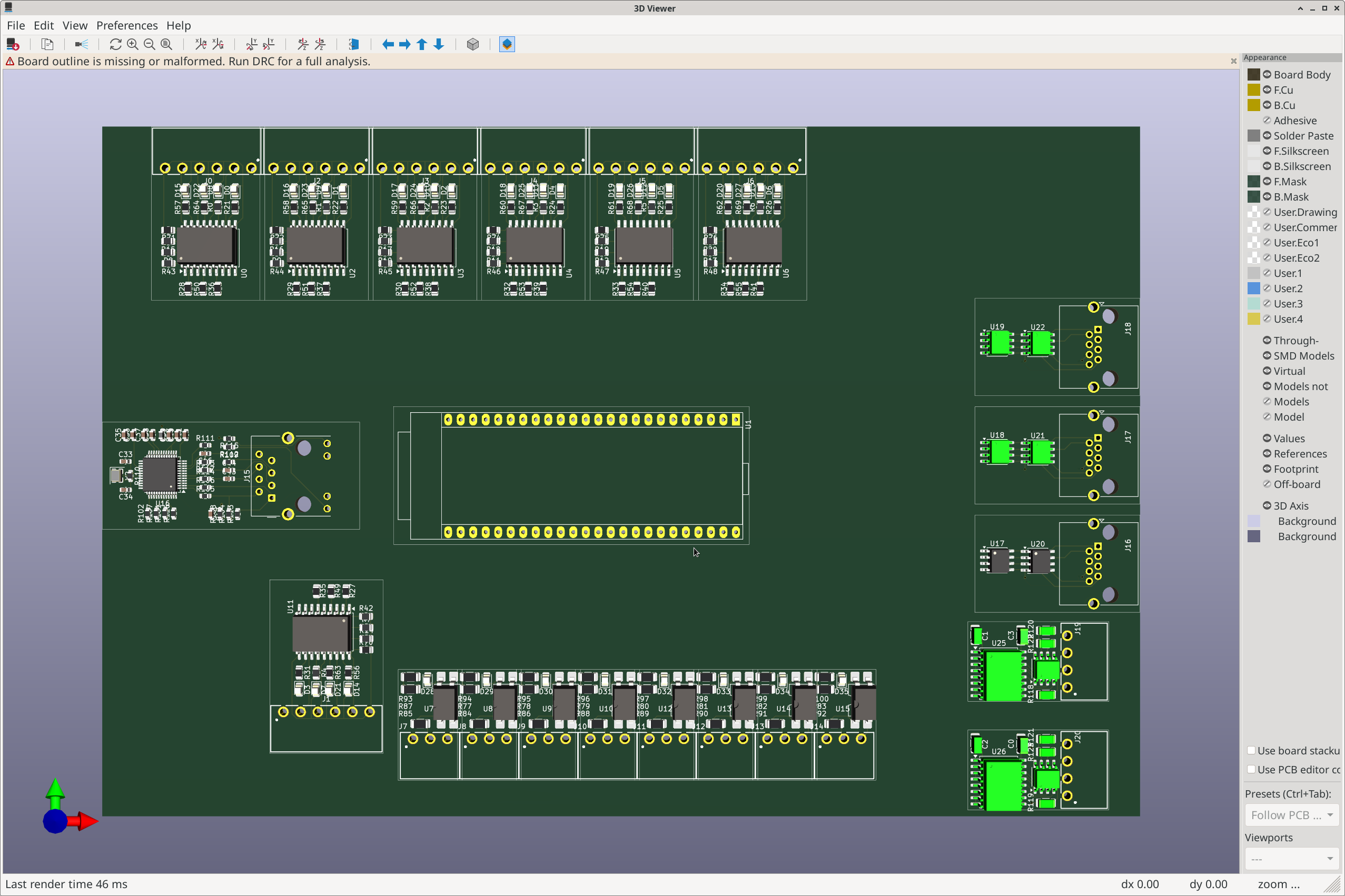

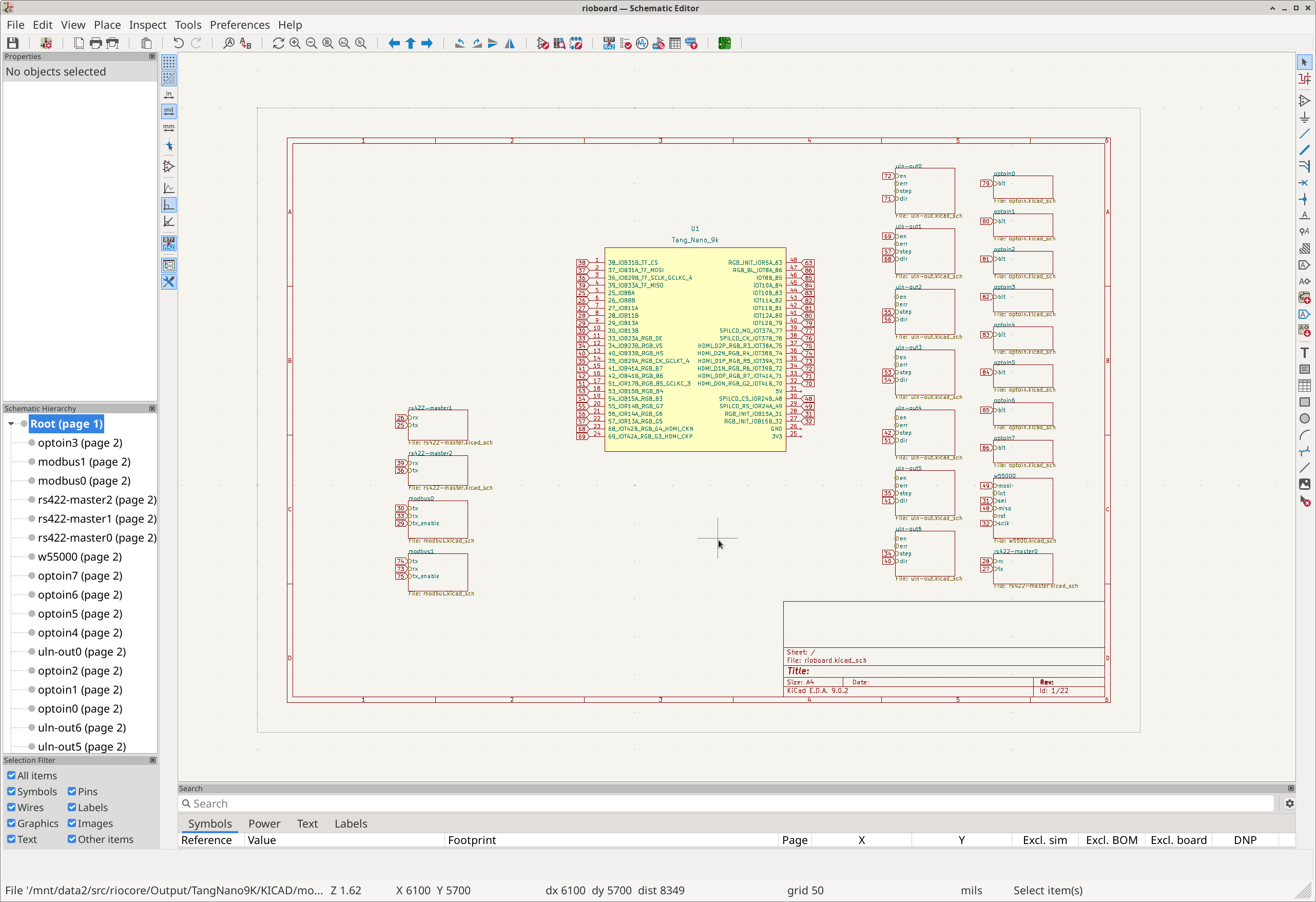

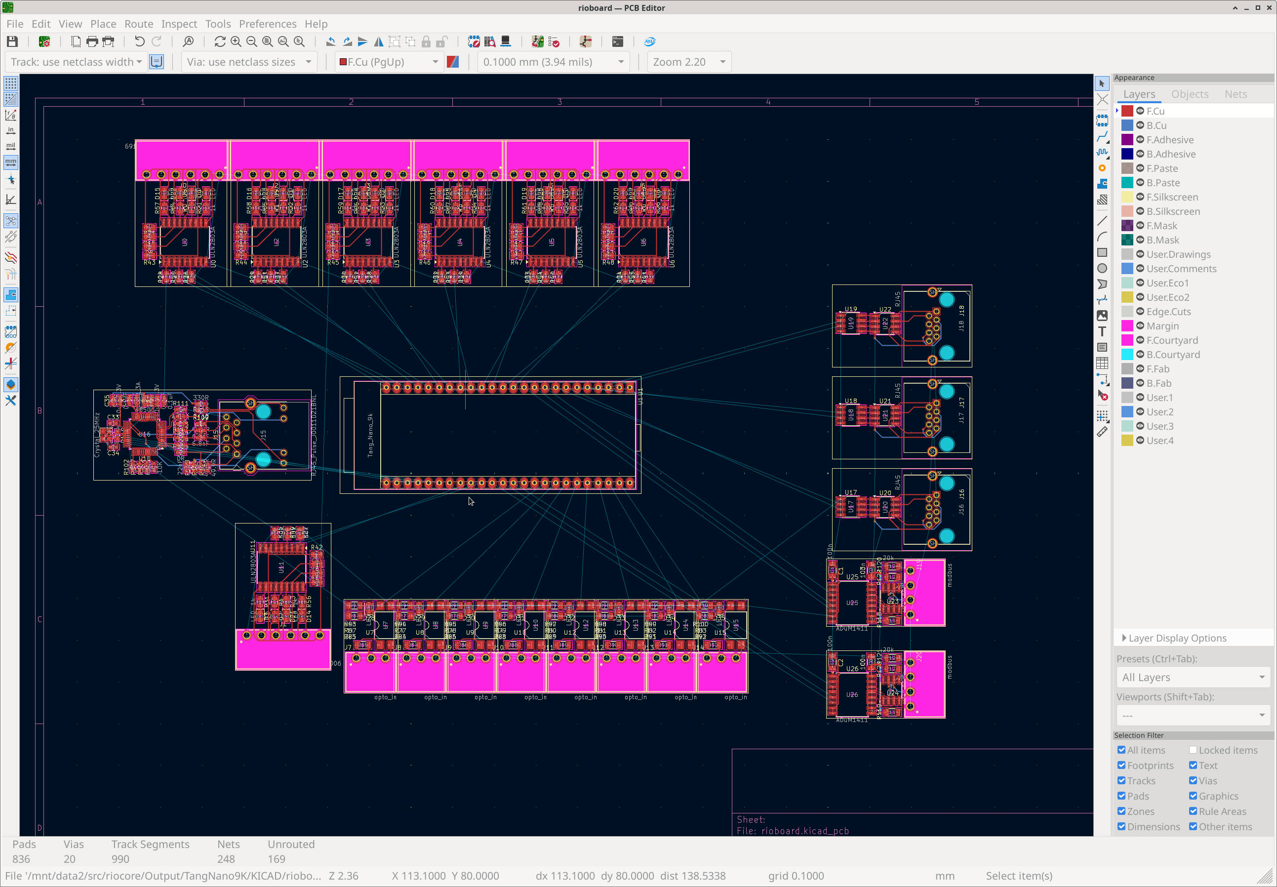

It should be noted that Riocore can generate the gateware for the FPGA, as well as the complete LinuxCNC configuration (hal/ini/vcp).
In future, however, it will also be possible to build your own boards from this;
to this end, a KiCad template is generated, which can be turned into a complete board with relatively little effort.
already in dev branch, but still need some work:
* verify the kicad modules
* add more kicad modules
* some fixes while update the pcb

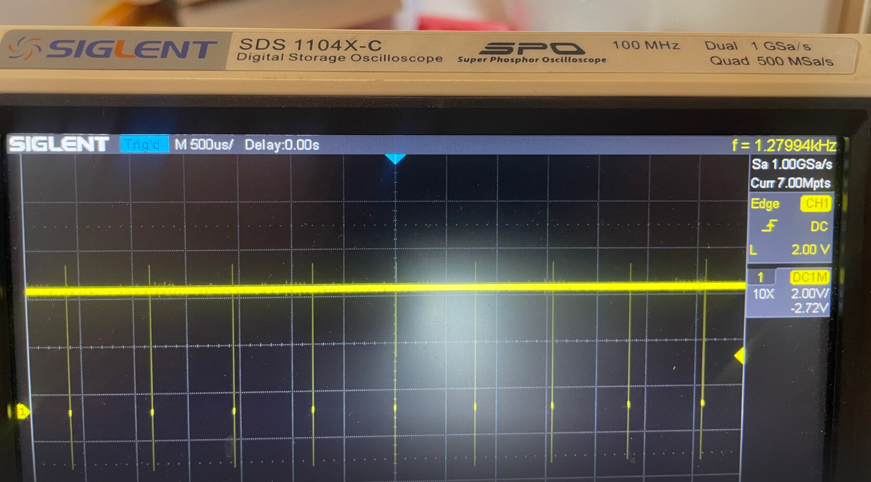

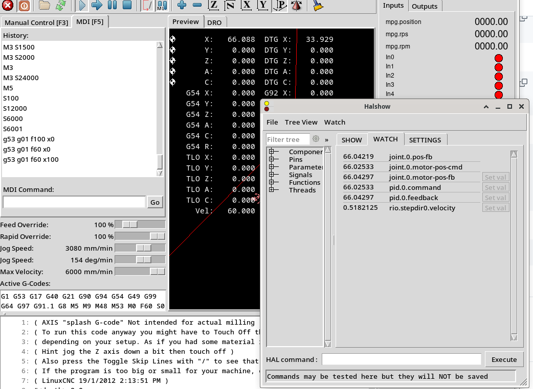

Dear meister:
I used MDI command to move x axis for a example. The velocity is 60mm/min, and used halshow to watch pin:rio.stepdir0.velocity
the value is about 0.5mm/s, but the motor run in right speed,and I probe the x axis's pules signal used a oscilloscope
and it show the freqency is about 12.78khz, my scale is 1280 in .ini file
if I use stepdir to drive a servo motor to run a spindle, I net the spindle rps to some one stepdir.velocity then spindle run in a wrong speed
whitch parameter I set wrong?
Tim

The only parameters that affect the frequency are
* stepdir0.velocity
* stepdir0.velocity-scale
* stepdir0.velocity-offset
and the FPGA clock frequency
Could you please attach your .json file?
* stepdir0.velocity

meister:
my json file
and sorry about the frequecy I write wrong: when command is :G53 G01 F60 X100output pules frequency is about 1.28khz
because my scale is 1280, when F60 (1mm/s), output frequency is 1280 * 1 = 1.28Khz
the stepdir.velocity is show about 0.5mm/s
Tim
my json file
