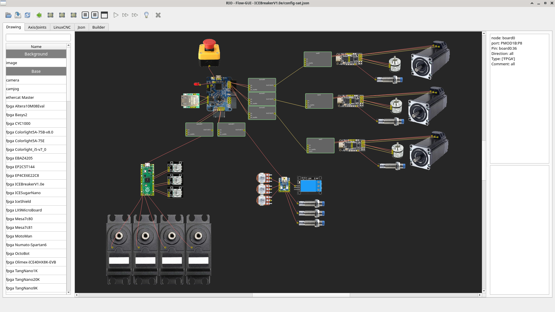

Thanks.
at the moment, i rewrite the riosub stuff in the dev branch and the riosub plugin will be removed in the next release.
it will be replaced by uartsub+uart/satmcu (i need other names for that plugins, something with 'satellite').
The reason is that you can then edit everything in one configuration and thus always have the overall picture in front of you.
Then you can also use microcontrollers as satellite-board and configure them in the Flow GUI.

Oh very nice, one of those micro's look like the waveshare 2040zero and the other a pi pico? I have been playing around with using the pico, probably a 2350b with 48GPIO as an expansion port via SPI and using a SYNC pin from the nano to take snapshots at 1KHz intervals to keep readings accurate for encoder positions. The Pico's are awesome for this kind of work, serious cheap hardware. I also plan to use Tang to SPI to pico bus topology for expansion boards, mainly IO, if I want step/direction I will try RioSub, most of my machines are closed loop to the controller so only pwm/dir to Hbridges, but I have friends that want to use step/dir with commercial drives. I will test this on my own machines, let me know if you want anything specific for me to test.

What comms layer are you thinking for data between the FPGA and MCU? You mention rs422, so I assume high bandwith serial over differential driver? I was going to use SPI with included SYNC signal for timing integrity but serial will use two FPGA pins and a differential driver instead of my scheme that will use 5 pins. I love the Tang Nano, cheap, and great toolchain. If I could keep using it then life would be good, pin count is it's worst enemy!

yes, at the moment i play with 1Mbit over RS422-Drivers and the exsisting uart plugin, i allready test 2.5Mbit without problems between two FPGA's.
The protocol is the same generated like between FPGA and PC plus checksum for serial.
Since only the bare minimum is transferred, the delays are extremely small.
the Firmware generator supports RP2040 (incl. waveshare zero) and ESP32 MCU's
based on Arduino toolchain, but you can use the interface stuff (pure c) for other controllers and own drivers that rio can not generate as a template.
I used RS422 so that simple cables (network/RJ45) can be used to bridge longer distances without any problems. This means, for example, that the step/dir generators can be attached directly to the motor if they have built-in drivers.
I am currently testing an MPG based on pico, which is also connected via RS422 (including power supply).
