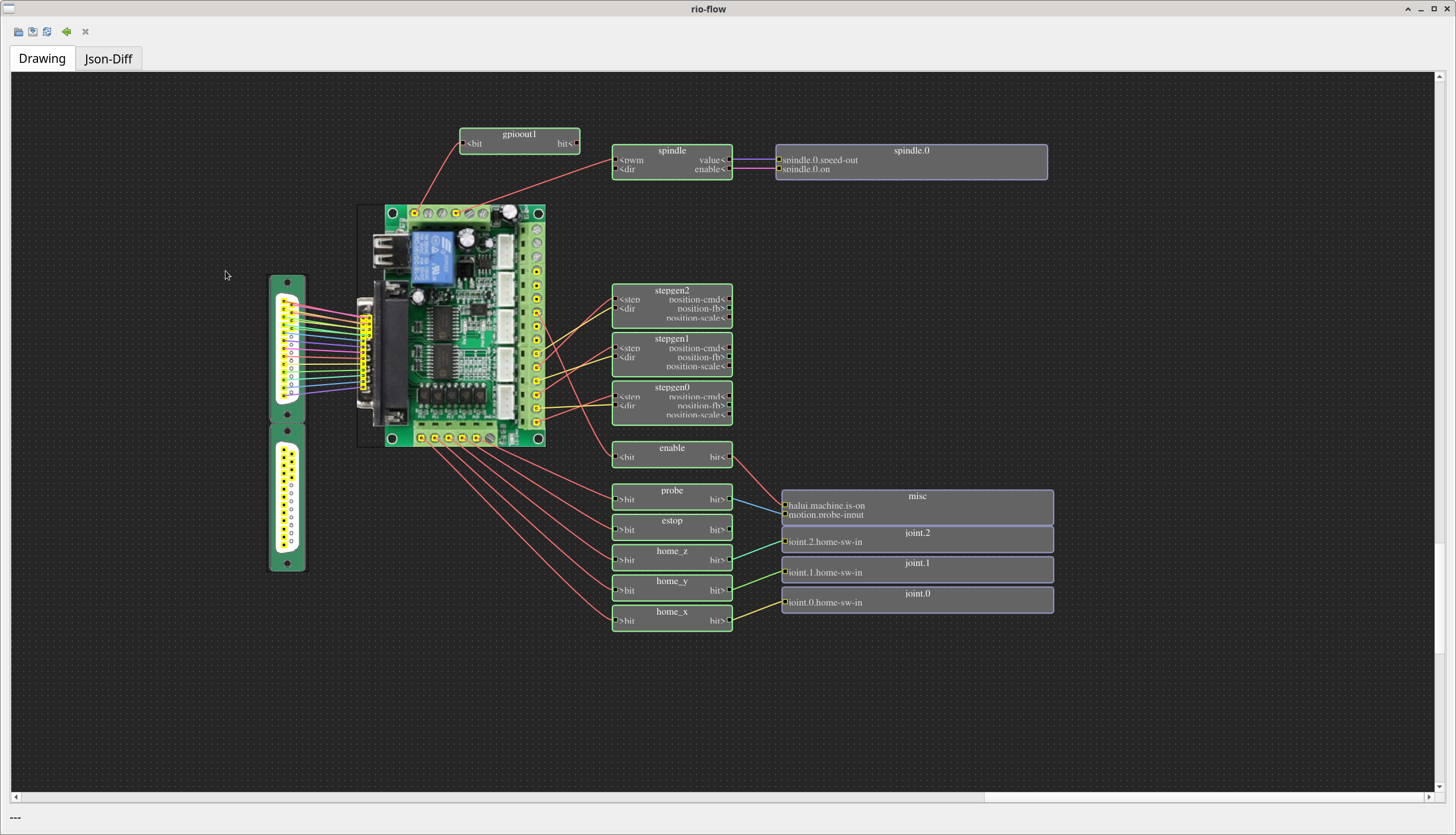

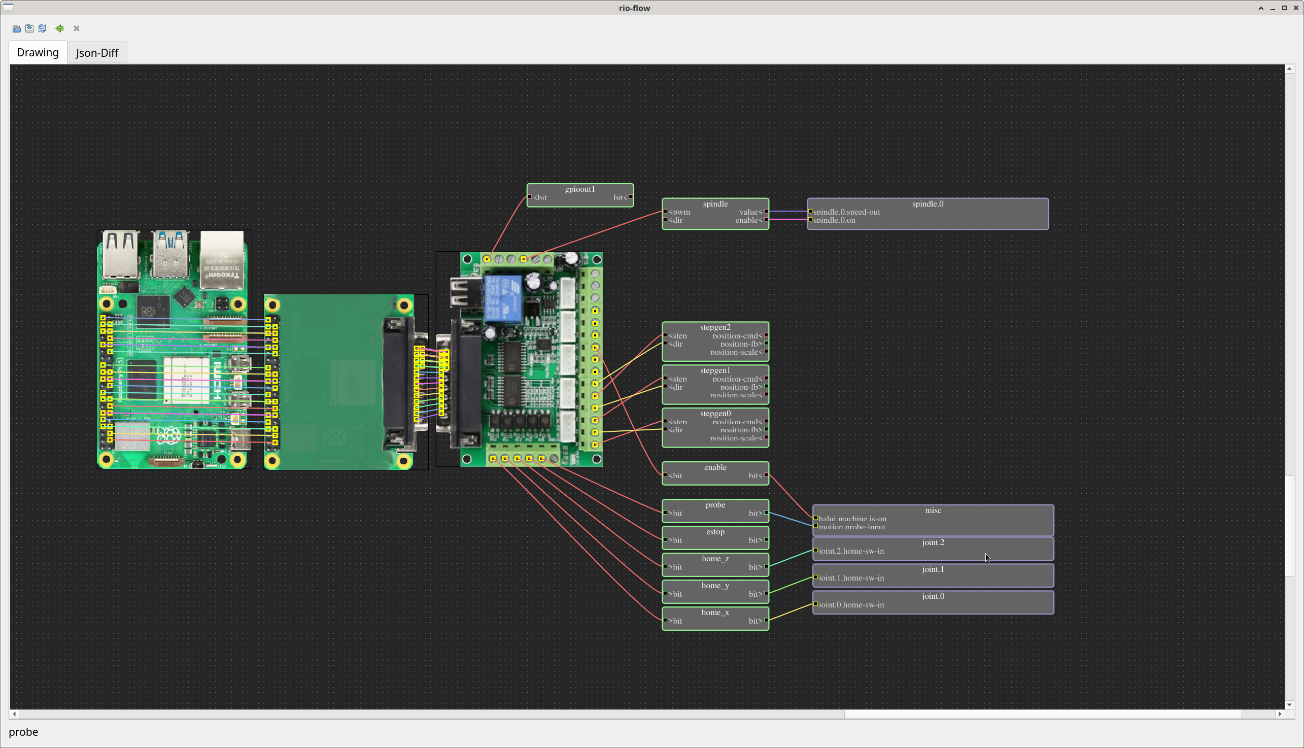

That makes it easier to imagine
It should now also be possible to mix FPGA and RPI/Parport configurations.
Oh, there's a new I2C plugin for the Raspberry with pcf8574 and ads1115 support (digital IO + analog inputs / non-real-time).

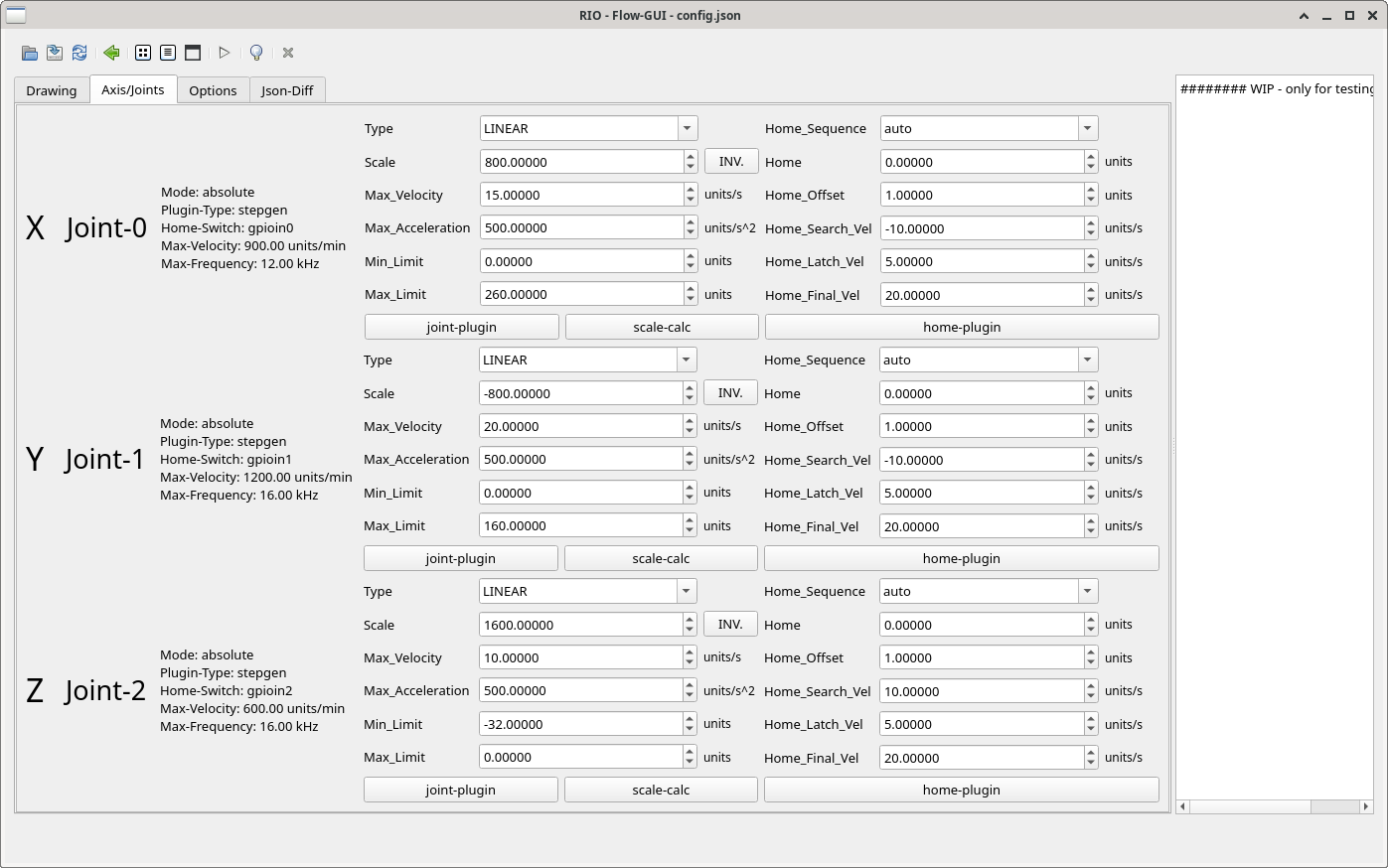

Awesome, those new tabs look great, the invert button on the scale is a nice touch.
Russell.
Russell.

I'll second that.
Top work
