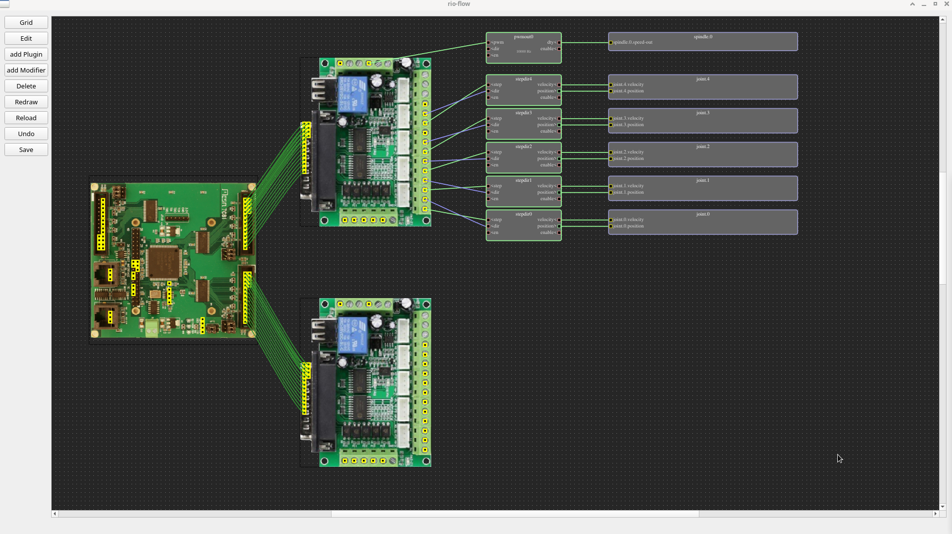

There is now support for a Mesa board: eusurplus.com/index.php?route=product/product&product_id=131
It can be used via RPI over SPI and over Ethernet via W5500
There are also developments in the new configuration front end, but it is still far from complete.
PS: Many thanks to EUSurplus for their support!
Best regards, Olli

19 Aug 2025 12:37 #333670
by mBender
Replied by mBender on topic LinuxCNC-RIO - RealtimeIO for LinuxCNC based on FPGA (ICE40 / ECP5)
I am successful and fully transition from my old Parallel Port PC to an I7 Laptop with Riocore! Finally I am able to browse something without waiting forever
Thanks Olli! This is great stuff.
I have my
- whb04b-06 Hand wheel operating
- Classic Ladder with RS 485 Modbus working (over an dedicated RS485 USB Dongle)
- Auto squaring Y Axis
- Touch plate/Probe input
It was not terrible, but I feel like I have modified a lot of ini and hal files which were created automatically to make this work. Is there a way that you could add a checkbox or so to ricocore gui to not overwrite the existing config files?
I don't know what the best workflow would be. I think if I want to add another function to the FPGA i I will just do it in a separate folder and flash the FPGA, then add the changed manually to my machine folder ?!?
I have my

20 Aug 2025 07:07 #333716
by meister
Replied by meister on topic LinuxCNC-RIO - RealtimeIO for LinuxCNC based on FPGA (ICE40 / ECP5)
@mBender
You can simply copy the directory and use it, then enter the updates. It's the same as a ‘do not overwrite’ switch.
If you send me your configuration and your edited files, I can see if there is a way to integrate this into the json-configuration.
