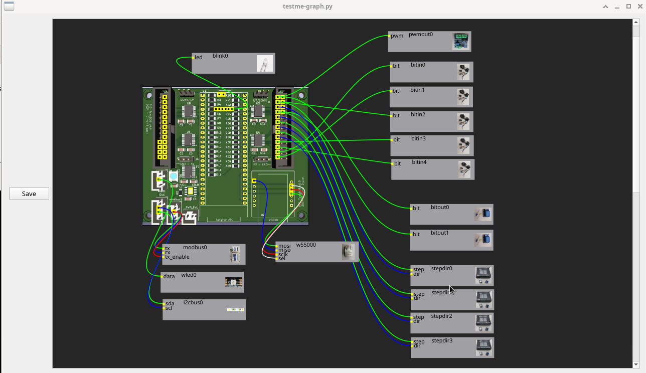

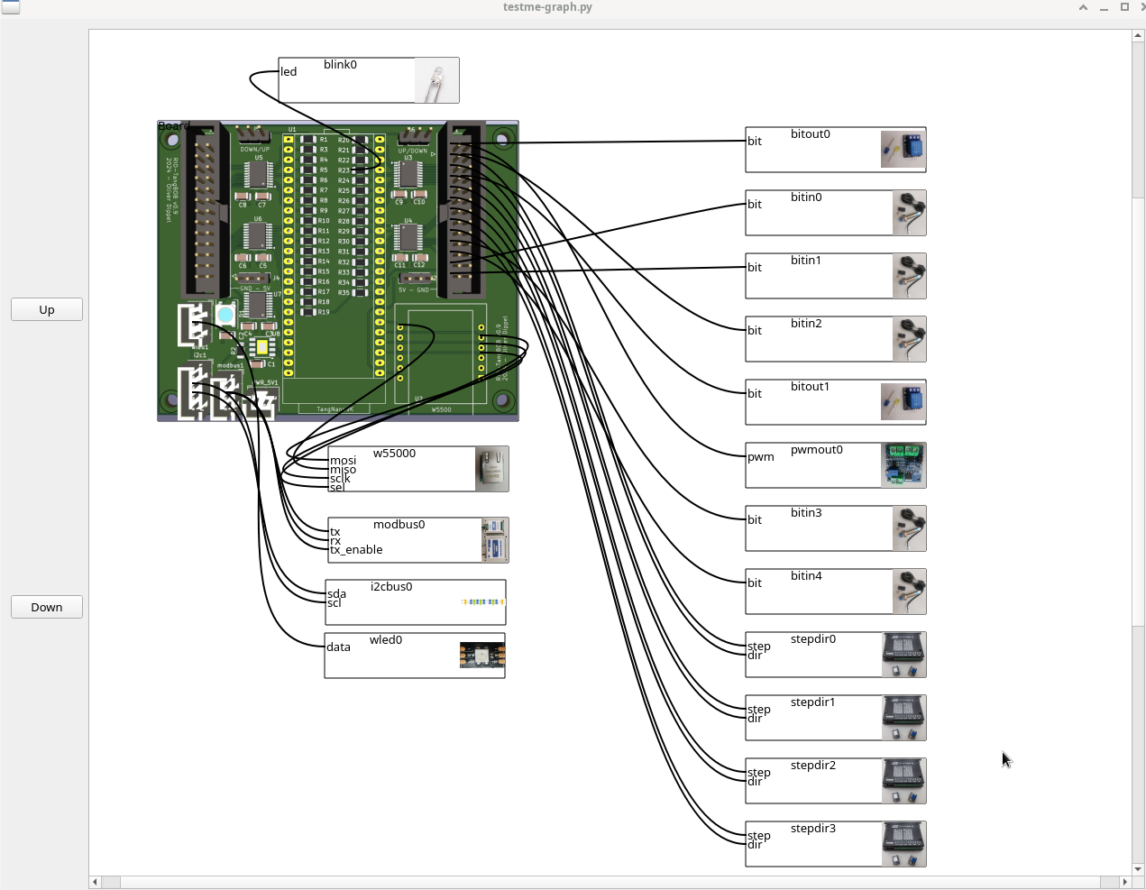

thanks, but still a lot of work to do (At the moment it is still a proof of concept):
here is the latest source file:
www.multixmedia.org/testme-graph.py
# python3 testme-graph.py riocore/configs/Tangbob/config.json

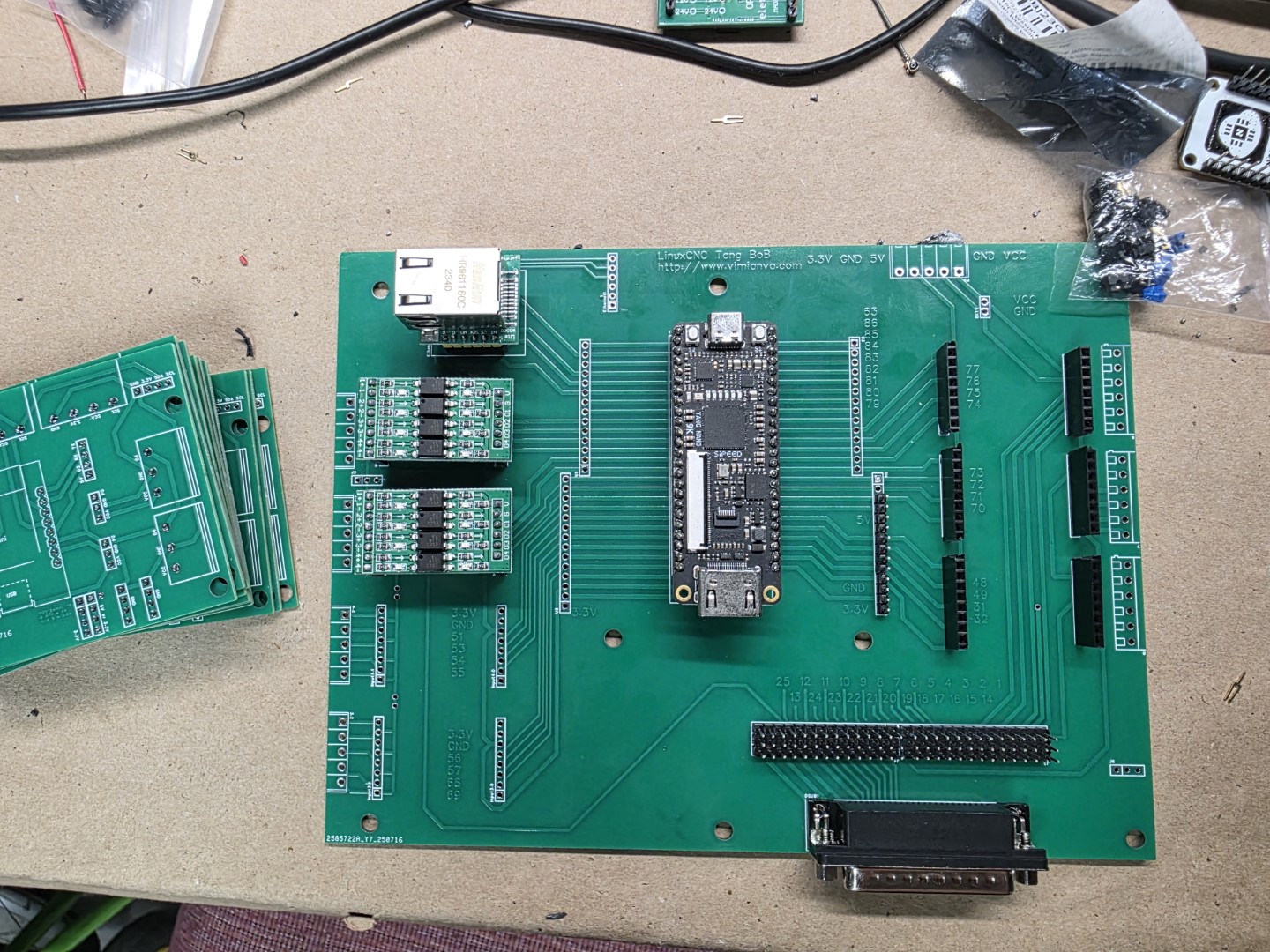

JCLPCB delivered my self made PCB board. Testing ongoing. I had to order 5 boards. If anyone is interested in one, I have a few spares. Located in the Florida USA.

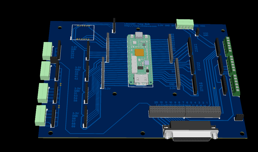

little preview

Replied by mBender on topic LinuxCNC-RIO - RealtimeIO for LinuxCNC based on FPGA (ICE40 / ECP5)
Put my PCB together! It works! Very happy to have moved on from breadboard to something more reliable!
