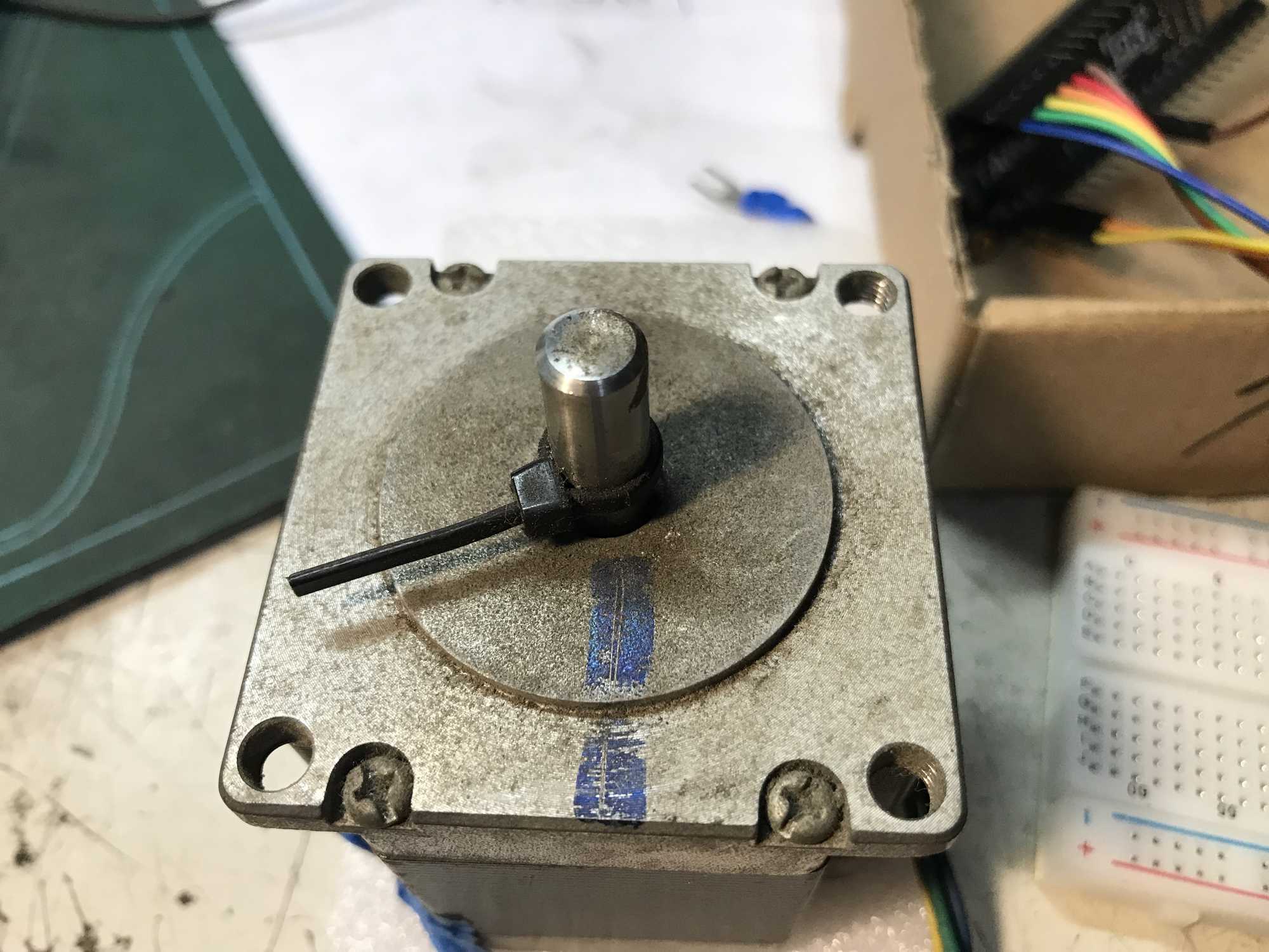

My tests on both the ICEBreakerV1.0e and Tana Nano9k yielded the same results, not due to the FPGA brand, noise, or settings.
I noticed that the Dir PIN output returns to its original position after the step action is completed. This may be because the DIR operation is not yet complete, but the STEP operation occurs prematurely, causing an error.

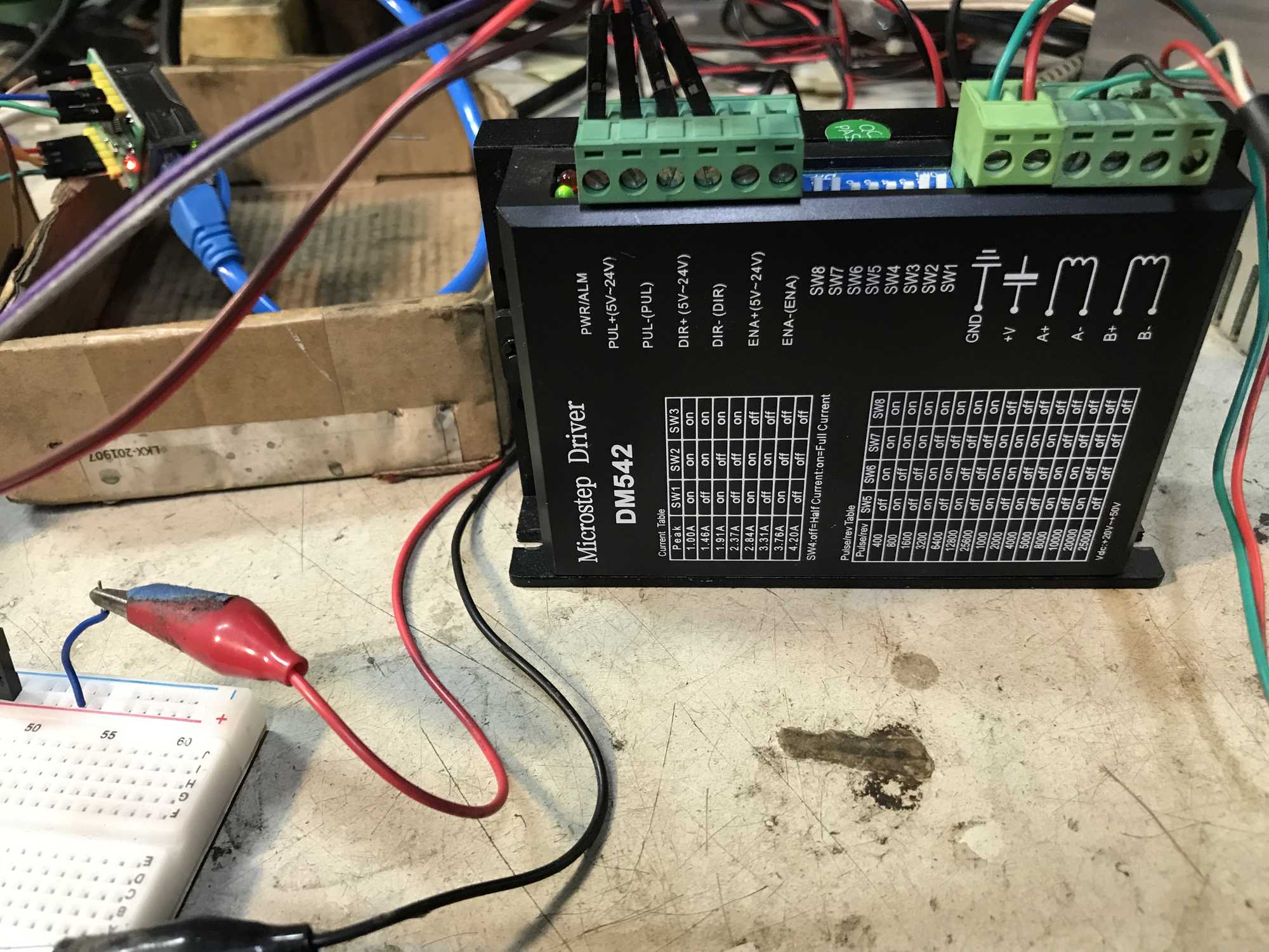

I tested with the Branches dev from GitHub and the Tang Nano 9k, but the motor still couldn't return to the zero position after stopping. You must use the same DM542 stepper motor driver to reproduce this problem.

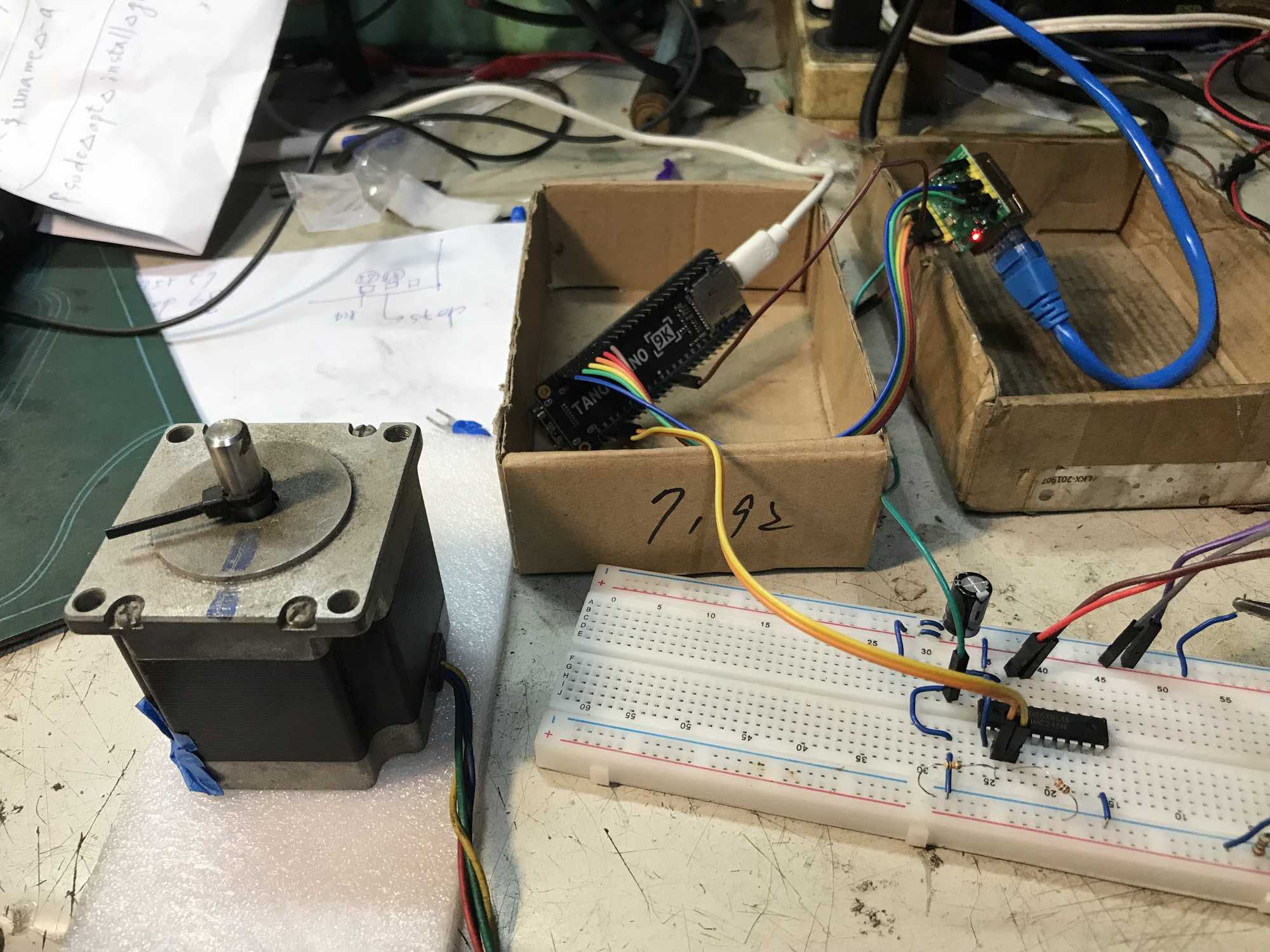

1. try other pins, looks like you are on two of the HDMI pins (there are filters on the board)
2. set an inverter/modifier to the step pin: (Pins -> Step -> Modifier + -> invert)
3. check that Pulse_LEN and Dir_Delay set to default (4.0 / 0.7)
I have several machines running on this, and there are a few other users as well, all with different drivers and motors; so far, it’s always worked.
EDIT: what is on the breadboard ?

1. I will try other pins.( tests on both the ICEBreakerV1.0e and Tana Nano9k yielded the same results)
2. I will set an inverter/modifier to the step pin
3. Pulse_LEN => 10us and Dir_Delay => 25us
4. There is a 74HC245 on the breadboard.

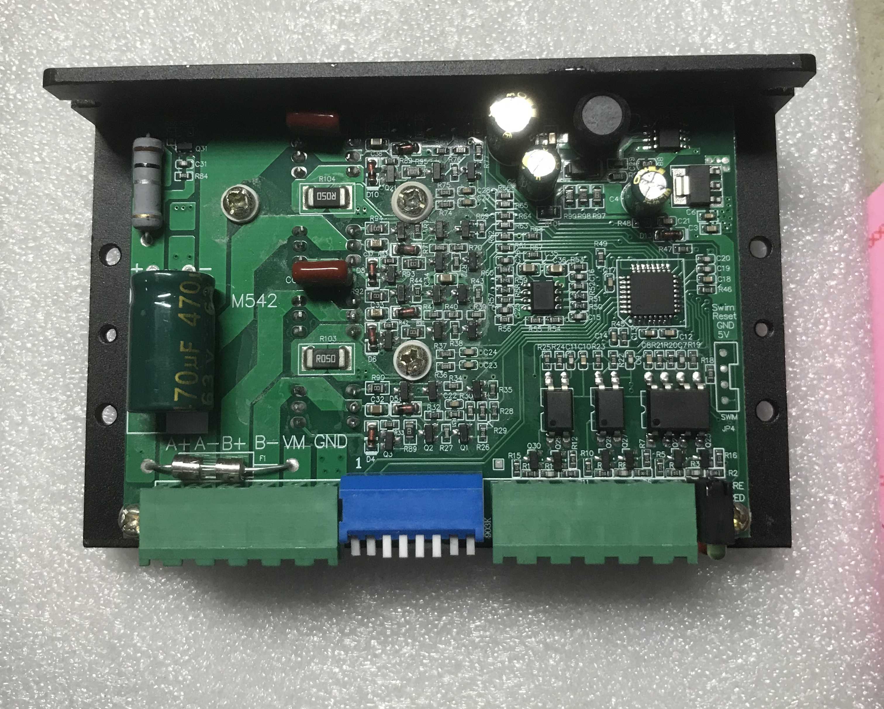

I have used many DM542 stepper motor drivers (see the photo above), and no problems when using GRBL and 7i92.
