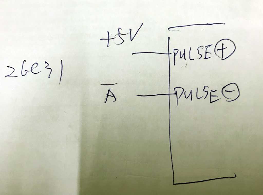

If this is a drive level issue, note that a 26C31 does not swing to 5V
and its output level is about 2 diode drops below 5V (3.6V) with a 5 mA load.
I connected the motor driver using +5V and A-.

15 Aug 2026 10:17 #348772 by PCW
Yes, connected that way you would get close to 5V drive.
The issue with the 26C31 is that the high level drive does not swing to 5V
but the low level drive does swing close to 0V.

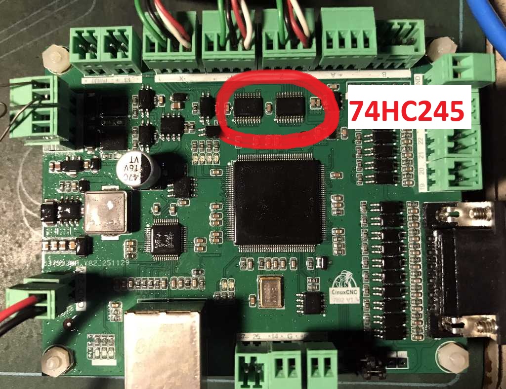

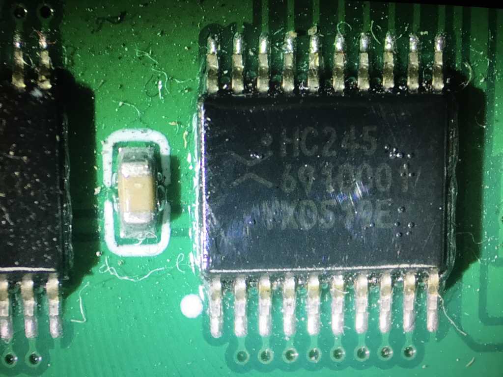

15 Aug 2026 20:25 - 16 Aug 2026 07:20 #348781 by viewsat
The Linux CNC FPGA control board I bought connects to the motor driver, and it works perfectly with the 74HC245.
There is no problem connecting the DM542 using the 74HC245.
The FPGA (3.3V) is directly connected to the 74HC245 (5V).

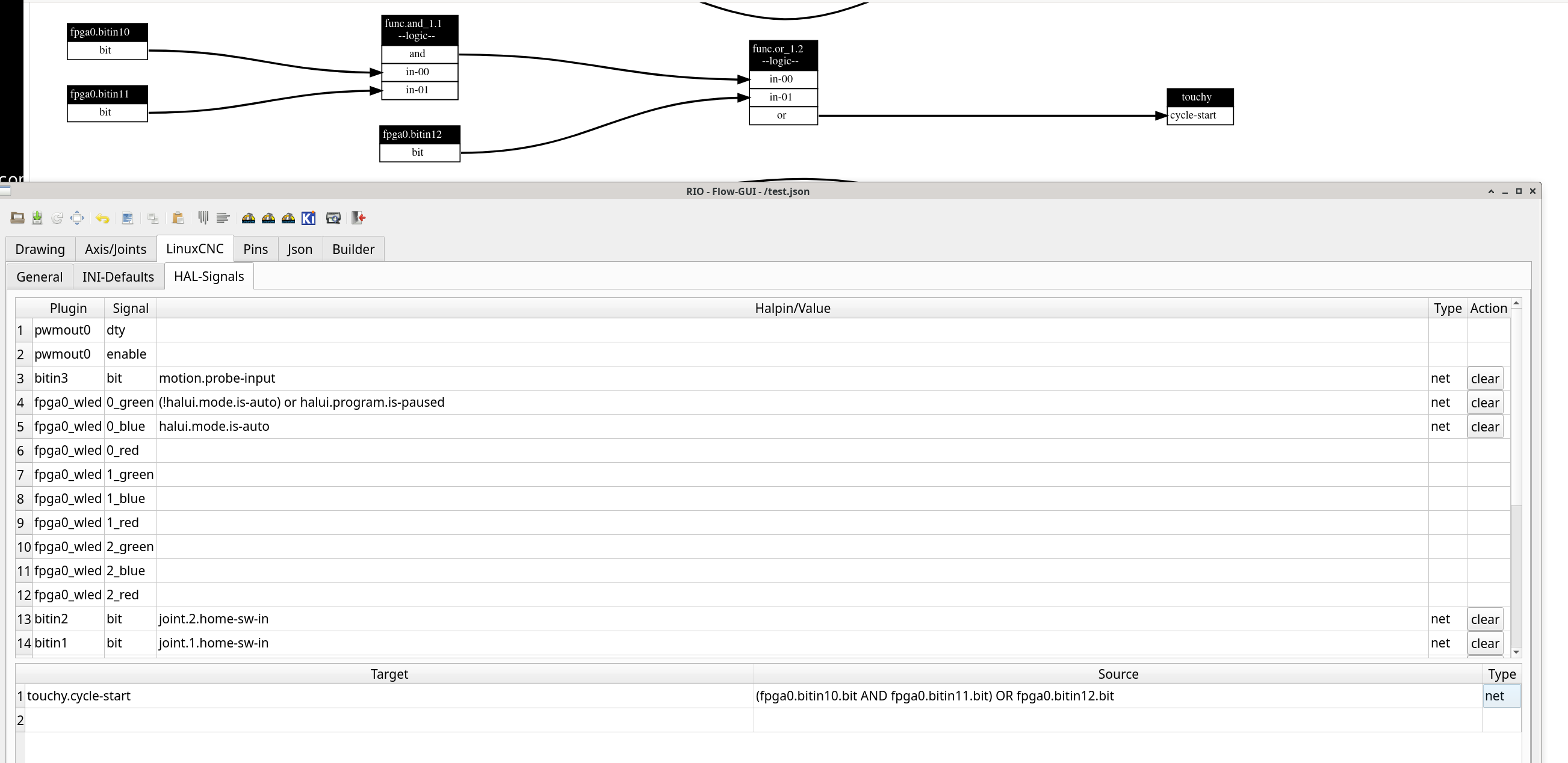

18 Aug 2026 09:53 #348841 by Oxbown
Hi everyone,
First off, huge thanks to the @meister for the amazing work on RioCore and Rio Flow. It makes FPGA-based configurations for LinuxCNC much more accessible and structured!
I’m currently setting up a machine using RioCore with a Touchy interface and a physical control panel (hardware buttons, safety relays, etc.), and I have a couple of architectural questions regarding custom HAL management:
1. Loading Custom Real-Time Components in Main HAL (e.g., ClassicLadder)
Is there an intended workflow or plans to allow custom HAL code injection inside Rio Flow?
  • Use Case: I need to load and thread ClassicLadder (
    loadrt classicladder_rt ...
    loadusr -w classicladder my_logic.clp
    ) to handle auxiliary machine logic and map FPGA inputs/outputs directly to
    %I
     and
    %Q
     points before the motion thread starts.
  • Currently, modifying generated main HAL files requires re-editing them after each export. Would it be possible to have a persistent "User HAL Block" or a dedicated non-destructive include file in Rio Flow?
2. Managing Custom PostGUI Nets Without Being Overwritten
How should we best handle GUI-dependent nets across exports?
  • Use Case: Connecting physical hardware inputs mapped in RioCore to GUI-specific pins like
    touchy.cycle-start
    touchy.single-block
    , or
    halui.machine.on
  • Since these pins only instantiate after the display loads, they must live in the PostGUI phase. However, each time Rio Flow regenerates/exports the setup, the auto-generated PostGUI call chain (
    postgui_call_list.hal
    custom_postgui.hal
    ) gets wiped/reset.
Is there a recommended way to structure user-defined pre-GUI and post-GUI files so Rio Flow leaves them untouched, or is native support for custom code injection / user PostGUI nets planned for future releases?
Thanks in advance for any insights or tips on how you guys are handling this!

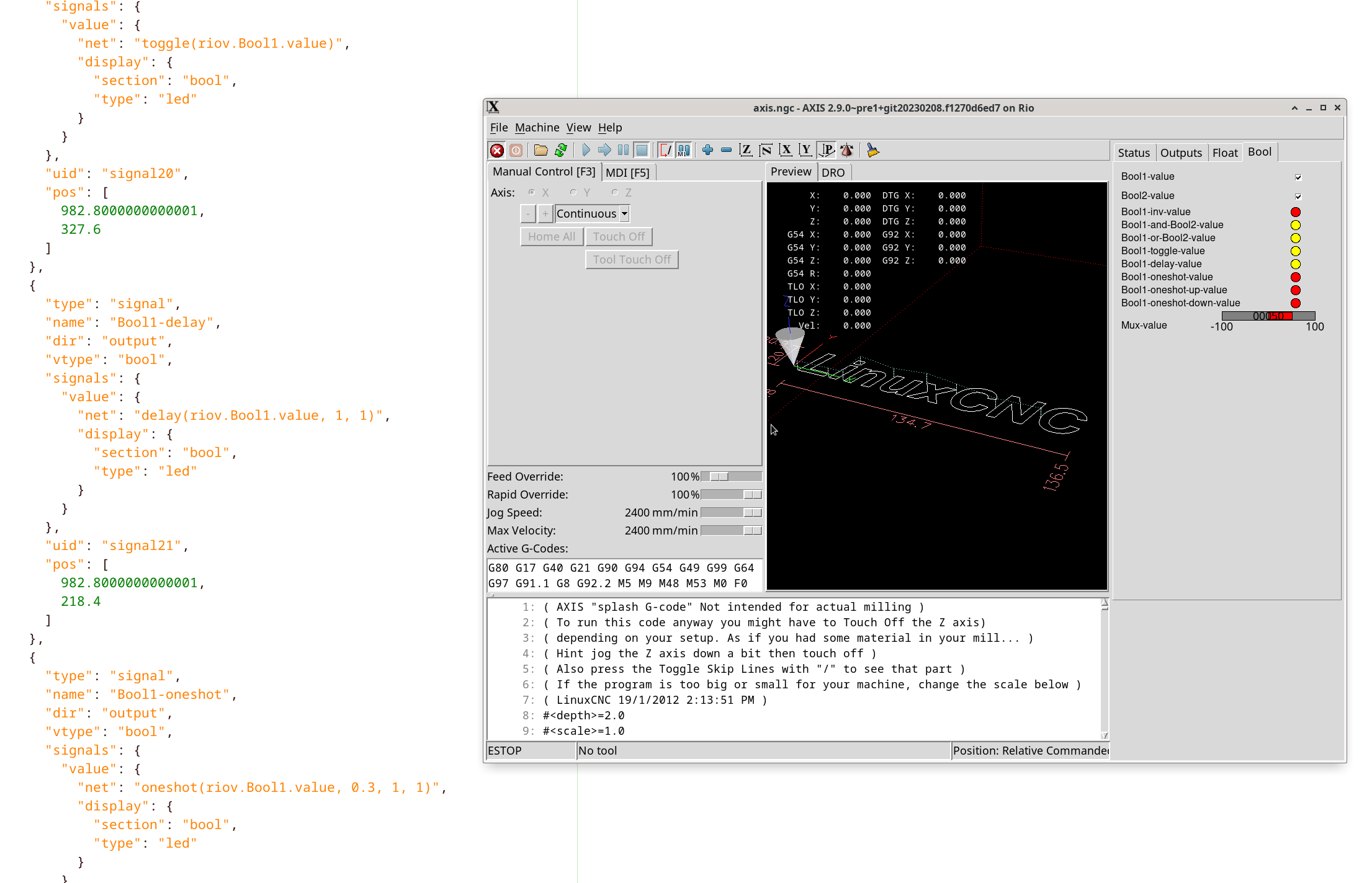

18 Aug 2026 11:51 #348842 by meister
Hi Oxbown,
thanks :)
you can add your own .hal files to the call_list's:
$ cat Output/Tangbob/LinuxCNC/pregui_call_list.hal
source my_own_pregui.hal
$ cat Output/Tangbob/LinuxCNC/postgui_call_list.hal
source custom_postgui.hal
source my_own_postgui.hal
these extra source entries are not removed during generation
i add the 'touchy' prefix to POSTGUI_COMPONENTS (riocore/generator/hal.py),
now, all generated HAL entries beginning with ‘touchy’ should end up in the PostGUI HAL (in main and dev branch / git pull)
Unfortunately, I haven’t used ClassicLadder yet, so I can’t be much help there,
but it’s a good opportunity to mention a specific feature in Rio again :)
When specifying a signal source, you can use various logic and functions.
I think it’s a killer feature that doesn’t get nearly enough attention :)
you can start a demo configuration:
rio-generator -S riocore/configs/haldemo/virtual-signals-axis-pyvcp.json
