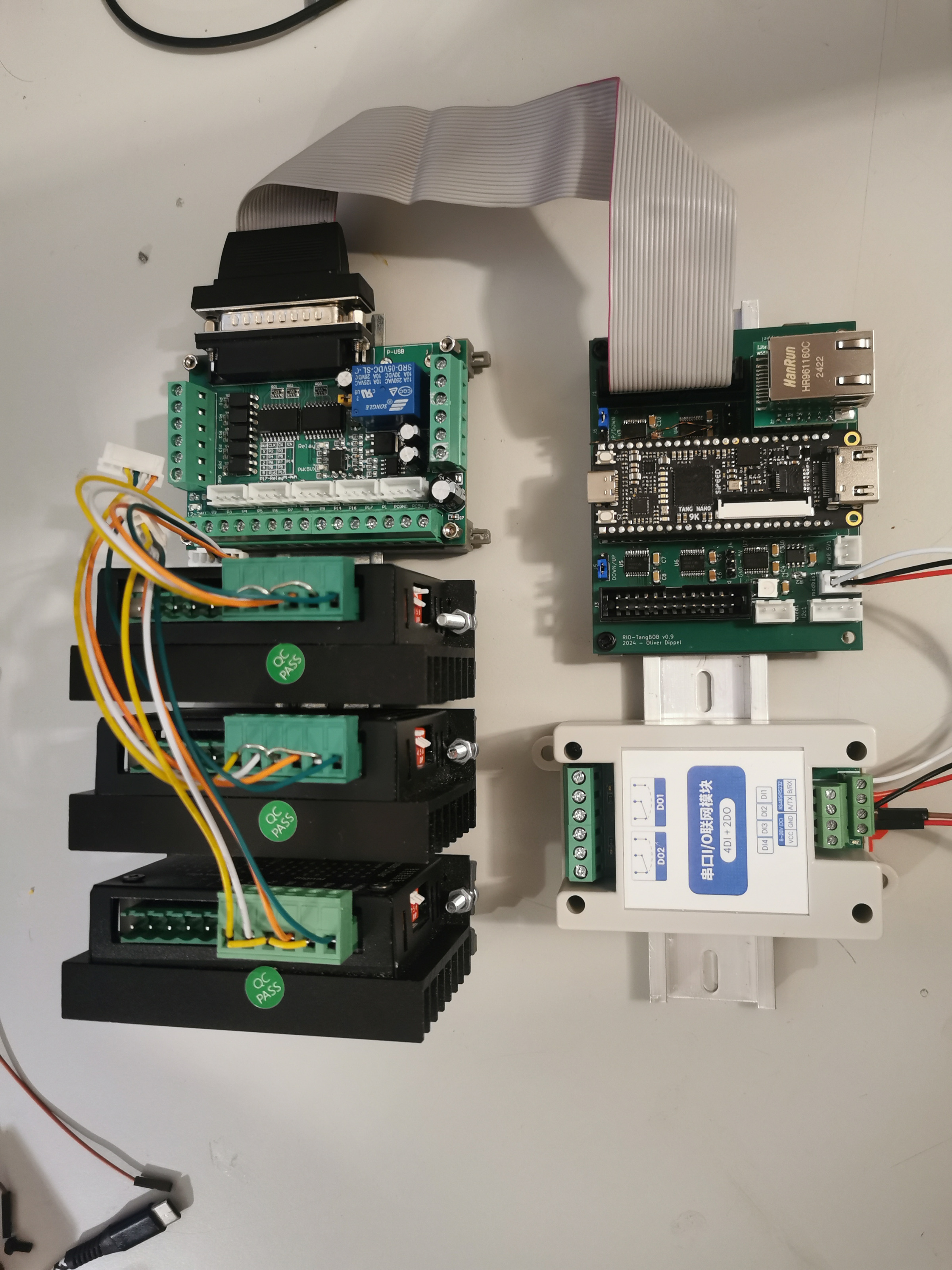

Can't recommend this set-up enough. For those who aren't particularly interested in engineering hardware and want a Snap-On Ready Kit, it just won't get any better than that. That'll do 50meg, prolly capable of more. Oliver did it all for grab  github.com/multigcs/rio-tangbob
Flash the bitstream over, plug-in a shielded 100mb cat6, and be done!!
