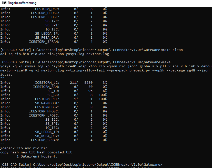

Hi Meister,
Unfortunately, I cannot make it run under Windows.
I have changed:
file_path = r".\riocore\__init__.py"
if os.path.isfile(file_path):
sys.path.insert(0, os.path.abspath("."))
When running rio_setup, the first problem, I cannot import halpins from riocore.
Directory is OK and the __init__.py file is there.
Perhaps you can help me out. Thanks a lot!
I have changed:

05 Dec 2024 09:34 - 05 Dec 2024 09:38 #316004
by meister
Replied by meister on topic LinuxCNC-RIO - RealtimeIO for LinuxCNC based on FPGA (ICE40 / ECP5)
i think you are on the wrong branch:
git checkout dev
BTW: very experimental, only for the gui and to generate the config-files,
i think, building bitfiles will not work yet on windows
git checkout dev
Last edit: 05 Dec 2024 09:38 by meister.

05 Dec 2024 15:20 #316018
by MirkoCNC
Replied by MirkoCNC on topic LinuxCNC-RIO - RealtimeIO for LinuxCNC based on FPGA (ICE40 / ECP5)
I am almost done. The Graphic in Overview, Hal and Axis works now.
rio.v and makefile OK.
One last issue: Warning: can not find toolchain installation in PATH: nextpnr (nextpnr-ice40)
Furthermore there is an error: loading joypad:: No module named 'fcntl'. No idea what I have to install here.
