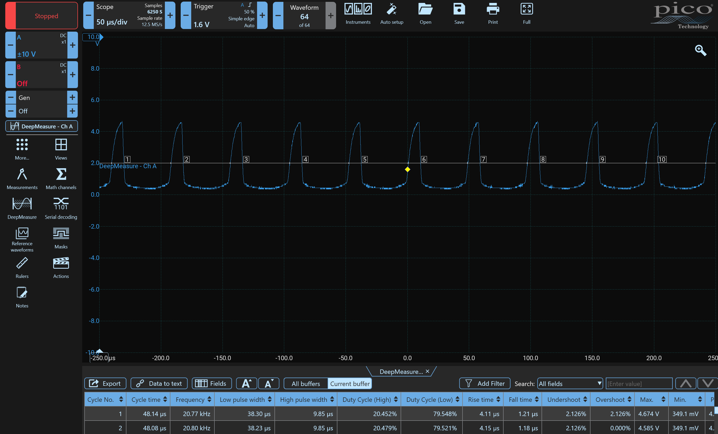

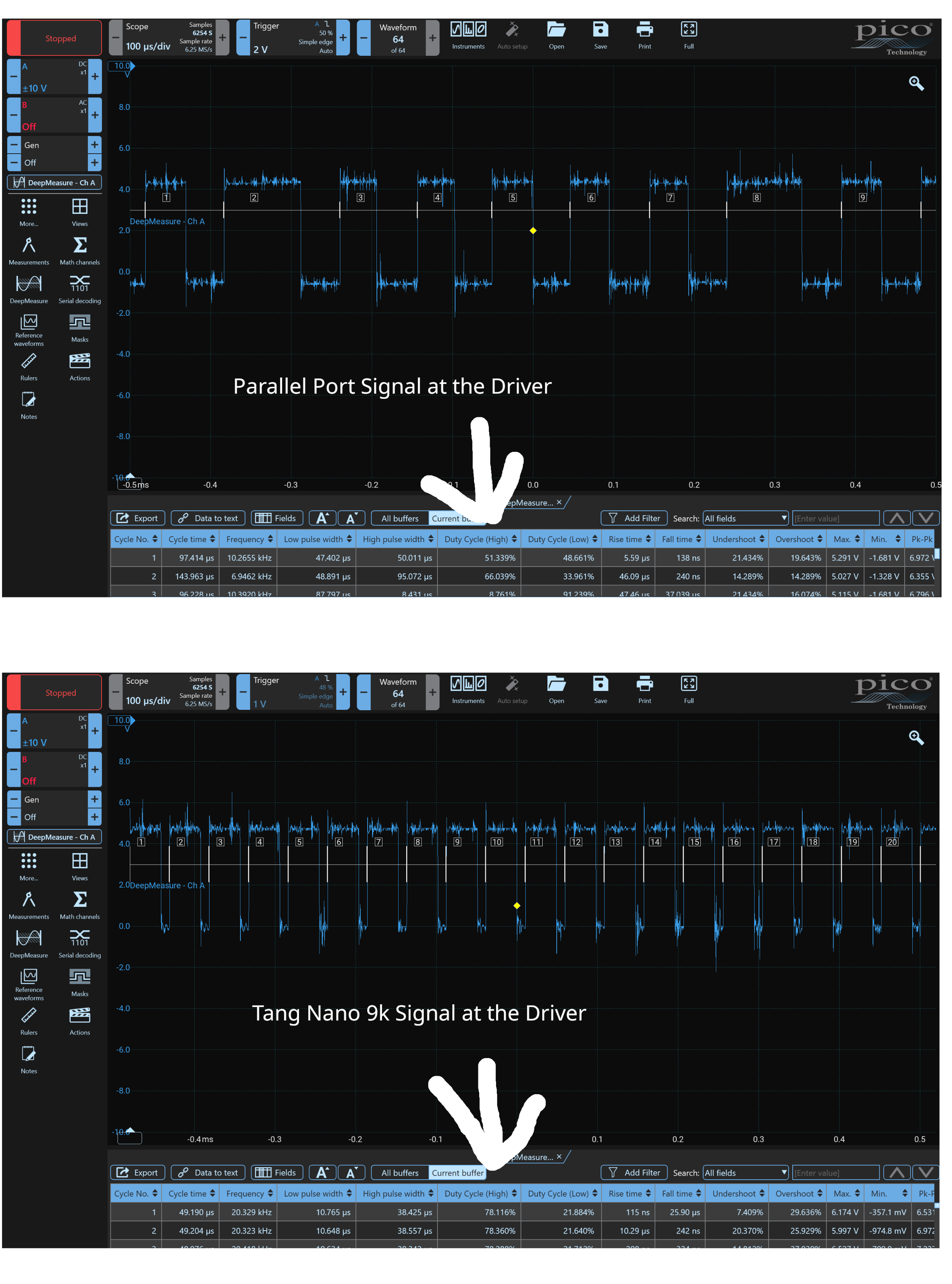

And another interesting thing. The Tang is performing way better as my parallel port! I can go high speed with much more microstepping. The motors sound better, but somehow I hit a wall when I wanted to go higher speeds. I am not sure what the reason for this is. If I run with the Tang, I can go up to 2000mm/min (400rpm on my motors) with my Y axis. No matter if I have 10 or 16 microsteps. If I go over the that speed the motor go for like 50mm than they start sounding weird until one of the 2 motors stalls. I first thought that was a mechanical issue and detached the gantry, but still same behavior. I checked with my osciloscope the output of the Tang, the level shifter, the BOB and finally I measured directly at the drives. All seems good. My drives need 2ns low period before the detect the next raising edge. All I measured was within the tolerance of the drives...
I almost gave up since it seems like independent from the microsteps. Then I tried my parallel port set up again and pushed as much as I could. I had to go down to 10 microsteps again and was able to achieve without the stalling around 2700mm/min. Could not go higher due to cycle time limitations, then I got a joint following error in linuxcnc.
I measured again at the drives and saw that the duty cycle high and low of the parallel port signal are almost equal at 50%. The tang produces 80% 20%. I believe this could be a reason why I can't go higher. Is it possible? and if so, change be changed?
In the picture of the parallel port you can see the jitter. Where the Tang performance is much better!

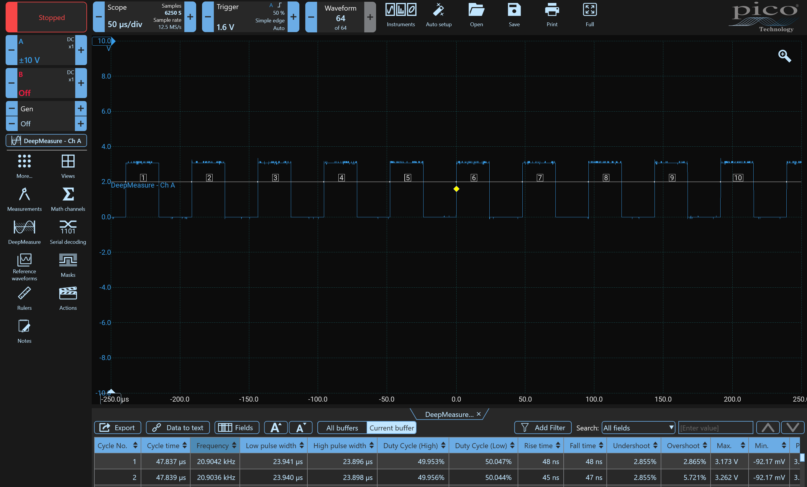

11 Nov 2024 07:42 #314229
by meister
Replied by meister on topic LinuxCNC-RIO - RealtimeIO for LinuxCNC based on FPGA (ICE40 / ECP5)
the stepgen from rio also has a duty cycle of 50%,
try measuring the signal at the FPGA pin

I wonder if at that speed you're getting near the max speed of the level shifter? How does the tang look at the same speed as the paraport?

12 Nov 2024 03:42 #314299
by mBender
Replied by mBender on topic LinuxCNC-RIO - RealtimeIO for LinuxCNC based on FPGA (ICE40 / ECP5)
Hmm, I must have made a mistake when measuring the signals. The Tang gives out a perfect 50% duty cycle. I was sure that the level shifter made the same. however they did not. The level shifters make something weird out of it. The level shifter have EL817 coupler on them. The
datasheet
shows cut off frequency fc =80khz. If I read that right I should not even be around 25% of what they should be able to do. They do have an LED, I wonder if a pulldown resistor would help???
I think @meister said, that I could connected the breakout board directly to the outputs of the Tang. I might try that.
