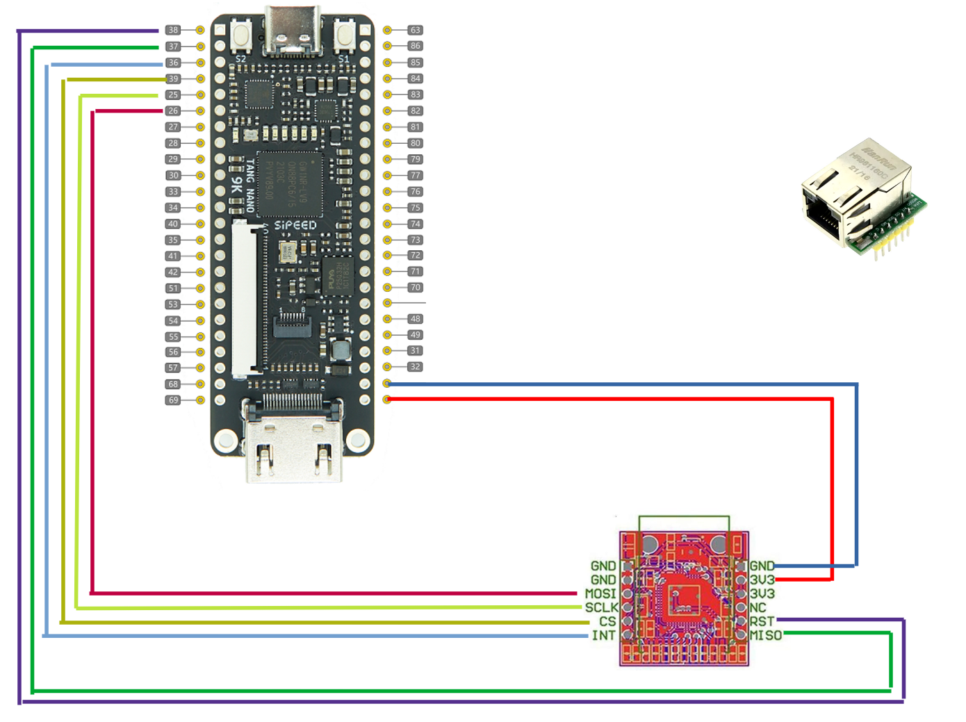

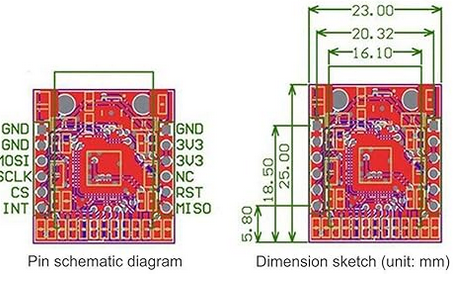

Well, I don't have 5V on my W5500. This is the only schematic I found online.
- Posts: 21959
- Thank you received: 7478
26 Oct 2024 23:23 #313272
Replied by tommylight on topic LinuxCNC-RIO - RealtimeIO for LinuxCNC based on FPGA (ICE40 / ECP5)
That is W5500 mini, and from your attached picture it does not have 5V, while the normal longer W5500 has 5V and 3.3V power.

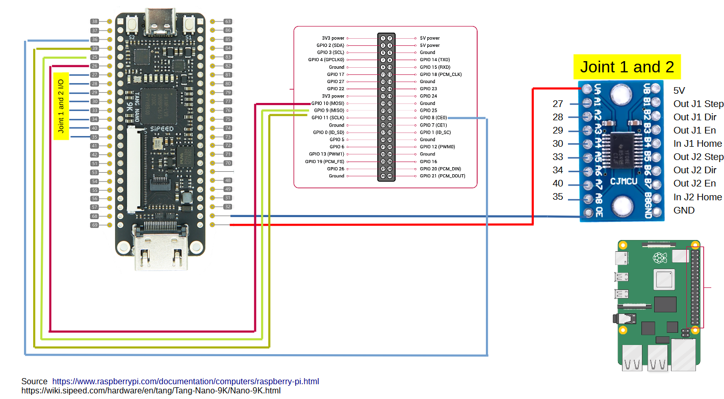

Ok, so do I have the wrong W5500? I was planning to use it like in the attached picture.

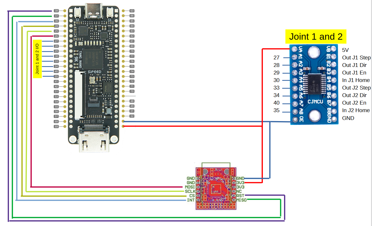

EDIT Nov. 3 2024. THERE IS A WIRING ERROR IN THE PICTURE BELOW. THE OE LINE NEEDS TO BE CONNECTED TO 3.3V OR AN OUTPUT. WILL CORRECT THE DRAWING AND UPLOAD AGAIN ONCE TESTED.
This one is actually how I want to connect the joints. I have a total of 4 joints (dual Y axis motor), but only draw joint 1 and 2 for the moment.

was my mistake, the mini W5500 only have 3v3.
i can't tell you exactly how much the tang can take, but so far it has always been enough in all constellations without anything getting warm.
RST and INT signals are not needed
