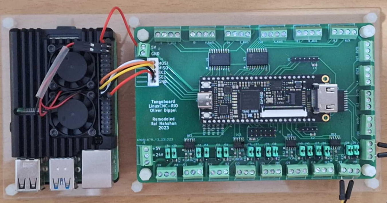

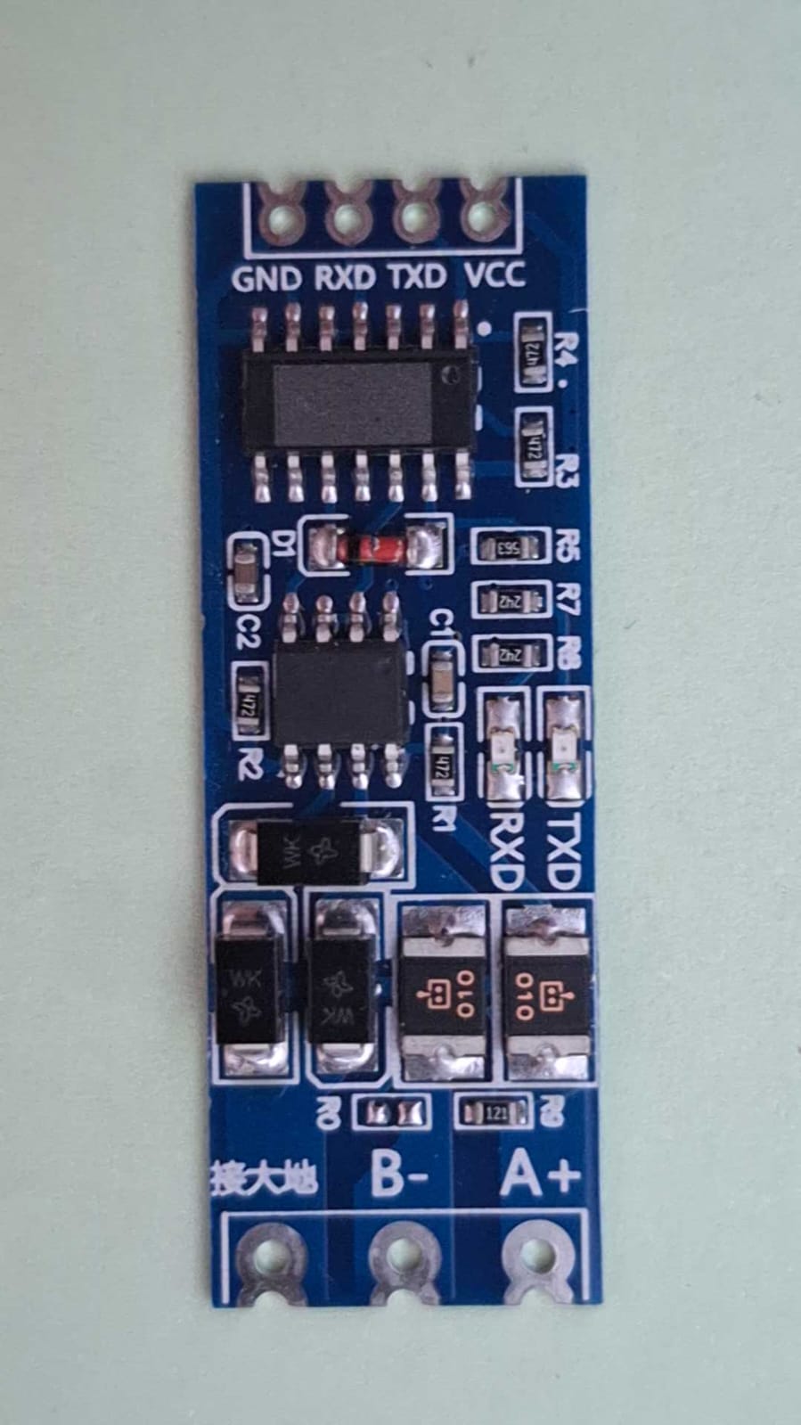

Is your vesion of the Tango board a modified PCB? and is there Kicad or PCB repository. Just so I can compare the difference with Olivers version.I am switching LinuxCNC from an old PC to RaspberryPI + Tango compatible board.
I see that riocore has support for HY_VFD and I want to use it. After resolving simple issues I can get a serial signal out of the Tang Nano, but no connectio to the VFD yet. I guess I will need a TTL to RS485 brekout board. Will this one do?
Last time that I made changes to the HY_VFD configuration it cost me a burnt spindle, so now I'm trying to learn more and if possible from other's experience. I will appreciare any help and suggestions.
Thanks!
-- Itai

Replied by itai on topic LinuxCNC-RIO - RealtimeIO for LinuxCNC based on FPGA (ICE40 / ECP5)
I could not use Eagle so I have remodeled Oliver's OCB in KiCad.
I use different connectors. Noved the 5 outputs to the oppesire sides and have 5V/24V selection on all inputs (also wih option to change resisor values). Also added some capacitors.
If I make a new version I would use 6 pin JST to get 5V from the Raspberry PI. Possibly add MAX485+protection circuit to the board.
If there is demand I can put the Kicad files on github.

Thanks! I forgot it was already on Github! This is the latest that was sent to create the PCB. As I wrote, If I make a new version I would make some changes.no idea if it is up to date:

I'm drawing one based off of github.com/itain/Tango-PCB-Kicad to use with some components I have on hand but that repo seems out of date from the tangoboard pictured above. I'm also trying to get it under 100x100mm so a 4 layer board is $7 for 5 of them. I saw some pretty nice ones you have that look like they might plug into a pi?
