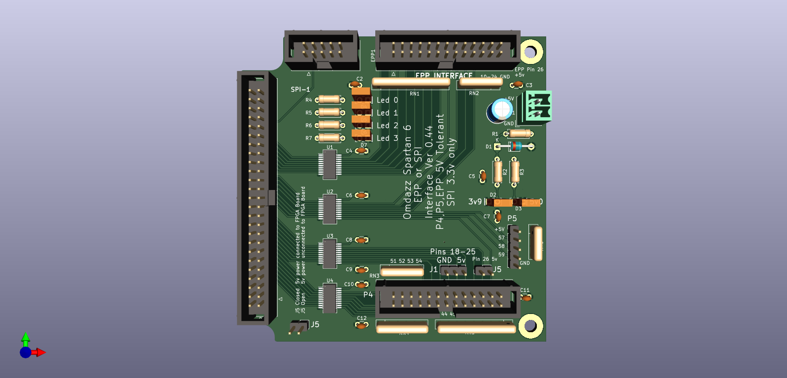

Replied by Cant do this anymore bye all on topic LinuxCNC-RIO - RealtimeIO for LinuxCNC based on FPGA (ICE40 / ECP5)
New "daughter board design".
SPI connector now matches the W5500 blue boards with the yellow connector, so a short length of 10 way ribbon cable should make the connection easy. Too much effort to design for the smaller Wiznet module.
EPP connector has 5v routed via pin 26, easier to add an "option" board.
Other 26 pin connector has the option to to have 5v volts on pin 26 regardless of the jumper setting for pins 18-25, these are selectable for either 5v or GND. Some breakout boards can be powered via pin 26 on their ribbon cable connectors.
Cut outs added so as to no interfere with JTAG connector on OMDAZZ Spartan6 dev board. Should still be compatible when using mesa firmware. The top side 50 way male connector is replaced with a 50 way female connector on the underside to allow mounting to an unmodified dev board.
