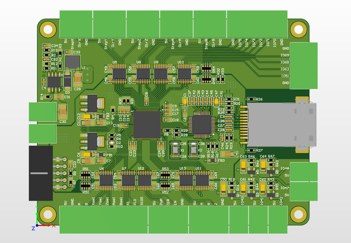

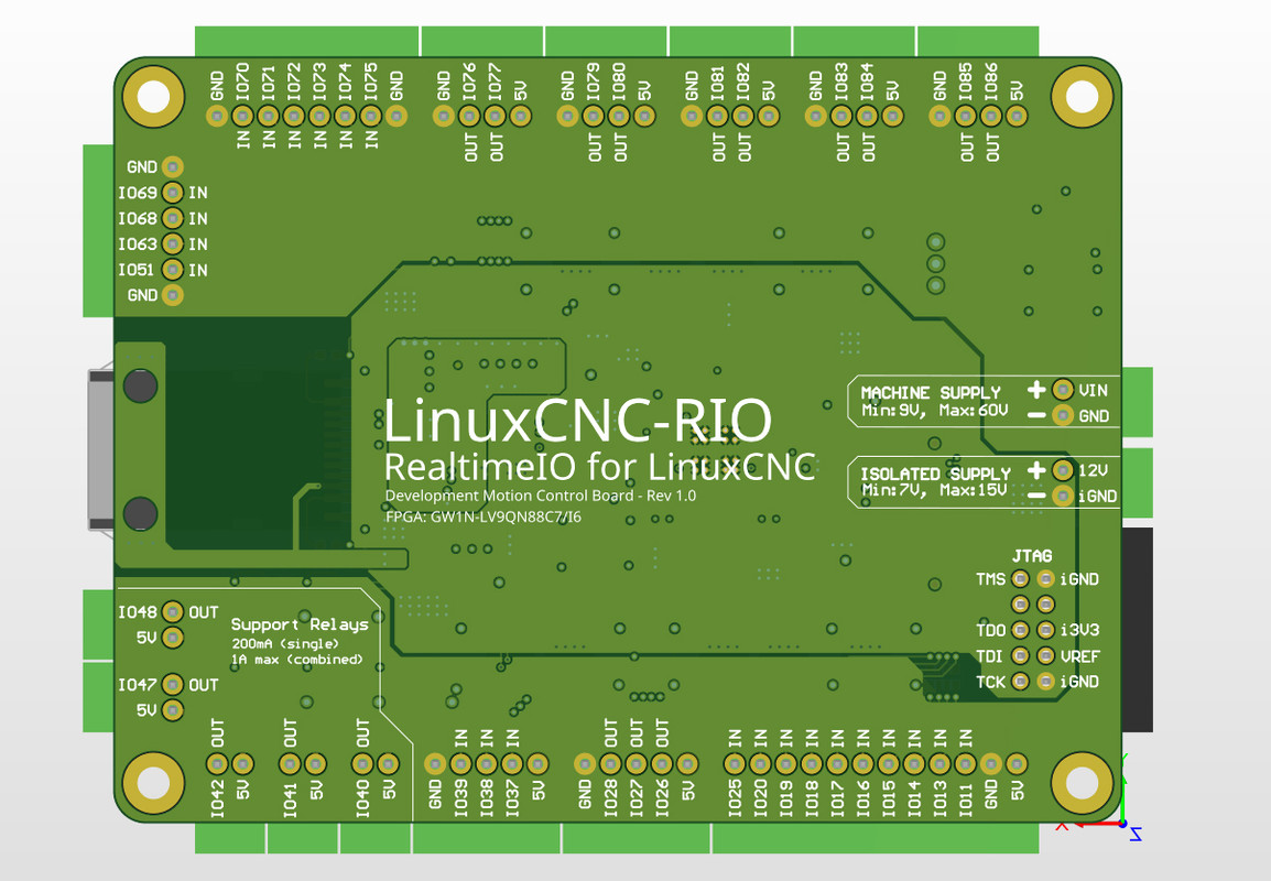

13 Aug 2024 12:51 #307628
by Mecanix
Replied by Mecanix on topic LinuxCNC-RIO - RealtimeIO for LinuxCNC based on FPGA (ICE40 / ECP5)
The following user(s) said Thank You: kostas, rthorntn, tommylight, Clive S, meister
- rthorntn
- Posts: 33
- Thank you received: 6
13 Aug 2024 21:35 - 13 Aug 2024 21:36 #307664
by rthorntn
Replied by rthorntn on topic LinuxCNC-RIO - RealtimeIO for LinuxCNC based on FPGA (ICE40 / ECP5)
Awesome, did you use any opto-couplers/digital isolators, are the nine 16-pin IC's only level-shifters?
Last edit: 13 Aug 2024 21:36 by rthorntn.
- Mecanix
- Posts: 447
- Thank you received: 229
14 Aug 2024 00:05 #307685
by Mecanix
Here's the cool visuals:
Well spotted, correct, those 9 parts are indeed the level shifting. Features digital isolation also, all in one part. I apologize for omitting the schematic for now, once I have it cleaned up and arranged I'll put it up. I'd like to test the board prior though. Regardless, here's a visual below of how it's arranged (ten inputs). Additionally, I'm getting us an ultra-low ripple Isolated 12V Supply done for that board. Plugs right on the main. If we are to isolate this FPGA/Motion Control thing, might as well isolate it true & properly!!Awesome, did you use any opto-couplers/digital isolators, are the nine 16-pin IC's only level-shifters?
The following user(s) said Thank You: rthorntn, meister
- rthorntn
- Posts: 33
14 Aug 2024 23:18 #307755
by rthorntn
Thanks!
Just trying to work this out in my head, to learn...30 shifted and isolated I/O pins (20 inputs 10 outputs, up to 36 supported (4 x 9)), using ISO7760, so are you just doing a 180 degree on the iso7760 depending on whether it covers inputs or outputs?
How do you plan to solder this, paste and a wee oven?
The following user(s) said Thank You: Mecanix
- Mecanix
- Posts: 447
15 Aug 2024 00:48 #307758
by Mecanix
Using Sn63Pb37 solder paste and a hot plate for assembly. I know I know, lead based [DANGER]. Notice no parts on the bottom of the PCB, and so the process is stencil, paste-on, and flat-on a hot plate @230dC for 2.5min it goes. Yields 100% rate each and every time.
(You can prolly guess I'm looking forward that board!!)
Correct again! That iso776x part will switch to specs if powered within 2V5~5V in either direction, as you've guessed already. Can even go down to 1V2 (seems to work) although speed is not guaranteed. On the Ins/Outs; I'm counting 18 OUTPUTs & 23 INPUTs on that board, with 5 outputs having 200mA support - useful for switching analog relays on/off (Oiler, Coolant, Clamp, Lighting, Spare). All in All plenty sufficient to build any machine-tool to manufacture a spacecraft!!Thanks!
