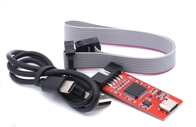

I wouldn't know for sure, Oliver. Nice thing about Gowin's is the endless jtag probes avail, for all I know. I have 3 here that works perfectly fine (up to 10~15mhz). The one you saw in previous visuals (FT232 based), and the ones below. All <$15.Do you think it could also work with a USB blaster?

by meister
Replied by meister on topic LinuxCNC-RIO - RealtimeIO for LinuxCNC based on FPGA (ICE40 / ECP5)
do they work under linux ?
and with which software ?
Last edit: 12 Aug 2024 09:32 by meister.
- Mecanix
- Posts: 447
- Thank you received: 229
12 Aug 2024 09:40 - 12 Aug 2024 09:44 #307529
by Mecanix
Replied by Mecanix on topic LinuxCNC-RIO - RealtimeIO for LinuxCNC based on FPGA (ICE40 / ECP5)
Yeah they all do linux. Software: Gowin_V1.9.10_linux (/programmer/driver folder).
