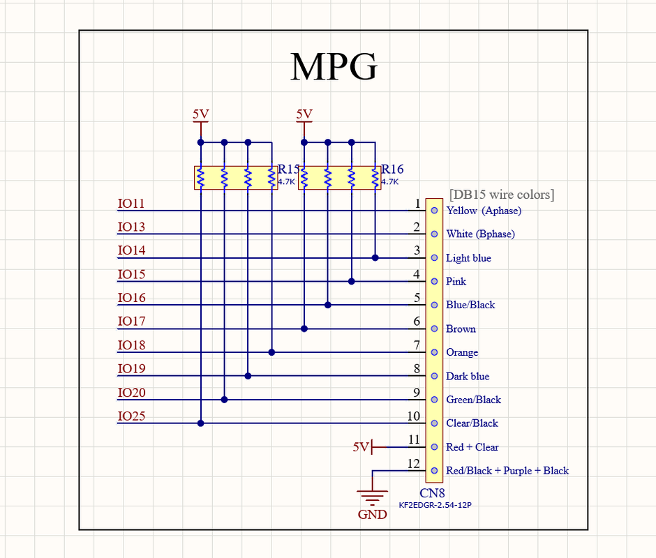

Oliver, bit of a heads up; I'm keeping all of Sunday free to play RIO and motion controls (way too fun man). On that great Sunday agenda is this MPG implementation!!
When you have time to think about it, I'd love to hear about creative way(s) to implement this MPG into Rio in the most simplistic possible way (aka for noob!). At least some hints as to where to begin with this, and I'll figure out the rest (coughs lol).

Give us the heads up and hint us rather, i.e where to start to get a module written (template/example?). If we are to be using RIO for the next decade then it's imperative we know how to implement one of those cool plugin/module (not even sure of the difference between both, goes to show). So much to learn and fun ahead I'm sure.I’ll drag it out over the weekend.

ok, jogging, grrrrrrrrrrrrrr
in general, everything can be configured as with mesa at the end via hal, the only problem is that this is overwritten when regenerating
To make simple assignments, there are the 'signal' -> 'net' options.
A strength of RIO is that even double assignments are recognised and if possible an AND/OR is built in between.
When it gets more complicated, for example when jogging (switching axes / speed / ..) the 'net' option no longer helps
but then there is the 'signal' -> 'function' option
there are a few predefined options
Examples 1:
2 Encoder
1. for Axis X / joint0
2. for Axis Y / joint1
Examples 2:
1 Encoder for all axis
joint/axis selection can be done in the AXIS gui
Mixing Example 1 and 2 is not possible
this is a list of some rio functions:
i think we need a documentation for this, there are other function but i have also need to check what i have done there
last but not least, there are also a few add-ons that can be configured via the setup-gui:
it doesn't seem like much now, but we can still expand it and with the automatic links it is already very powerful and can create hal's that nobody would have to create by hand
Examples 1:
2 Encoder
"type": "quadencoder",
"pins": {
"a": {
"pin": "SHIFT_INPUT[0]"
"b": {
"pin": "SHIFT_INPUT[1]"
"signals": {
"position": {
"function": "jog.wheel_x"
"pins": {
"a": {
"pin": "SHIFT_INPUT[2]"
"b": {
"pin": "SHIFT_INPUT[3]"
"signals": {
"position": {
"function": "jog.wheel_y"
},Examples 2:
"pins": {
"a": {
"b": {
"signals": {
"position": {
"function": "jog.wheel"
},Mixing Example 1 and 2 is not possible

09 Aug 2024 17:09 #307373
by meister
Replied by meister on topic LinuxCNC-RIO - RealtimeIO for LinuxCNC based on FPGA (ICE40 / ECP5)
by the way, if you were wondering why there are such strange pin names at the top of the quadencoder:
these are 'virtual' pins that are created when an expansion plugin is loaded:
the expansion pins can be used in the same way as real pins in the configuration, except that they are limited to one direction.
Otherwise you can use them in pretty much any other plugin
even PWM or stepper if they don't need to be ultra fast
"pins": {
"a": {
"b": {
"signals": {
"position": {
},these are 'virtual' pins that are created when an expansion plugin is loaded:
"type": "shiftreg",
"pins": {
"out": {
"pin": "PMOD:P1"
"in": {
"pin": "PMOD:P2"
"sclk": {
"pin": "PMOD:P3"
"load": {
"pin": "PMOD:P4"
"name": "shift",
"speed": 5000000
},the expansion pins can be used in the same way as real pins in the configuration, except that they are limited to one direction.

09 Aug 2024 17:22 #307374
by Mecanix
Replied by Mecanix on topic LinuxCNC-RIO - RealtimeIO for LinuxCNC based on FPGA (ICE40 / ECP5)
I was shy to ask where those shift arrays came from. So glad you've explained.
I hope for lightnings, thunder, heavy rain and a dozen typhoons all of Sunday. I'll cave under and get it done. Thanks a-mil again Oliver.
