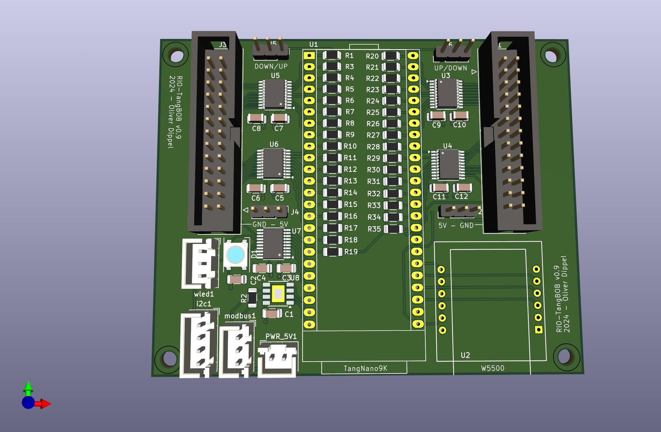

with Kicat it works better and better (before i was very limited with eagle-cad), so i will probably build another board like the Tangoboard, but this time with ICE40 and with W5500 .

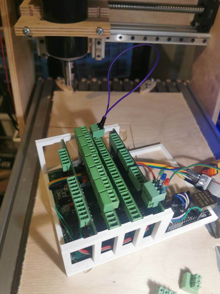

I might also pursue an old approach for a modular board,
I had already done some tests:
