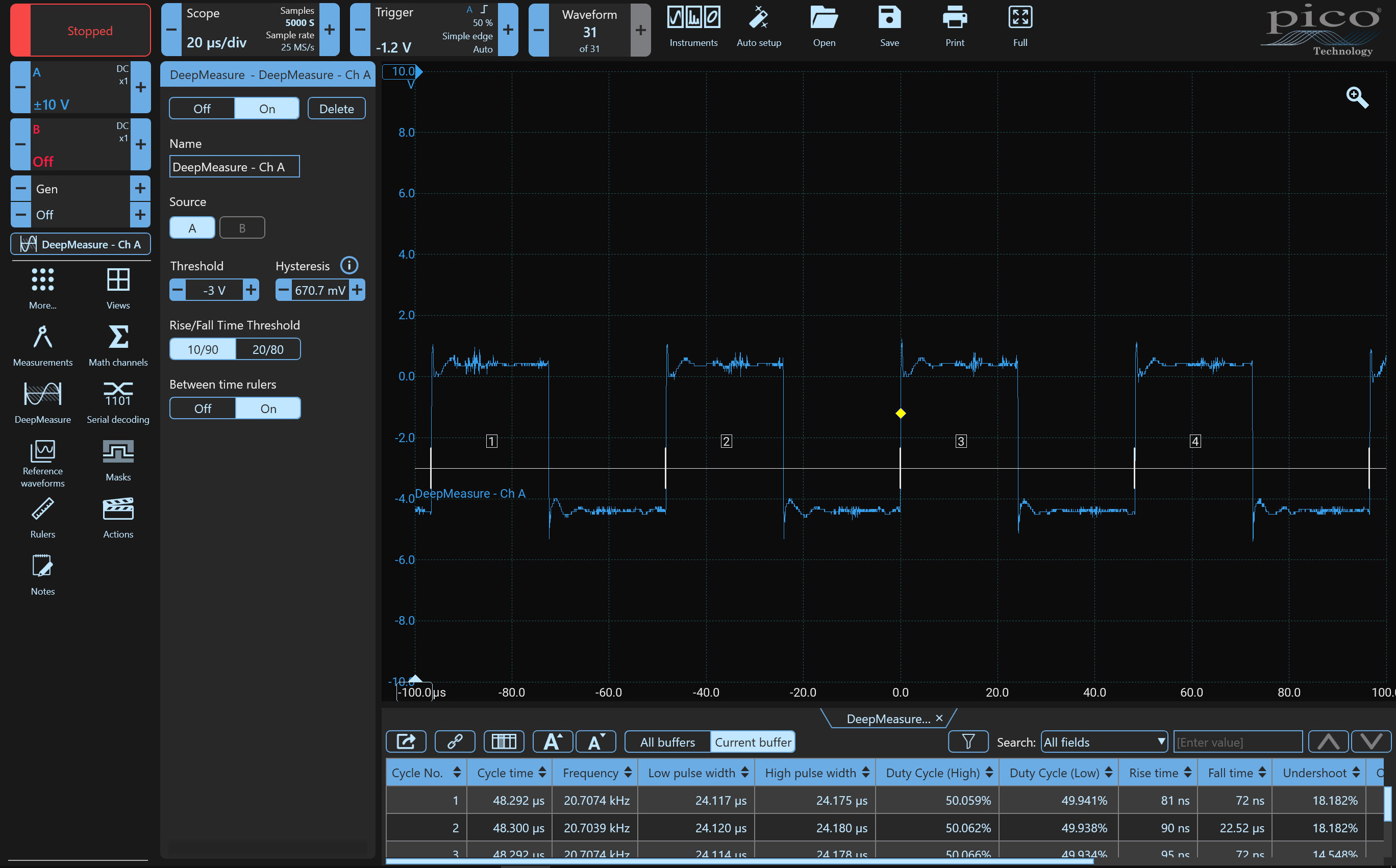

I removed the level shifter and connected the Tang directly to the Break out Board. Good news, it works. Then I measured at the drives and I get a nice 50% duty cycle. However, the motors still stall. And depending on where I stop, the Tang is sending Step Signals even without any movement. The motor just make sound.

12 Nov 2024 12:04 #314316 by tommylight
Why are you getting -4V on the scope?
Are the probes reversed?

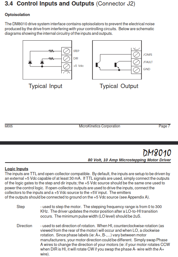

12 Nov 2024 12:51 #314321 by mBender
Yes, I was in a rush and was focusing more on the duty cycle. According to the manual of my driver, EN is 5V and Step and Dir will be pulled to ground.

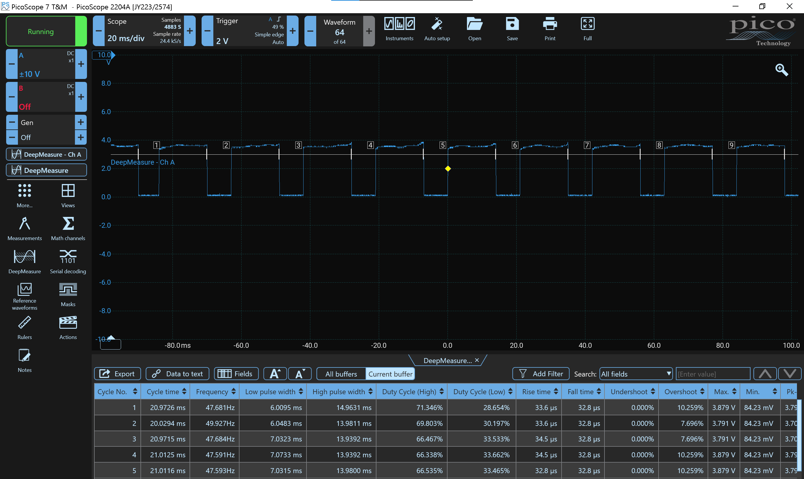

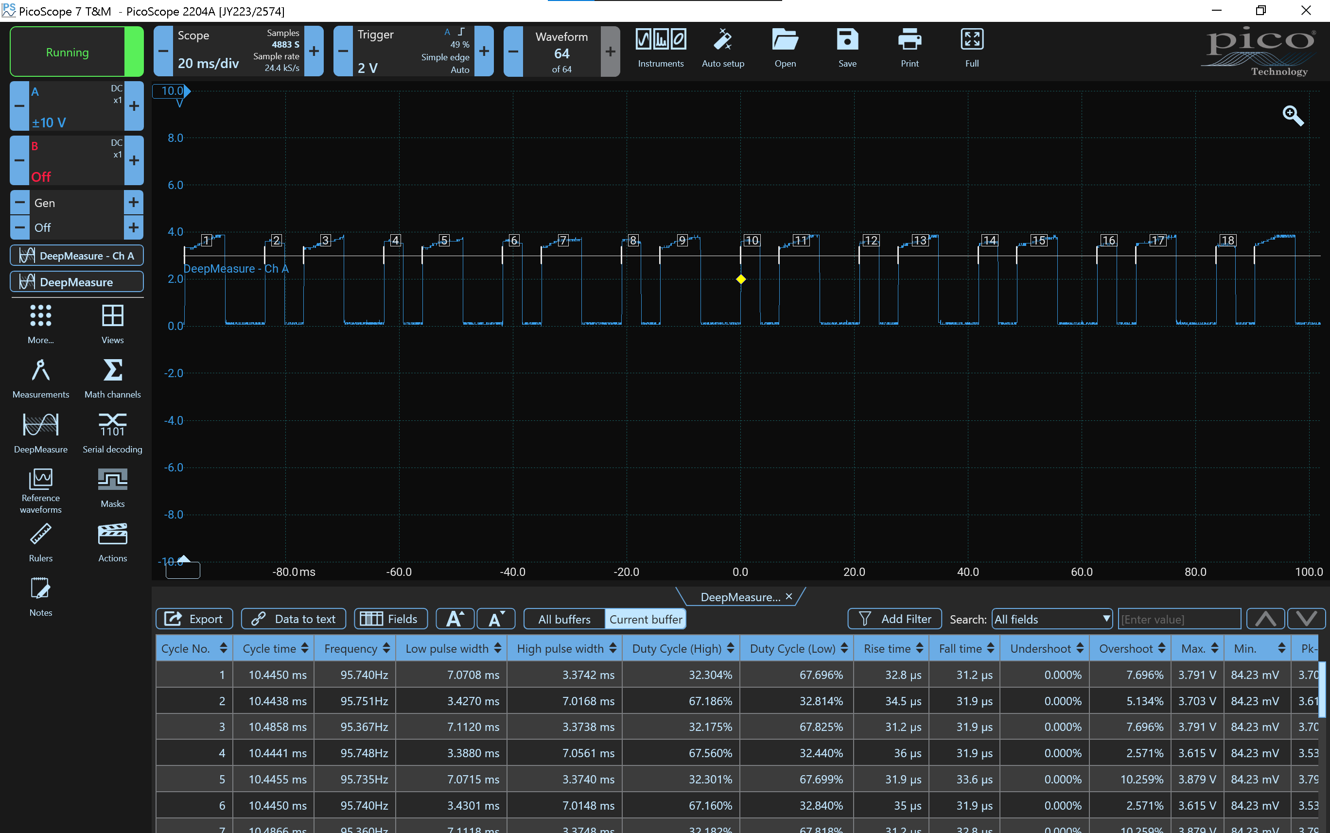

Anyway. I made some progress. I was curios why the Y axis motors making this weird sound when they are not moving and shaking a bit. I connected the oscilloscope to the Tang and depending on when I the movement I get the following signals on step and dir. The signals can look different which makes the motors sound different and sometimes i even stop at a point where no signal is produced. It feels like the tang is doing some sort of position holding or so.
Again, this is when the axis are not in a commanded move. It happens on X,Y,Y,and Z. X and Z just have different motors and I can't hear or feel it.
What could cause that?
