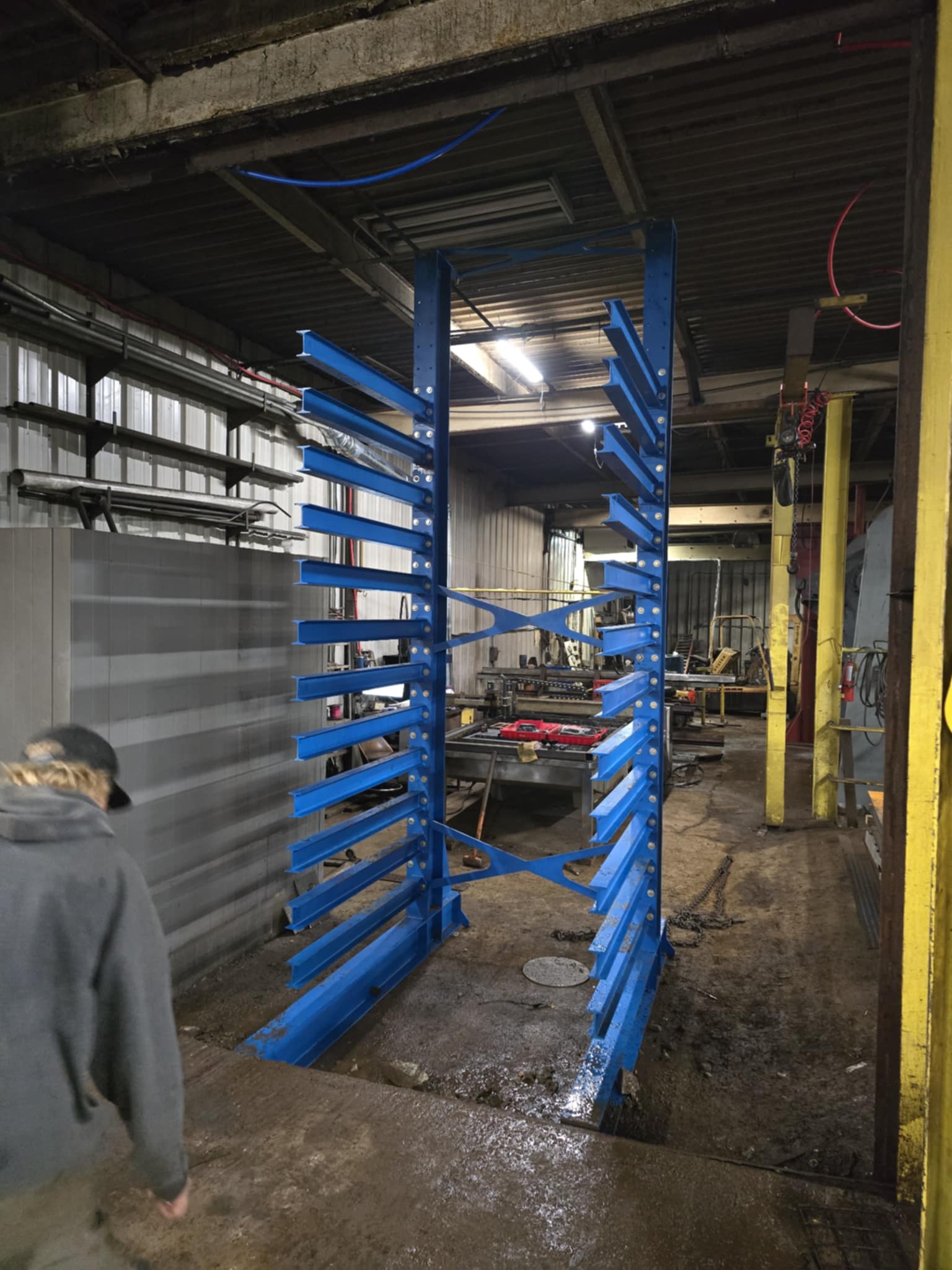

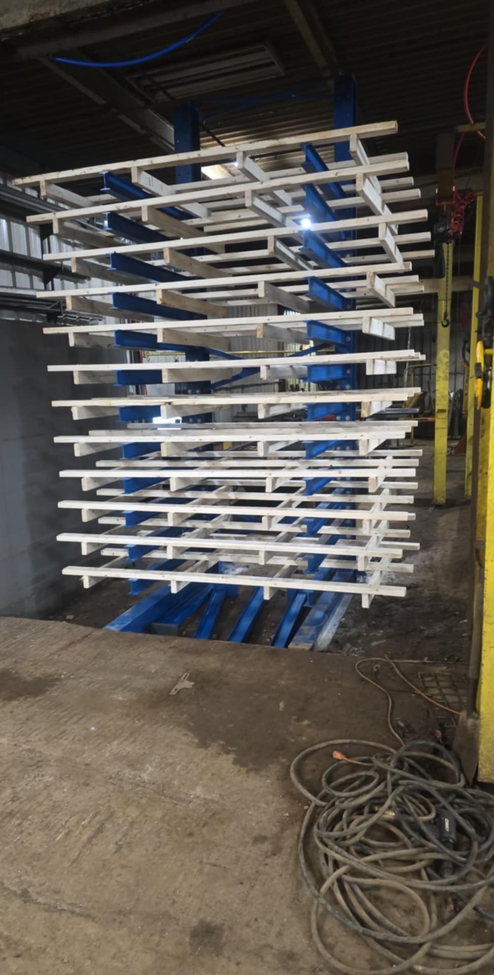

Little update I completed the sheet metal storage rack for my plate processing operation. Posted a few pics below. Going to get started on setting up the plasma table. I need to design a water table so I know what height to build the gantry to. Do you think it's worth it to obtain a few more of those steppers? I can hunt down more of these redbox machines to rob them from. Do you think they would have the power required to drive the gantry? I estimate it's 3-500 lbs I like the idea of high precision. I don't think I would save much money after wasting the time to aquire the redboxs tear them down etc but if there high quality components and really special it may be worth it. Got any expereince with water tables? Know of any good designs to work off of? Seems like a good amount of engineering is required to make sure it's strong enough to not collapse alot of weight is put on em aswell as I want to be able to raise and lower water height automatically, maybe even control it electronicly with electro pnumatic valves.

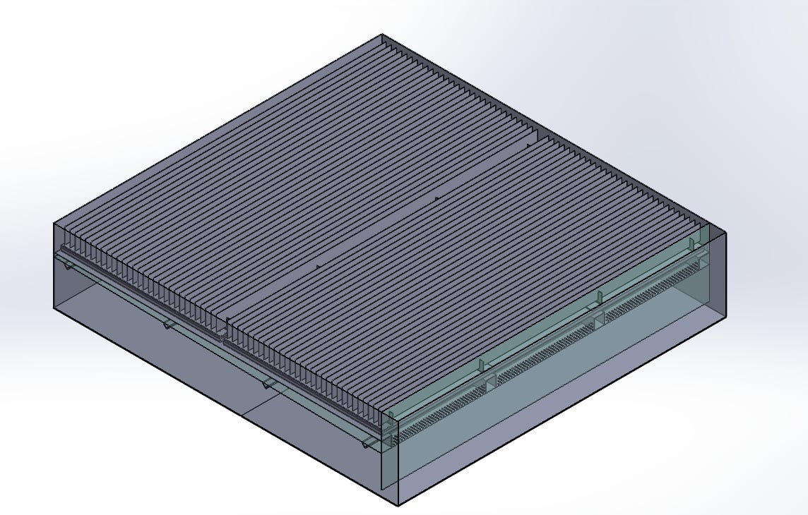

Heres the latest update on the project. I designed a water table 10.5 x 10.5 made from quarter inch thick Steel. I may increase size to 10.5 x 15.5 but not sure yet. It's pricy in material table so far weighs in at around 7000 lb and I am still going to add more support to it. It has removable slat bases that can be picked out of the bed with the crane for cleaning. I am designing for about 12 inches of water from lower to raise and shooting to be able to keep the slats 2 inch under water. I made the slats 6 inches long 1/8 thick every 2 inch. Do you think this is overkill???

Replied by rodw on topic 10.5 x 25 cnc plasma table retrofit

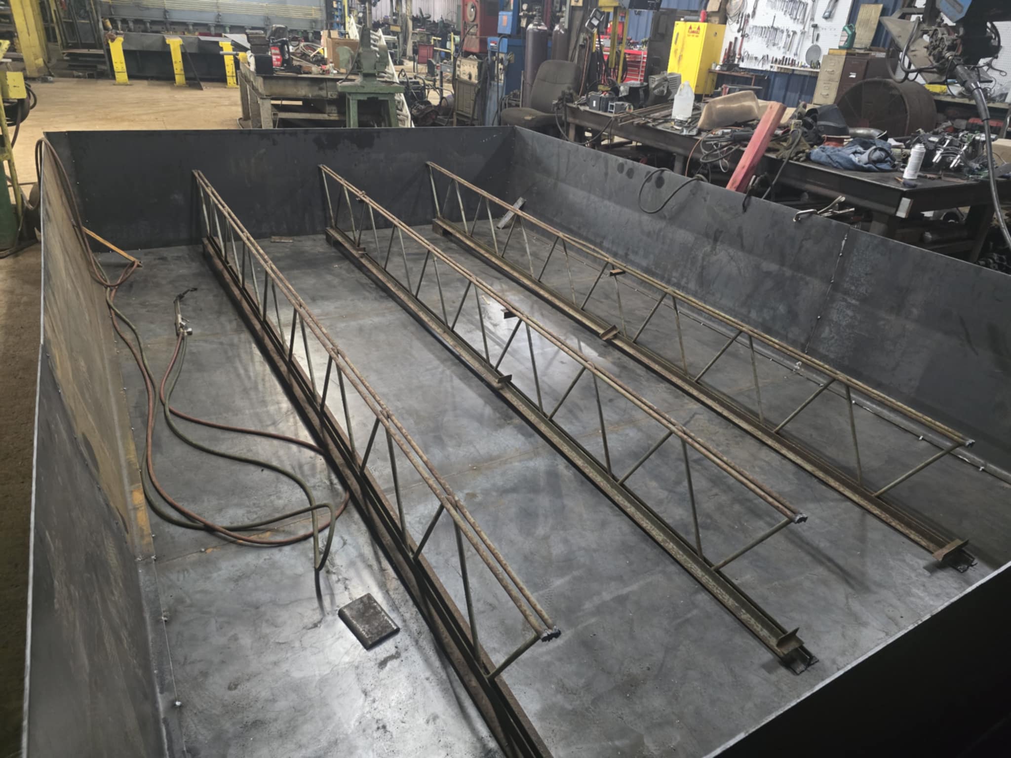

75 pages of build thread and I can't find what I want so this will have to do.
forum.linuxcnc.org/show-your-stuff/32029...ild?start=310#124765
I suggest you slats are only mounted each side and in the middle. Then you can put a bend in them and have the slat ends pushed against the frame which stiffens them up so they don't wobble. I copied this design from a swiftcut machine on the show room floor.
The slots holding the slats here are very shallow, maybe only 10-15mm laser cut into some 16mm strips

06 Dec 2024 06:55 #316077
by tcbmetalworks
Replied by tcbmetalworks on topic 10.5 x 25 cnc plasma table retrofit
Yea your right. My old plasma table was like that I had the slats curved. Although I may still be able to curve the slats with 4 points of contact vs 3 I'm not sure how much I like the idea of super short slats. I figure they will get burnt up on a high amperage cut. It's possible in the future I may starter cutting 200 amp cuts over a inch of material thick. Today I got the table moved and started to clean up. Purchased new bearings man they are not cheap. Makes me second guess buying such a pos and not buying a complete working machine from a auction but here we are. I may reduce the thickness of the water table to 3/16 from 1/4 inch. Its about 7000 lbs of material which gets pricey. I kindof want the strength tho so it can handle getting banged up. I am going to order the parts list Tommy put together for the control tonight and try to get it to run on the original dc servos for now. I gutted the z axis the linear guides were super frozen up I got them to atleast move with only a few lbs of force on em. Tommorow more lubing and cleaning. I was looking at the original motors and the drives seems I do not have a plug for y axis encoders only for x axis into the box with all the drives. Tommorow i will post more pictures. Just want to make sure it's possible before I go down the route of trying to save the original motors.

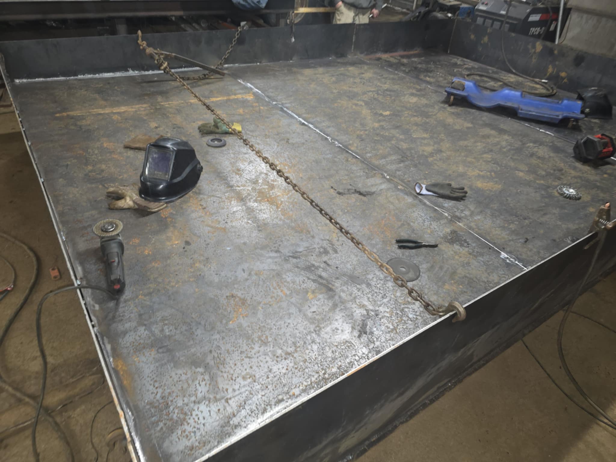

Making more progress on water table. If I was to ever building something like this again I would build a stronger support frame to on the inside and underside of the table. I kindof skimped out there and it lead to lots of steel warping and bowing. I don't think it will matter much because I am going to build slat frames that can be leveled. Hopefully it's strong enough to hold all the water and up to 1.5 inch plate. Seems to be to me.

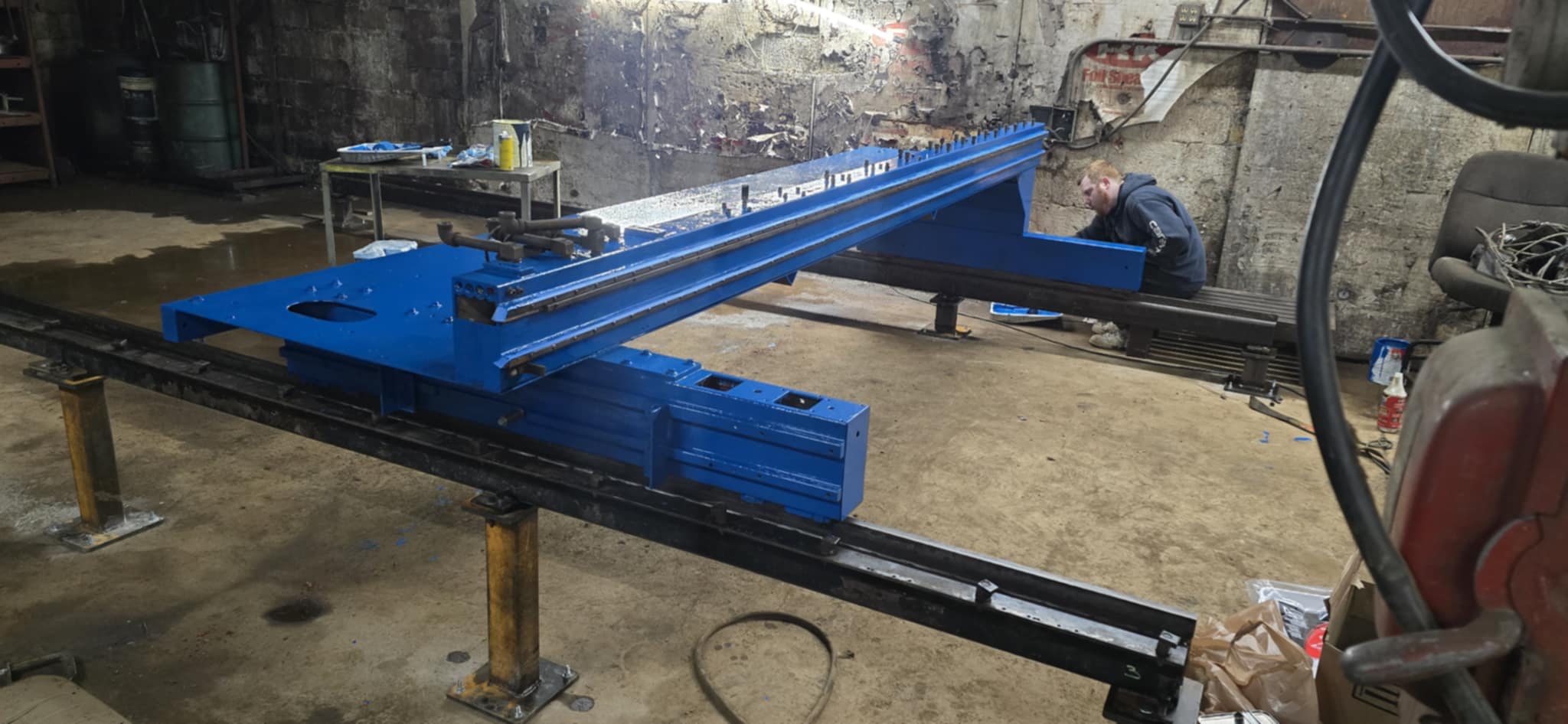

I got the gantry together was alot of work and planning to make sure it was all straight. It rolls pretty nicely you can feel the hop between rails a little but I think with the size of the machine the vibrations will smooth out. If it appears in the cut quality I will switch to linear rails. We are painting it right now looks like a brand new machine! A friend of mine may have some brushless dc motors hes getting from work for me, we will see otherwise likely going to go with china brand servo motors. Still alot of work ahead of me on this project, im hoping it will be a reliable machine cut around the clock without issues.
