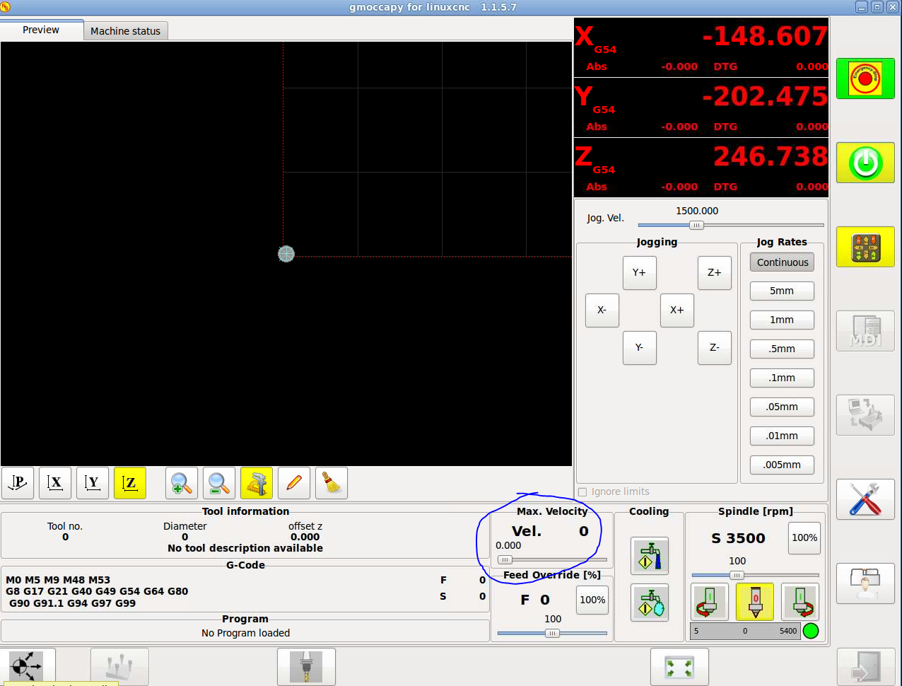

27 Jul 2014 07:09 - 27 Jul 2014 07:21 #49179 by Swapper
Replied by Swapper on topic XHC-HB04 wireless MPG pendant HAL module
Hi!
i am running with a xhc-hb04 pendant on master (2.7.0-pre0-680-gc72834b)
Its been running OK for some time but i have to be doing something wrong regarding the "Max. Velocity" together with the xhc-hb04.
When the pendant config is active the "Max. Velocity" gets put to 0 and i can't change it (slider locked).
This have happened before at times and then i messed with the pendant before starting linuxcnc and it worked.
Now i can't get it to work (after updating to above build) seems it would be possible to link some function on the pendant to the slider and set it to the DEFAULT_VELOCITY = 83.33 ini default value?
Attached is my configs if anyone have some ideas.
Greatfull for any tips.
Edit:
Seems like a race condition since it works some of the time when starting linuxcnc.
This is how its looking.
Last edit: 27 Jul 2014 07:21 by Swapper.
28 Jul 2014 22:04 #49221 by dgarrett
Replied by dgarrett on topic XHC-HB04 wireless MPG pendant HAL module
I haven't been able to reproduce the described behavior in a simulator -- If you can reproduce with a config that requires no special hardware or parport, please post a complete config.
