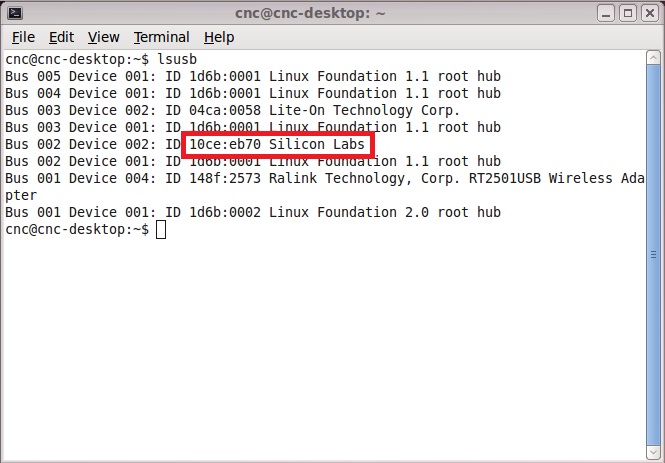

by emcocnc
Replied by emcocnc on topic XHC-HB04 wireless MPG pendant HAL module
here is the debug info.

Replied by ArcEye on topic XHC-HB04 wireless MPG pendant HAL module
It is finding the file OK.
Do you have a 4 axis mill?
One of the errors is regards a pin on axis 3 ie. A axis
Please attach the actual hal file
/usr/local/bin/xhc-hb04.hal

Replied by andypugh on topic XHC-HB04 wireless MPG pendant HAL module
It finds the XHB
It looks like perhaps the USB port or the device might be faulty. (but that is a total guess)
I am a bit worried by this too:
Which might or might not be related.
Do you have any other USB ports you can try?
xhc-hb04: waiting for XHC-HB04 device
xhc-hb04: found XHC-HB04 device
xhc-hb04: connection lost, cleaning upIt looks like perhaps the USB port or the device might be faulty. (but that is a total guess)

I missed that. Ignore my comments about USB for a while, that error might be the disconnect.
Does that pin exist at any point?
/usr/local/bin/xhc-hb04.hal:23: Pin 'axis.3.jog-enable' does not existDoes that pin exist at any point?
