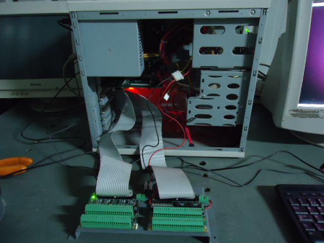

16 Feb 2013 03:33 #30143
by emcPT
Replied by emcPT on topic Current turning capabilities status
Ok, I have set a PC with a D2700 and a mesa card 5i20.
I have also run pncconfig and set up things to the best of my knowledge. I did not set up and I/O signals except the ones for the servos (X,Z,A and spindle).
I do not have any servo or any I/O signals hardwired.
Now when starting linuxcnc it will not start and the relevant (the first error) debug message is:
Can not find -sec MOT -var MOT -num 1
and a few more others, all that start with "Can not find ..."
This is probably due to a bad configuration on the pncconfig, but this is almost alien language.
My question for today would be what would be the most "clean" config that I can make just to have a spindle, because I would like to start only by having a spindle working.

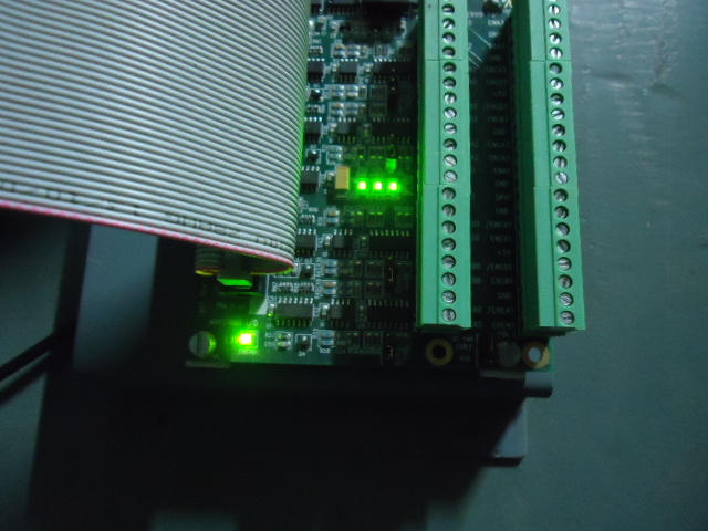

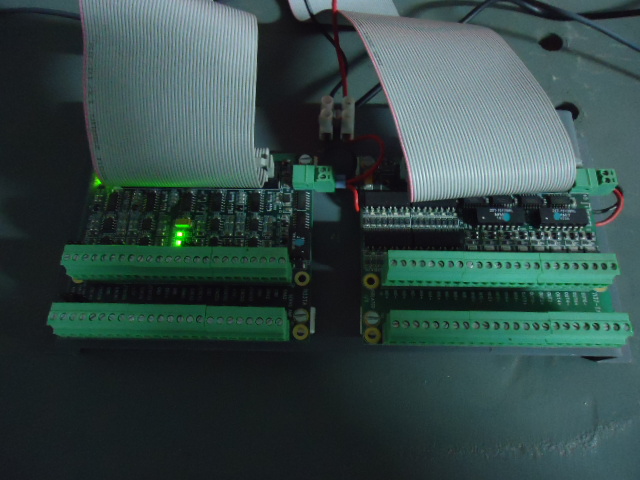

A few pictures of the mesa hardware installed are attached. There was suppose to be any leds on the 7i37 ?

- Posts: 18090
- Thank you received: 5323
16 Feb 2013 03:40 #30145
Replied by PCW on topic Current turning capabilities status
There are no LEDS on the 7I37
You will probably have to post the full error message (and maybe dmesg log) to
debug this
debug this
