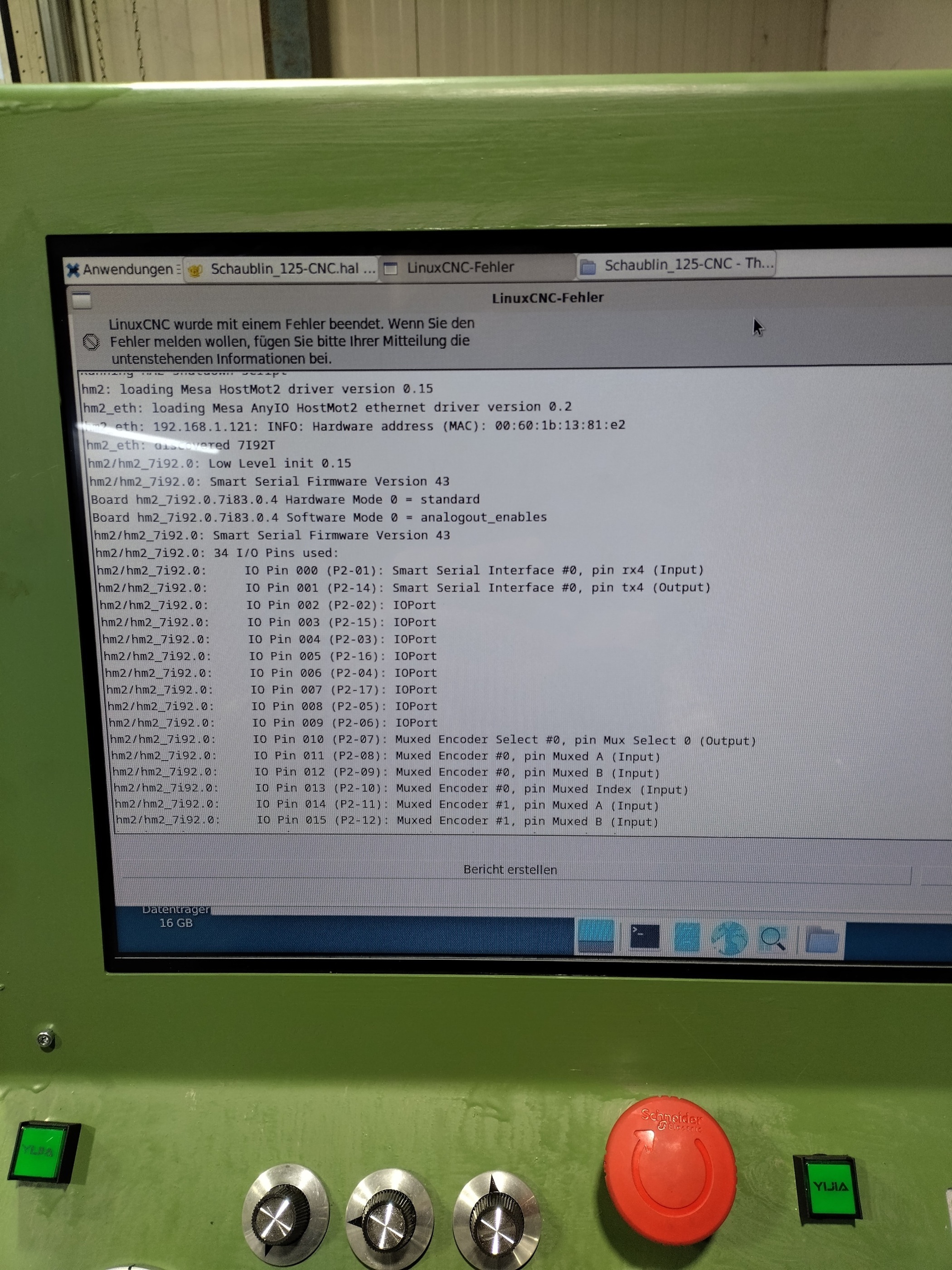

Is it possible that you have ended up with the wrong firmware flashed? I looked back and the last one I saw you mention was 7i92 plus 2x 7i85. Sounds okay, but maybe Peter can confirm that?
- Dudelbert
- Posts: 79
- Thank you received: 20
27 Feb 2026 17:40 #343618
by Dudelbert
Replied by Dudelbert on topic Considering a Full Rewire on a Working Schaublin 125 CNC
I rechecked it multiple times myself. According to --readhmid, it should be fine. In the end,
I gave up and purchased a 7i97T. That should solve all the current problems and all it cost is money
That is the card I use in my mill. It has one Smart Serial port, and I will need two (for the 7i73 and one 7i85). I plan to build this small board from Talla83 (github.com/talla83/RS422-SmartSerial-Adapter
), but for starting out, the I/O on the 7i97T itself should be sufficient to get most of the machine running.

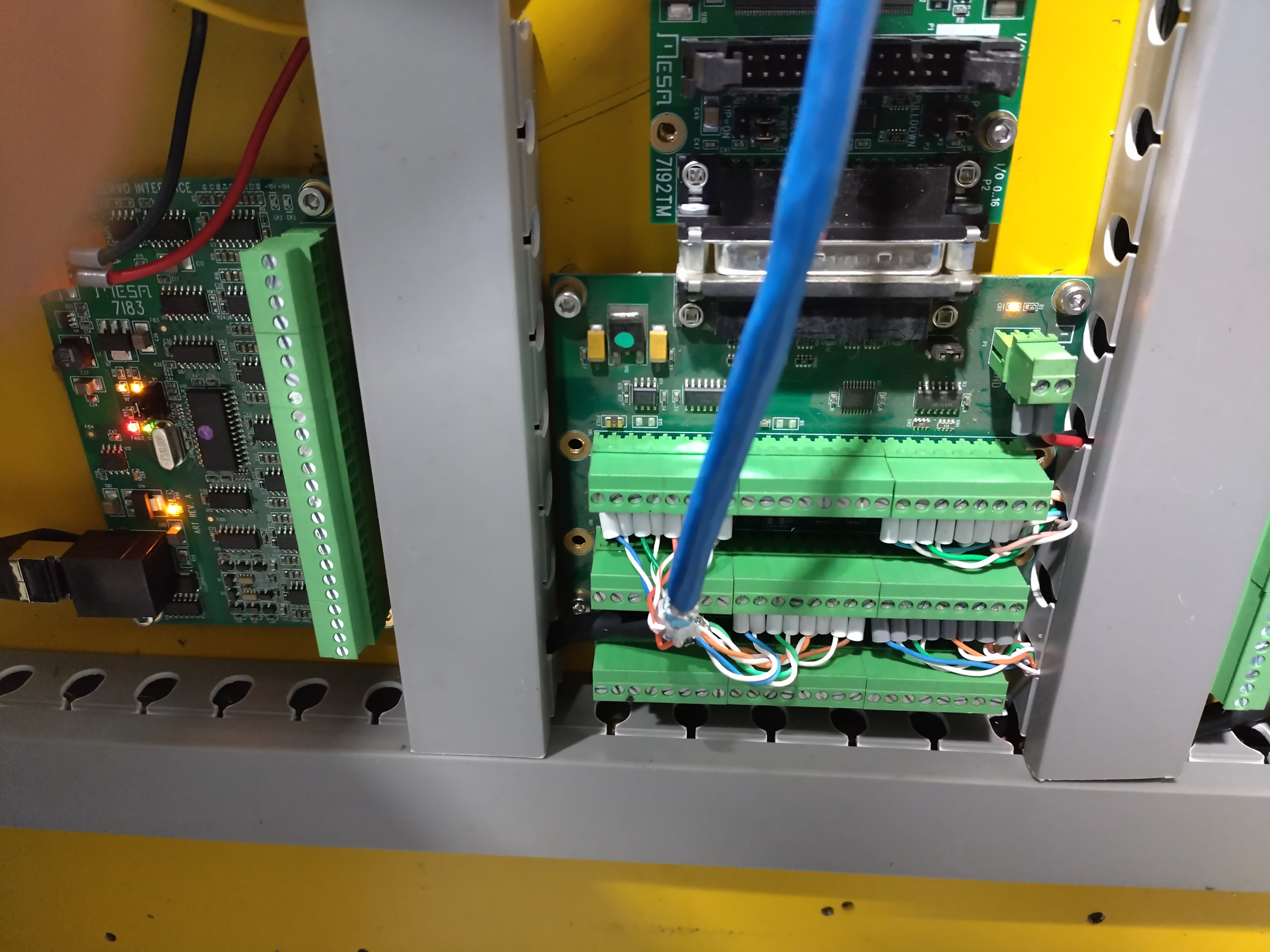

24 Mar 2026 16:03 #344676
by Dudelbert
Hi, I have a bit of an update: I have the SSboard from Talla83 assembled and running now. (Thanks Mark for sending parts for that.)
The 7i97T works fine, and the setup is much cleaner now.
I also have the control panel and all the stuff in it connected to the 7i73. It’s not really used in the HAL yet, but according to HAL Show everything seems fine. And I have a basic E-stop chain running.So I think there is not a lot stopping me from starting to connect the axis driver and spindle. So hopefully there will be some movement in the near future.
