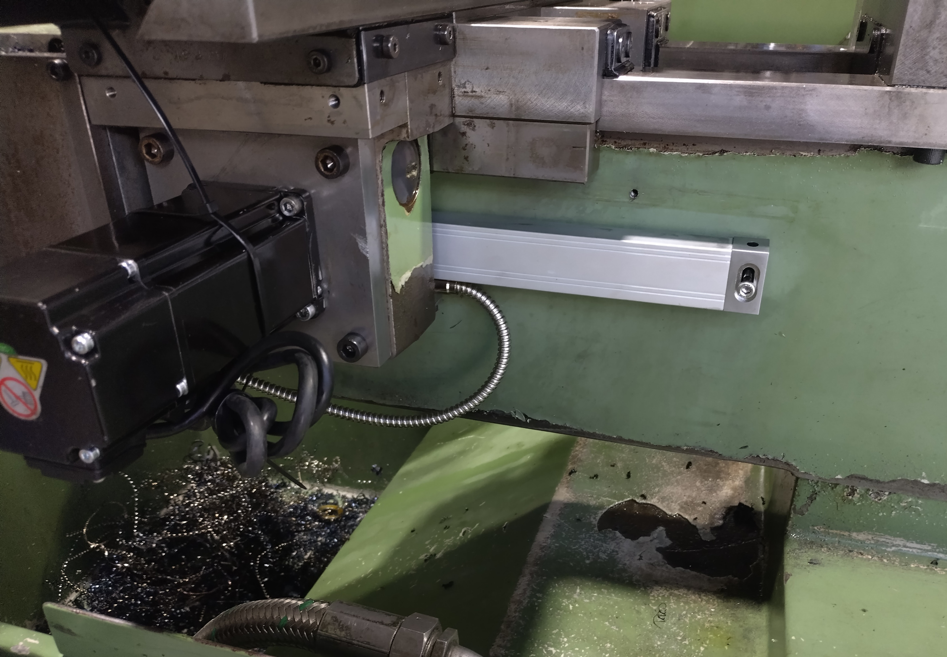

04 May 2026 07:03 #346149
by Dudelbert
Replied by Dudelbert on topic Considering a Full Rewire on a Working Schaublin 125 CNC
I don’t think it can be the Z-axis clutch, as I have a glass scale on Z.
So a slipping clutch should either be corrected or, more likely, end in a stop due to following error.
