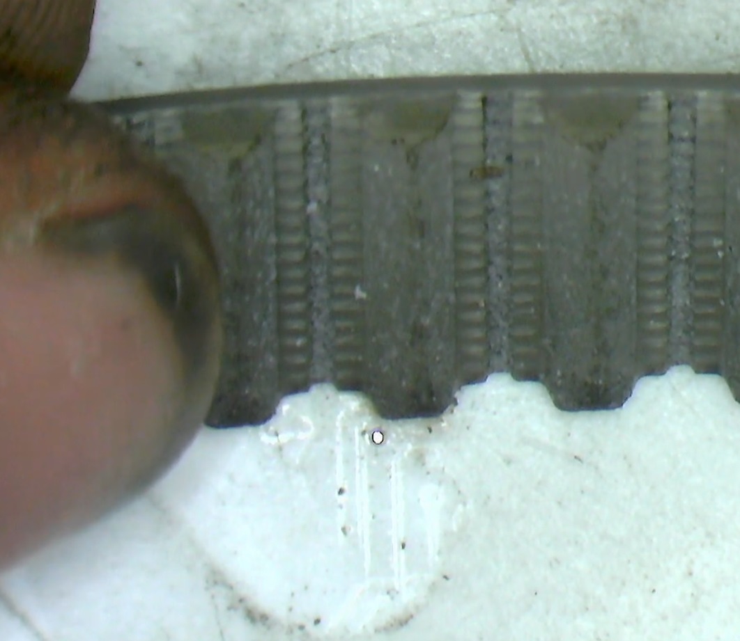

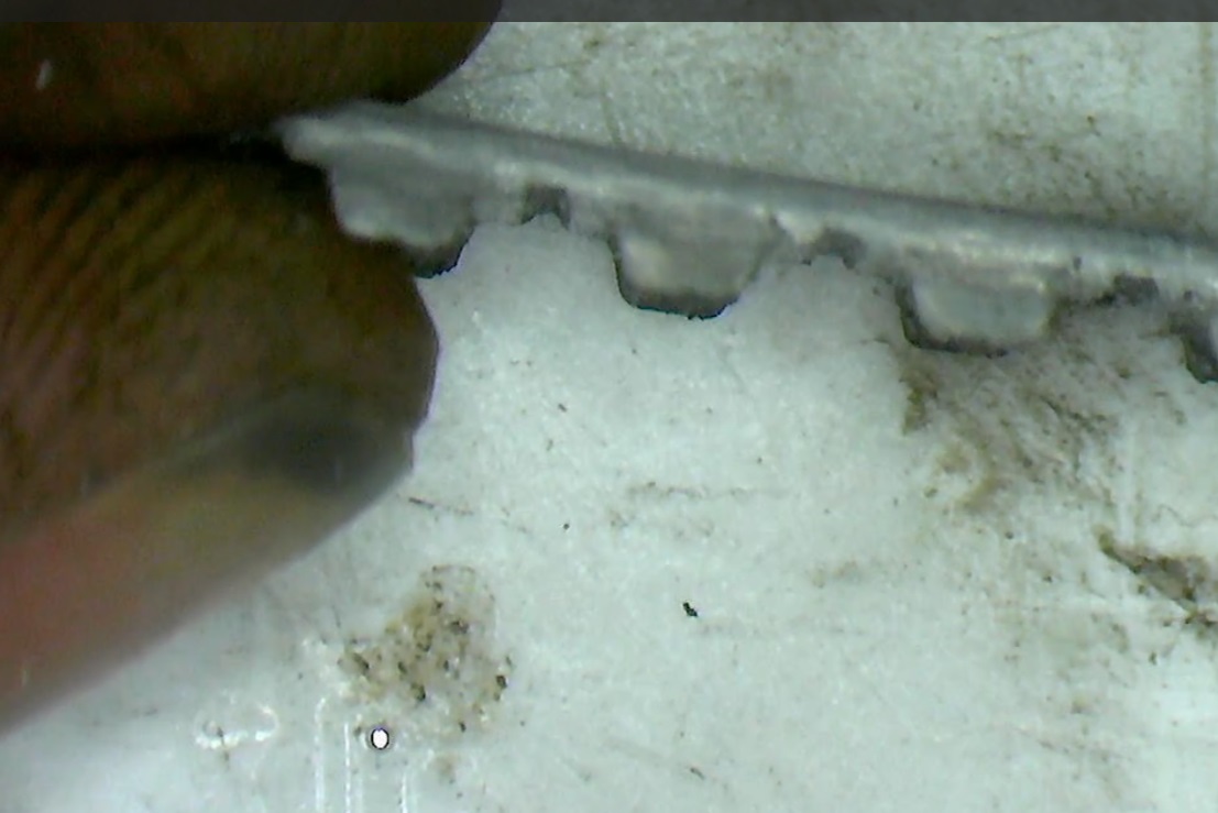

07 May 2026 15:30 - 07 May 2026 15:31 #346252
by Dudelbert
Replied by Dudelbert on topic Considering a Full Rewire on a Working Schaublin 125 CNC
I finally found the problem with the threading. Should have found it much earlier.It’s the belt.
It gets chewed up. Opening the side panel, I found belt-colored dust, but the belt still locked fine, at least from the side. Looking closer showed that the teeth are broken up from the middle outward (see picture).
I found one tooth gap with some hard thing in it, so I assume that my initial cleaning when installing the belt was not very thorough and I overlooked that.
After cleaning that out and reinstalling the already damaged belt, I could thread fine. But I think this will not last long, so I ordered new belts and will install them after VERY thoroughly cleaning both pulleys.
It’s really typical for me that the solution to a month of problems is: “You should have cleaned the thing better.”
Last edit: 07 May 2026 15:31 by Dudelbert.

07 May 2026 16:13 - 07 May 2026 16:15 #346254
by spumco
Replied by spumco on topic Considering a Full Rewire on a Working Schaublin 125 CNC
Is that supposed to be a T5 belt profile? I've never seen a timing pulley with a 'tit' on the tooth crest.
Is the tit on the pulley teeth from wear, or is it some substance that got in the belt tooth valley groove and stuck to the teeth? And that's what you're cleaning?
To clarify, here's a T5 belt profile from Misumi. I think the groove is there to help air escape at higher speeds (noise reduction).
Last edit: 07 May 2026 16:15 by spumco. Reason: Add pic

07 May 2026 16:30 #346255
by Dudelbert
The dark line in the middle of the tooth is just the last bit that still has the original surface, with a bit of dirt that makes it darker. On both sides, it is mostly obliterated. I assume that is what you mean by “tit.”
And I think the gap between the teeth is also to reduce the smallest possible bending angle, in addition to the reasons you listed.
