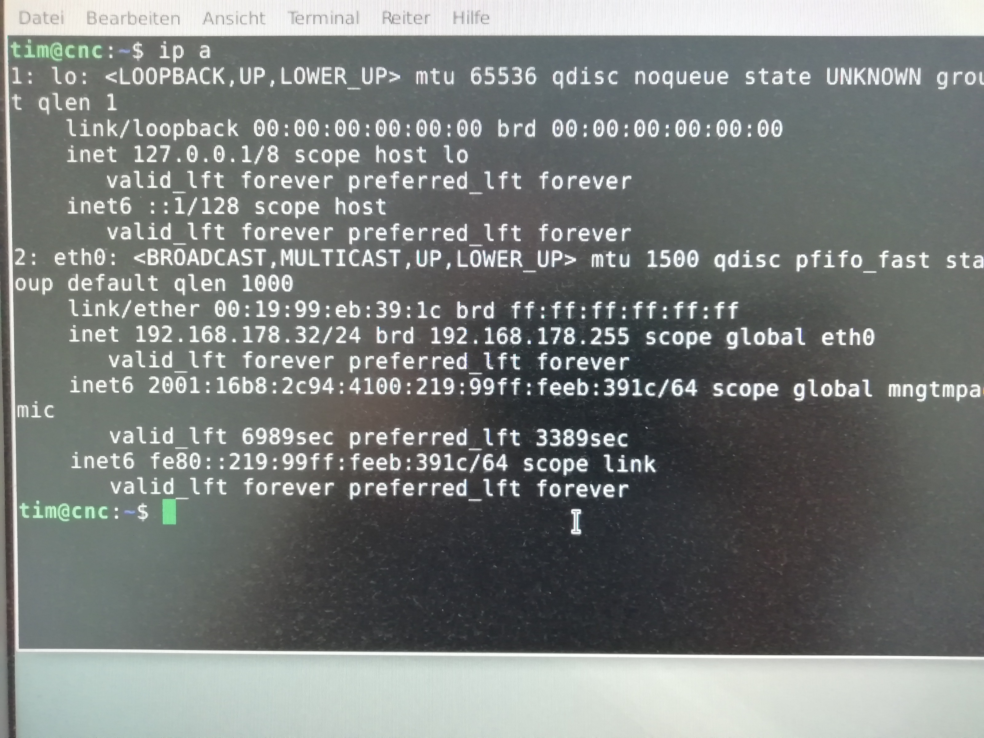

The PCs IP address is the issue, it cannot be 192.168.1.121
09 Oct 2021 14:40 #222647 by mittim
Replied by mittim on topic Mesa 7i95
So, i changed my PC address:
What´s next? Configuring a ethernet wired connection with the IP 192.168.1.121?

09 Oct 2021 14:53 #222648 by PCW
Replied by PCW on topic Mesa 7i95
That (192.168.178.32) is not a valid host IP address either with a /24 netmask
only the last digit should change so 192.168.1.100 for example.

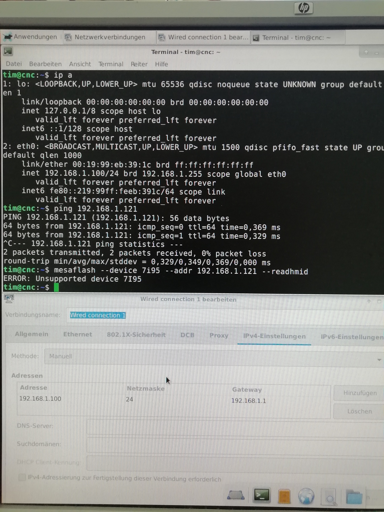

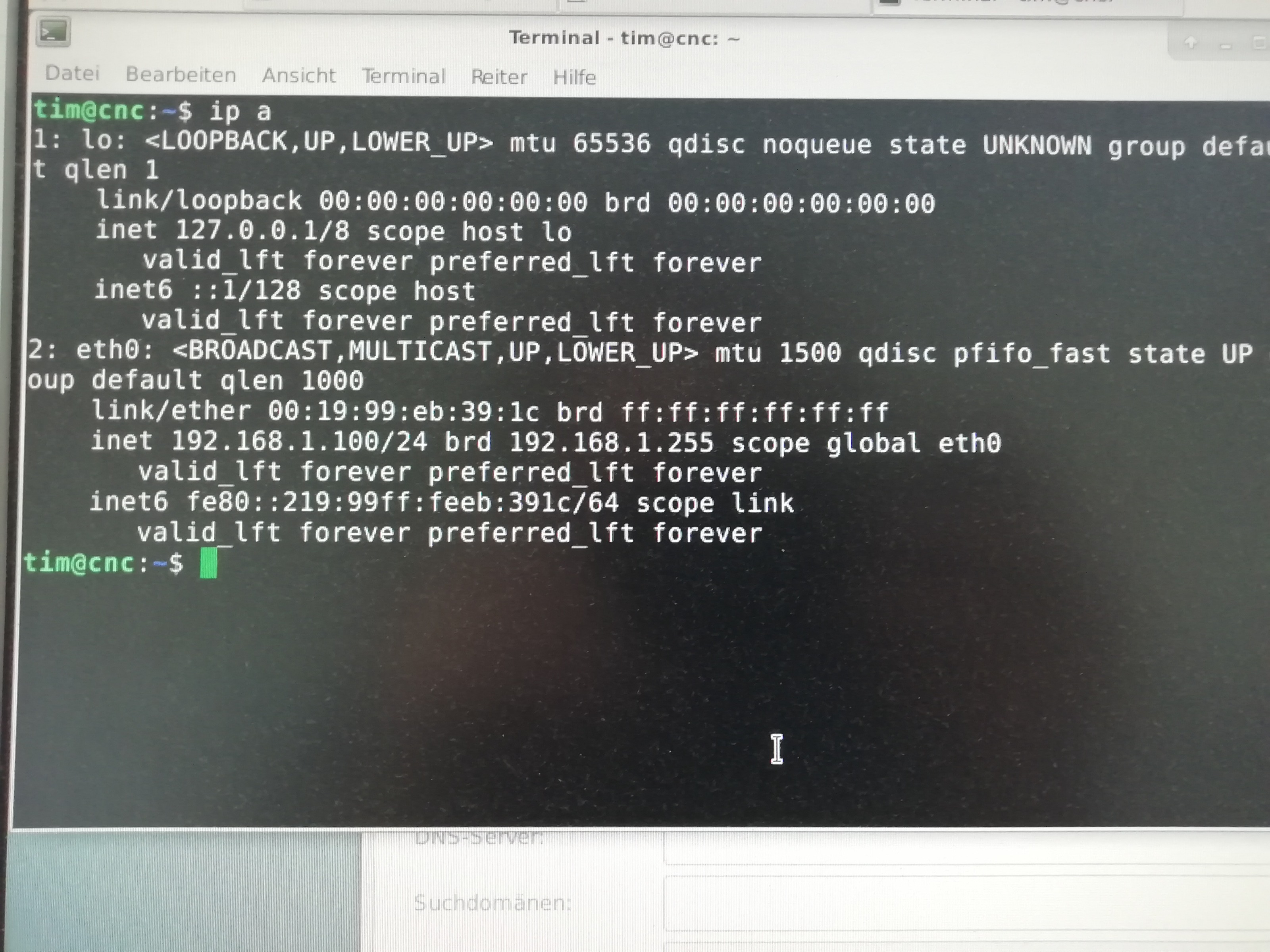

09 Oct 2021 15:07 #222649 by mittim
Is that correct now?
09 Oct 2021 15:19 #222650 by PCW
Yes that should work, also you should disable ipv6
in the network manager eth0 setup

09 Oct 2021 15:46 #222655 by PCW
What does the command
mesaflash
report?
09 Oct 2021 15:48 #222656 by mittim
mesaflash version 3.3.0
09 Oct 2021 15:51 #222657 by PCW
Ahh that's a very old version from before the 7I95 existed
the current version is here:
github.com/LinuxCNC/mesaflash

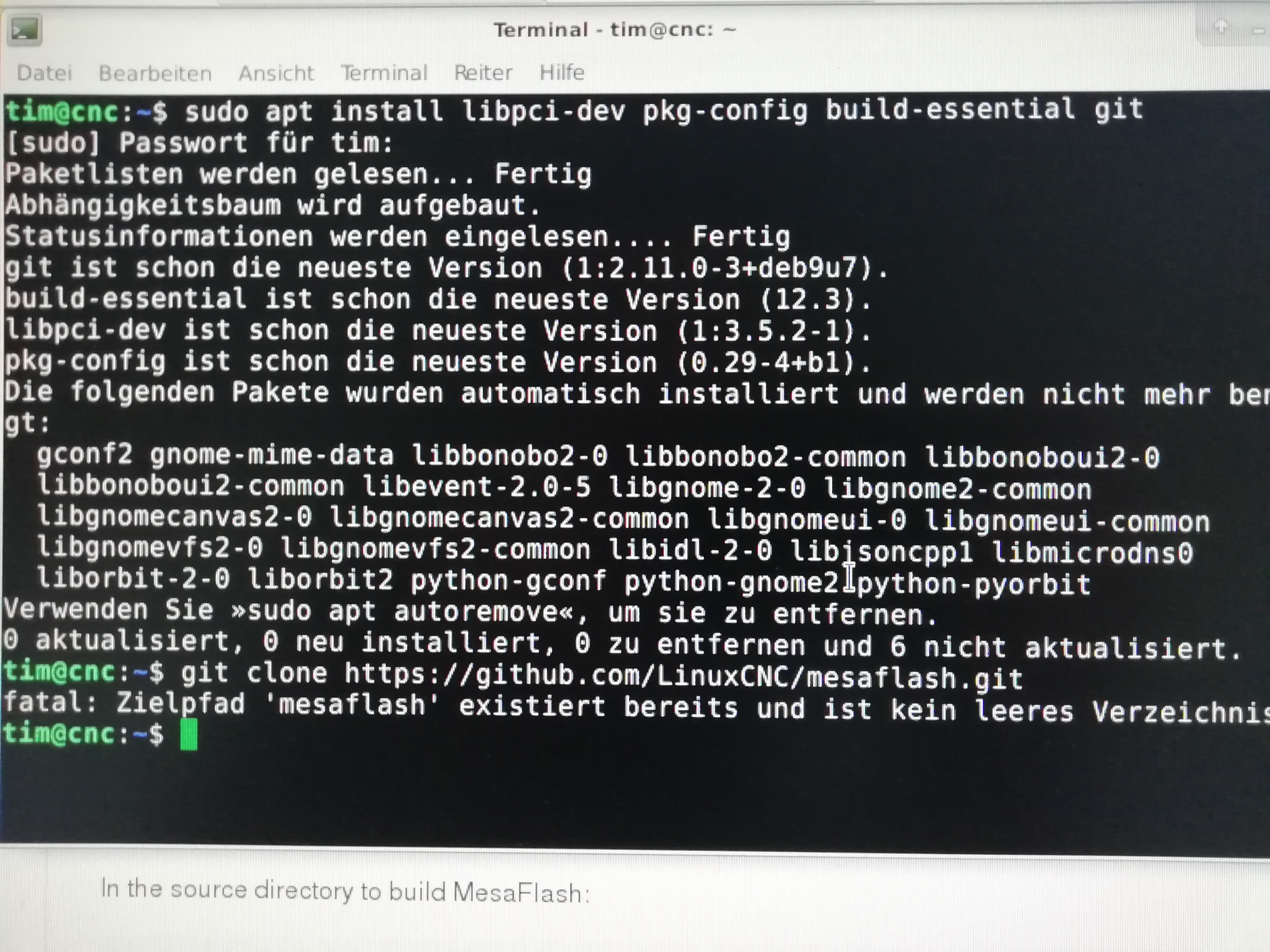

09 Oct 2021 15:59 #222658 by mittim
Maybe I skipped this part last time i was updating mesaflash, but i get an fatal error?
it says: fatal path mesaflash already existing and is not empty
