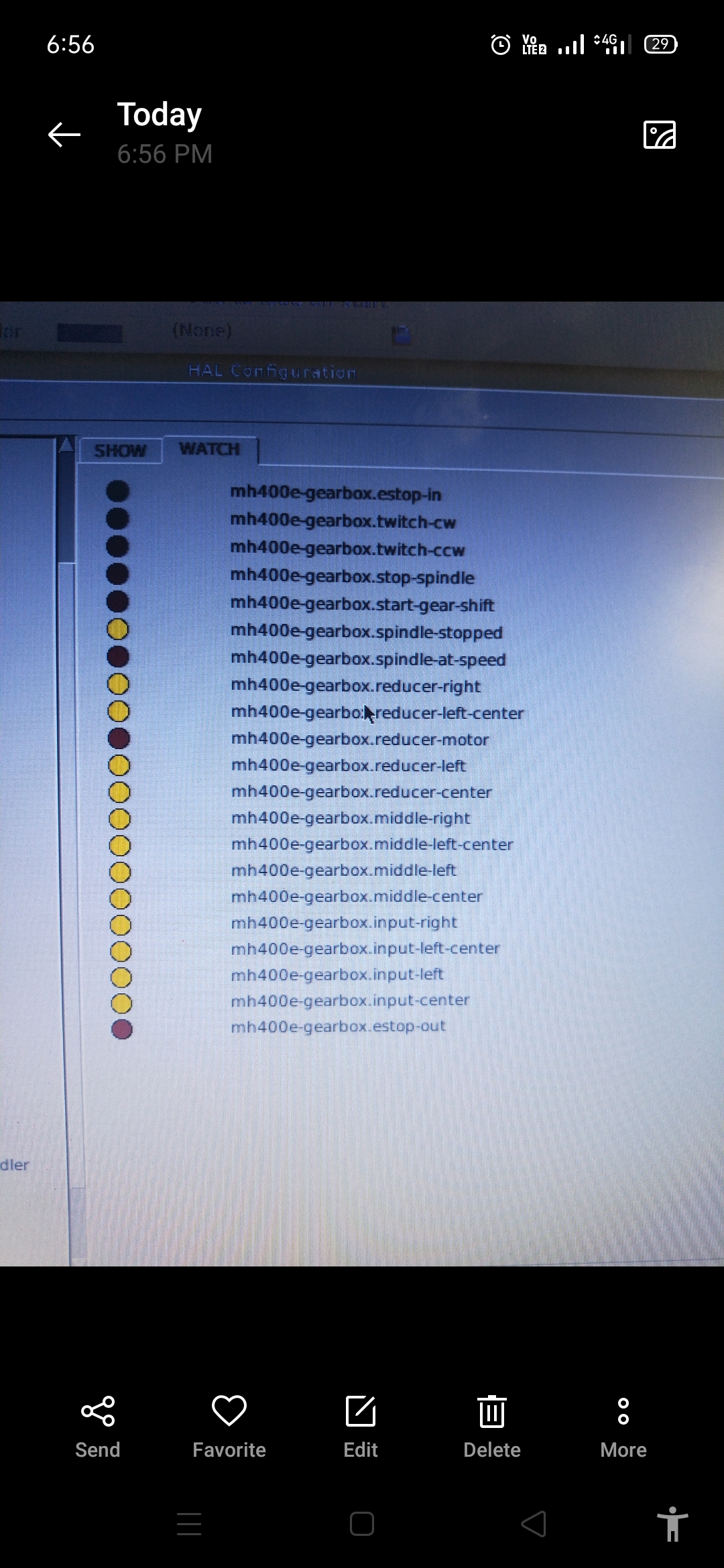

so i again compiled the component and this is the result.

so, is there anything wrong?

Looks like only warnings but no errors. So maybe try loading the component in hal and see if it works.

I loaded the component, the 19k1 relay( mahine ready) relay turns on. But i can't get any feedback from the switches when i release the e stop.

Have you checked whether the switches work in HAL Show?

No, the hal show shows no change when i press any of the switches. I have power at points 200 and 202.and the switches are working and providing signal to relay board. How can i fix this?

Do the HAL pins show up?

They do show on hal configuration tab. I can see other estop, spindle stop pin states changing on 7i84. Just these switches aren't working. I tried giving them 24v from the board itself. But they don't change their states.

Did you adapt the relay panel ribbon cable wiring for your machine? When I compare your wiring diagram to mine, the signals run through different terminals, and wires on the ribbon cables.
Mine...
https://camo.githubusercontent.com/da505bb6386effdead3dbd1728afaa775944e80b0353aeda0fc72dd6c87bf4ce/68747470733a2f2f666f72756d2e6c696e7578636e632e6f72672f6d656469612f6b756e656e612f6174746163686d656e74732f323931372f4d41484f3430304547656172626f78666565646261636b73776974636865732e676966
Yours:
So if we compare, the ribbon cable wire 28X2-11 on my 400E carries the signal "Backgear Left end stop", whereas on yours it carries the signal "Backgear Right end stop".
However, even if wired wrong, if you open the Hal Show second tab, to watch the state, at least the lines used by both our machine (28X2-11 through 28x2-18 should shange state when manual pushed, even if not the correct assignments.
On my Maho, these switches are on the terminal 200 24VDC bus, which is only powered when out of E-Stop, so you will need to be latched on to do this testing.
Mine...
Yours:

I changed the wire terminals and this is now exactly the same as yours. I checked and confirmed the terminals via multimeter. And my 200 is wired out of estop loop right now and is powered up directly via the main smps(4.5amp). 7i84 and 7i77 both are powered via this smps.Also i tried giving 24v directly to TB2-2 estop input. Still couldn't get anything.
