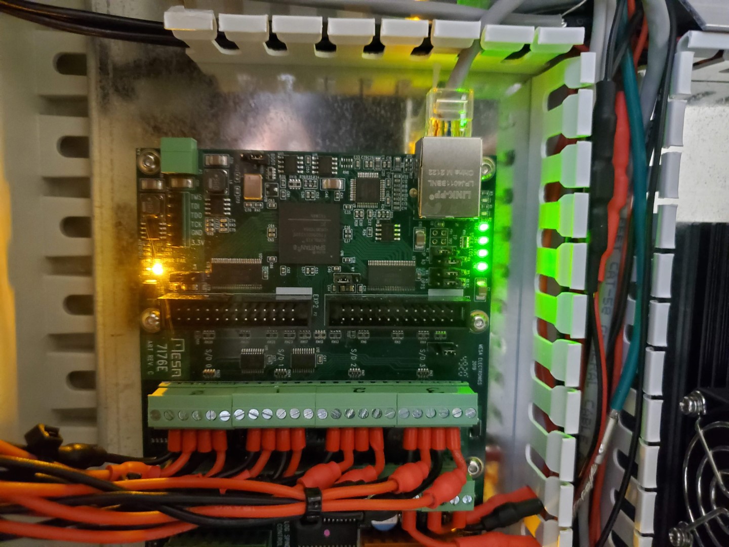

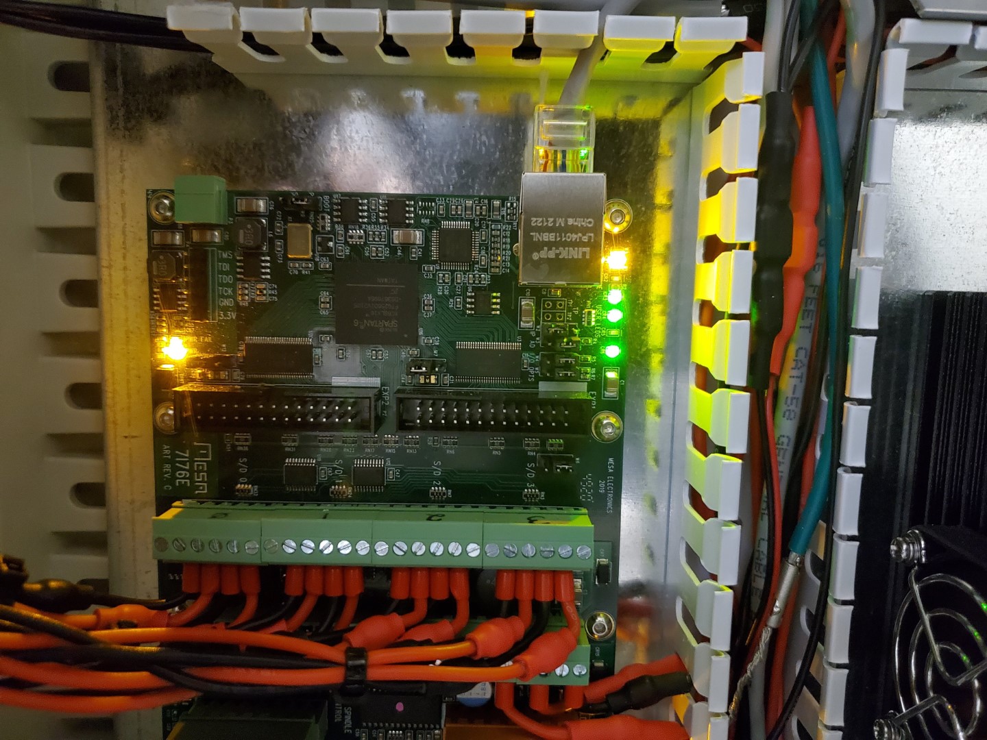

I noticed the lights on my Mesa board change when the motor stops functioning.
The first pic is while the motor is working.
This pic is after the motor stops and will not start again.
22 Feb 2023 01:11 #264999 by PCW
That light indicates a watchdog bite
Are you running LinuxCNC when this happens?

22 Feb 2023 04:30 #265009 by PCW
Yes, it indicates a real time issue. (though I would expect an error message from LinuxCNC)
What hardware do you have and what servo thread rate?

22 Feb 2023 17:41 #265045 by Sray69
For those that may not have seen my other post about this issue here is what I experienced when setting up my config files in PncConf.
Sometimes when I go into the Test/Tune Axis screens (in PncConf) I can get the axis to move using the +/- buttons on the Tune window. Other times the motor will not do anything. Even if I close the test windows and then go back in they will not work. Sometimes if I go back to the Mesa Card Configuration Page and "Accept Component Changes" and then go into the Test screens it may work or may not. Sometimes when I press the Run button it will cycle back and forth non-stop and other times it will just stop after a couple cycles and I cannot get it to start again. Very inconsistent.
When the drives would stop working I noticed the amber light was on (as shown above).
I was advised to just save the config and open it in LCNC and go to Machine>Calibration and fine tune my settings. Then click "Test", then "OK", then "Save to File"
When I say it happens in LCNC as well, I mean while testing the ini/hal files that pncconf created. As suggested I loaded the config in LCNC and then went to Machine>Calibration and then I clicked "Test". I could not get any axis to move at all in LCNC. Then I noticed the amber light was on just as in PncConf when the drives would stop working.
22 Feb 2023 18:29 #265050 by PCW
This error is unrelated to stepper tuning.
The /INIT light being illuminated while LinuxCNC is running
indicates a watchdog bite which in turn means that the host
computer has lost contact with the 7I76E.
The most likely cause is real time issues on the host computer,
which is why I asked what the host computer hardware was, what the servo
thread rate was and what OS was used.
